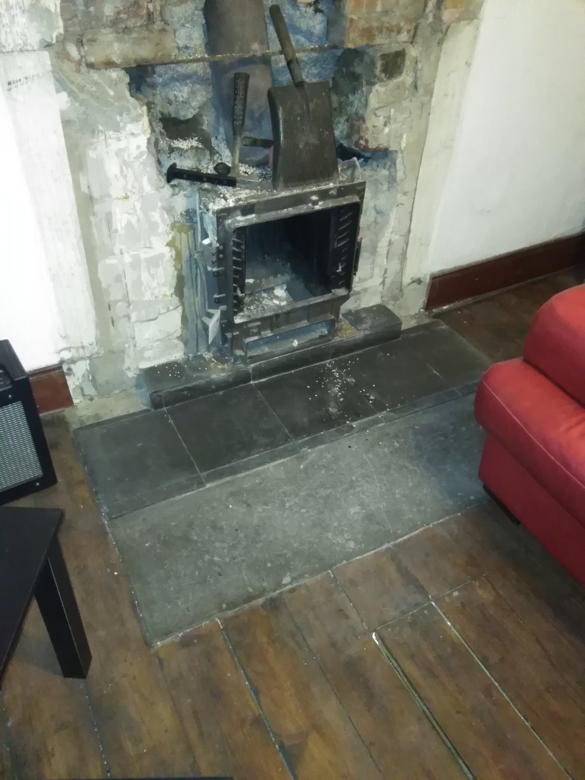

Have you thought about doing this yourself. Post a picture of the opening if you want.
Excuse the gash picture as I've just taken it on my tablet. The red line is what I've just drawn with a marker. It represents where the original stone lintel is. It's roughly 5ft 5inch high.
Utter pig of a job taking this out. Boiler stove which has been built in well, but the flue was installed wrong.
Well it looks as though you've got a hearth of sorts, and if you can sort out that fireplace, then you can put in a better hearth. You can get a green oak sleeper for about £30, and that'll make your beam. Annd what's the inglenook board and plastering.
Original hearth laid in place of floor boards. 3ft from wall, 4ft wide. Unsure how far back it goes but I'll guess all the way. Tiling on top, then built up again for the stove to sit on.

Will do bud. The whole wall is getting stripped back to the original on Tuesday. I dread to think of what it'll be like. Pictures will follow!
