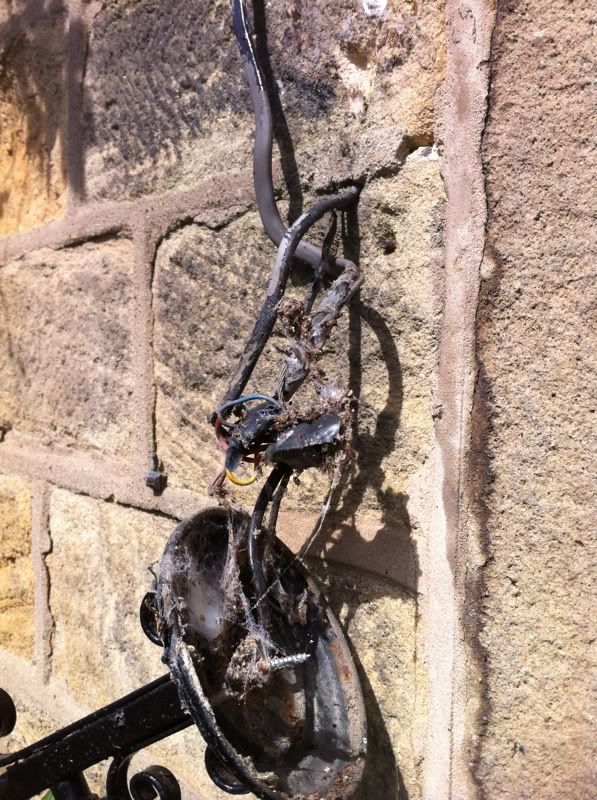

I went back last Wednesday morning to do some more investigation and found the IR for the suspect lighting circuit had risen from 9MΩ on my first visit to about 300MΩ on Wednesday which suggests to me something had dried out.
Anyway, seems I didn't quite test the outside light properly first time around. The light has a SL&N from an unknown junction box, but has had a photocell added to it afterwards.
I stripped the photocell and IR'ed the light from there, but who ever installed this has cut the CPC for the photocell at the light, hence no bad reading.
Also as this is supplied from a class 2 circuit the original installers have borrowed an earth from somewhere to supply the light.
Here it is:
Anyway I bunged it all up with mastic compound as a temporary measure and so far, touch wood it hasn't tripped since, despite 2 days of heavy rain on Fri / Sat.
This is going to be rewired properly as part of some other scheduled work in a few weeks. Might even get the pyro out :D

Turns out the outside light was also a red herring as the RCD has again tripped a few times since I gummed it up.
I think I've cracked it this time.
Found this in the loft connected to the circuit which showed low IR
Mmmm yummy ELV transformer :eek:
