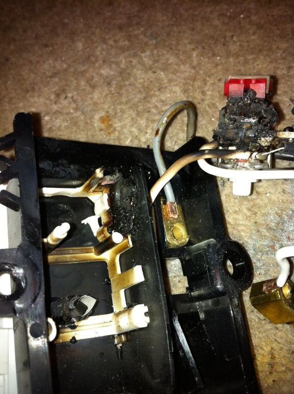

Got called out to a friends house last Tuesday around lunch time.
The circuit breaker for the sockets had tripped and would not reset. 30A plug in MCB in an old wylex CU.
I got there and tried to reset the circuit breaker. It went with a real pop. A quick IR test of the circuit showed it was a dead short L>E.
I spent a couple of hours breaking the circuit down and found where the fault was.
Here's the odd bit.
Fault was in an attic conversion. Wiring up there is about 4 years old. There is a spur somewhere from the RFC, presumably via an inaccessible junction box. This enters the attic straight into an RCD FCU, then supplies the lights and sockets from here.
The FCU had not tripped, and the 13A was still intact.
I disconnected the faulty part of the attic radial, and IR showed about 40MΩ. I was happy enough with this. Powered back up no problems. Assuming the FCU hadn't tripped as it was faulty, did an RCD test, and it tripped out perfectly. About 40ms and 19ms.
Fast forward to friday night. Got a call at about 8pm, and got there for about 10. Circuit had tripped and wouldn't reset again. It was another L>E dead short. Went straight to the attic and and another part of the radial had gone down. Disconnected this too, and IR showed 40MΩ again.
Powered up and left.
Got a call 30 mins later to say the FCU was growling and then set on fire :shock:
Found this:
God knows whats been going on. I think I could be there a while sorting everything out :x
What sort of load was being used prior to all the problems , would it have been in excess of the 13 amp rating.
I will asume your insulation tests wernt via the rcd :)
Ive had a couple of there rcd sockets blow up internally just by operating one of the buttons which was a bit scary
I was going to say the same - You didn't meggar it did ya?
I too have had one of these go with a bang at the press of it's integral switch. Nasty. (Not as bad as the main RCD which went pop when I turned it on, blowing the main DNO fuse!).
All that was running through it was your typical teenagers bedroom laoding. TV, xbox, etc. and a couple of lights via a 3A FCU. No heating or heavy loads.
It was meggered L&N>E at 250V as the very first test before I started removing everything off the circuit, but I would hope it could cope with that.
I've had an RCBO go bang when pressing the test button. Scared the crap out of me :lol:
Should have been fine at 250v I guess, although perhaps DC can upset them? They make a big deal over not IR testing them.
I don't think it was the IR testing. It operated fine for 3 days after the IR test.
I'll be getting rid of the FCUs arrangement when I go back to sort out the initial fault anyway.
I've heard an RCD FCU make a most unusual noise and blow when the load and supply get cross connected.
