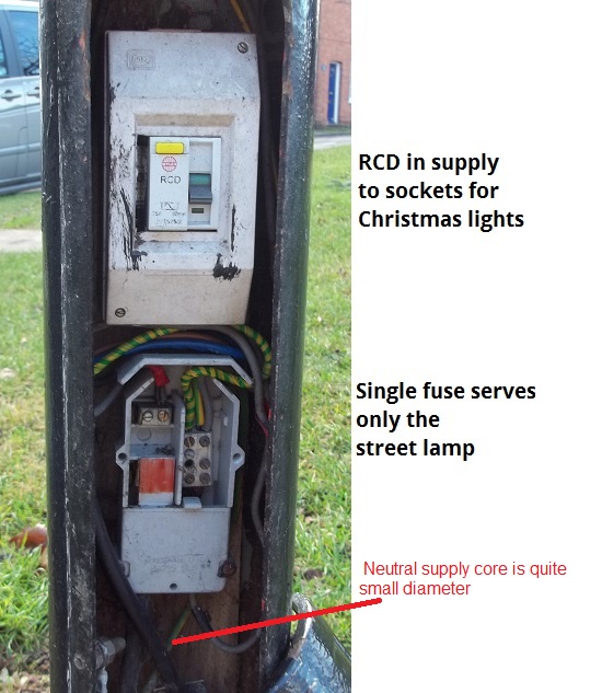

Out in the country the feed cables to lamp posts are very small diameter, protected from overload by the 6 amp fuse. A fault in the cable would be "protected" by the 200 amp breaker in the substation. No way that cable could safely handle a 4kW load.

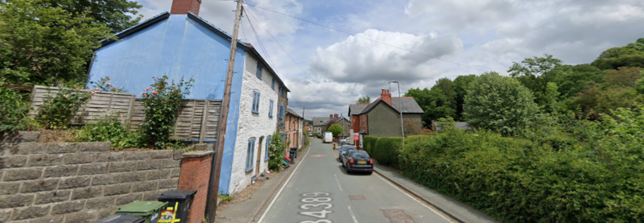

In some parts of the country, there are still countless houses whose front doors open, literally or almost, onto the pavement. One of my daughters' house, in a small rural village, has a front garden, but less than 1 metre 'long' - and I don't think they make cars that small :)
Below is the aforementioned daughter's 'cottage' (the one in the middle with an 'overgrown' front door!), in a neighbouring village to mine. It's 'Listed', but for no really good reason other than that it was built in the 1700s - most of the other properties in the terrace have been 'de-Listed' by request of their occupants! Given the satellite dishes that can be seen, the Listed Building folk don't seem too strict around there!
As you can see, there's just about enough room for an (eyesore!) 'wheely bin' between the houses and their 'front walls.
Even if it were 'legal'/'allowed' driving a car onto that 'grass verge' would be impossible. It's not at all obvious from the photo, but that verge is very 'steep', the pavement in front of the houses being at least 2 metres above road level. People have, however, been known to drive cars up onto the 'elevated pavement' (up the slope that can be seen on the left of the pic)!!
Kind Regards, John
This
is typical in Mid Wales, parking is already a problem, and there are moves to paint yellow lines, hard enough finding space for the waste collection bins, EV cars are a non starter.
