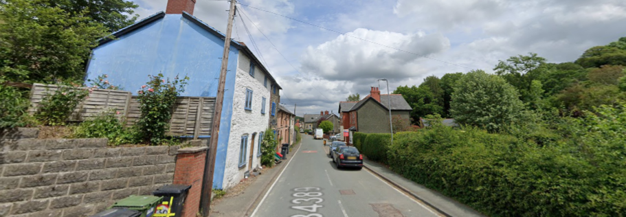

Yes. My looped supply comment was directed at the use of street lighting as possible charge points. I expect that the vision might be for a charge point from every lamp post, but that isnt going to be practical with the existing cabling being several lamp posts on a single radial circuit. Truly a looped supply!

I can see in flat areas where the roads as straight the position of the street lamp could be used as a charging point, but here the area is not flat, so the streets wind up the hills to allow a reasonable gradient, and street lamps are positioned on the bends to light as much area of path and road as they can, so to park at a street lamp is often dangerous, as it is people have utilised their garages for other things, be it a room or simply storage, and around here the drives are so steep, which is likely why garages not used as would likely not be able to safely use in the winter, even the drive ways are no longer usable for parking.
Walking to the post box, most of the way I have to walk on the road, as cars are on the walkway, road too narrow for cars to pass each other even when walkway used, and on the estate speed is low, so no one is really worried about the parked cars, but clearly no authority could condone the parking of the cars on the walkway.
So to be able to charge cars, we would need some official car park, and although walking 500 yards on the flat is OK, on these hills no one wants to carry their shopping that sort of distance from the car.
There is land which could be used for car parking, but at what cost? Looking at health and safety the best place to park a car to be charged is where no one walks, other than to and from the car, but that means long supply cables, so charging points tend to be places near the buildings.
