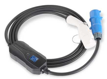

But it seems it is the registering with the billing agent which causes the most problems, charging at home can be a simple commando socket 1663426496238.pngOK £155 which is not cheap, but be it a welding set or EV both can use a standard 32 amp socket in the garage, the person fitting the socket may not know it is going to be used to charge an EV, and if I took power to a garage today I would consider fitting a 32 amp commando socket, plus it means the charger is not linked to DNO and they can't remotely turn it off.
I can't see anyone driving their car down our shared drive with 3 other homes, to try plugging into my power socket. But on the street some method of stopping the unauthorised from using the supply is required.
