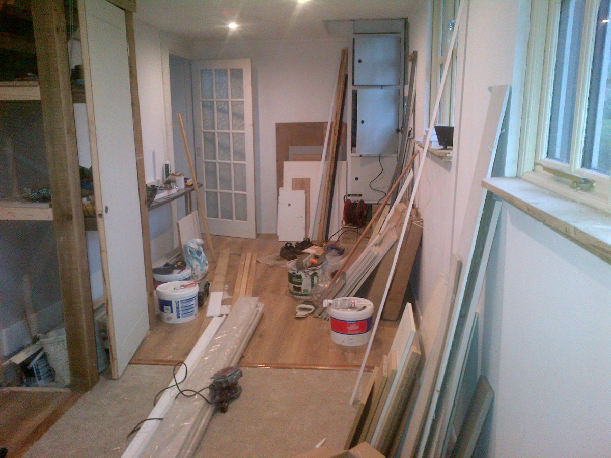

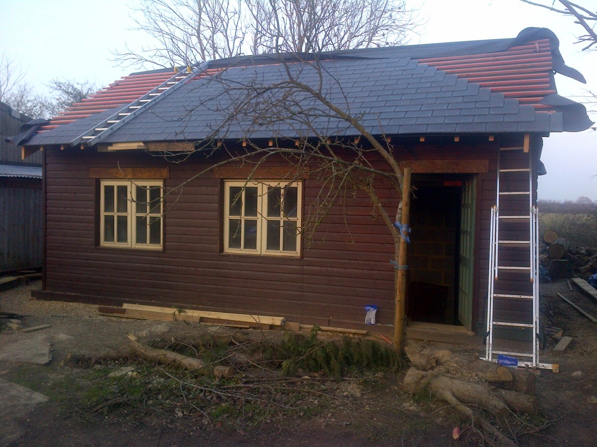

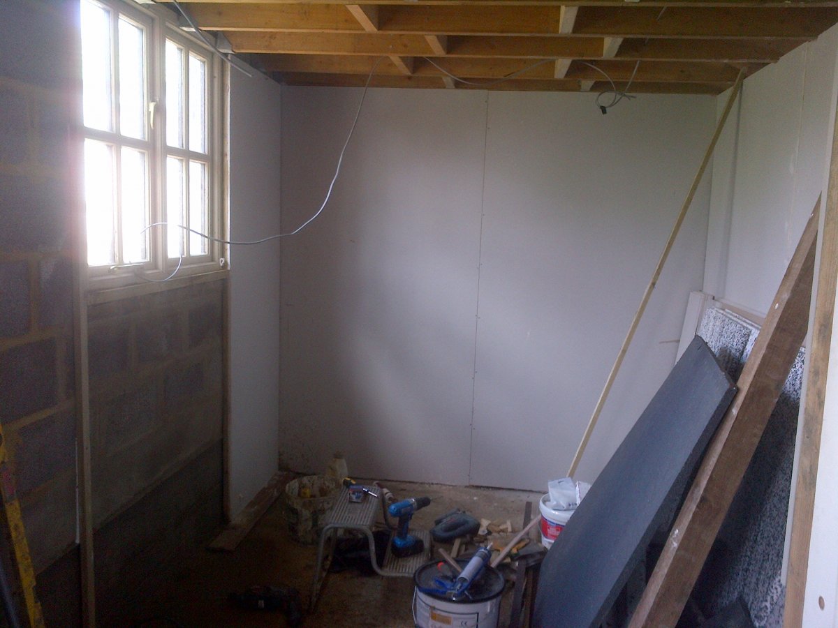

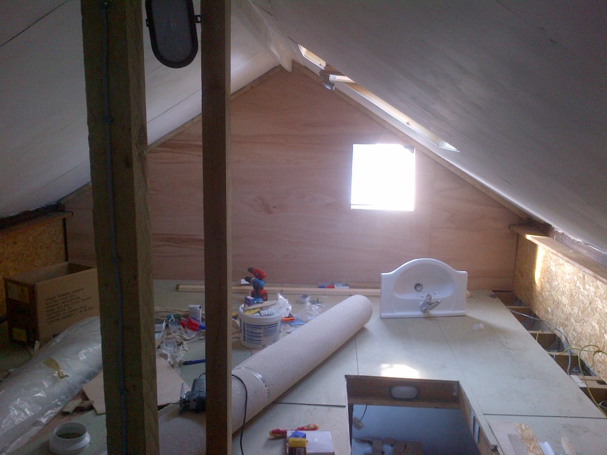

I have attached a few random pics from what I had available on this pc. As you can see the joists start 1.8metres up the wall so although the wall is 2.5metres it is supported 1.8m up. Another person I spoke to mentioned wind also. I was building it during last winter and we had some pretty hectic weather which it seems to have survived through but maybe I was just lucky. Do you think the fence post method would work based on the pics?

You wont need piers for a building of that size. Its all braced from the corners as your builder says, plus the internal walls plus the roof.
Suitable roof construction would be a more significant factor than the wall construction.

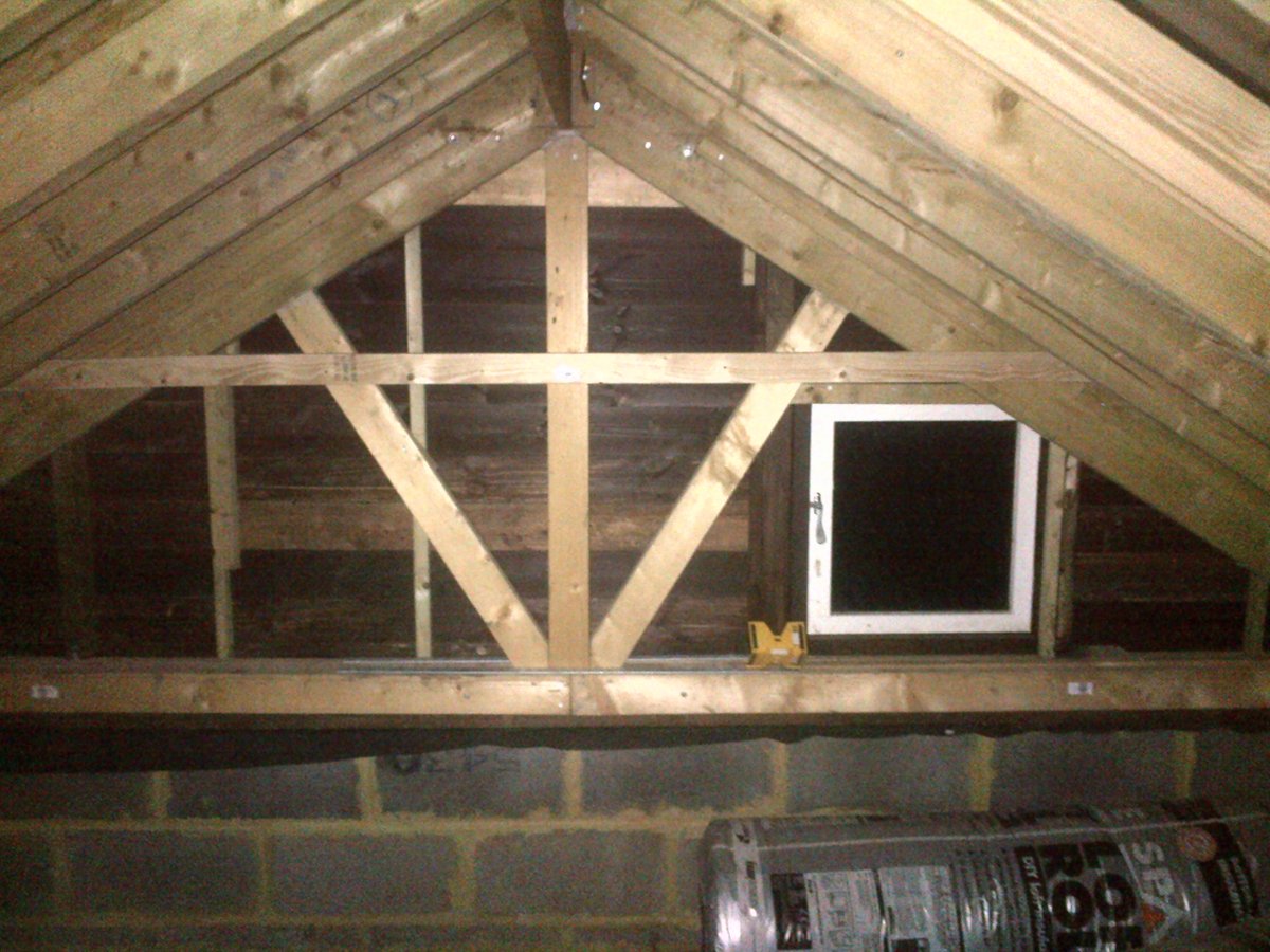

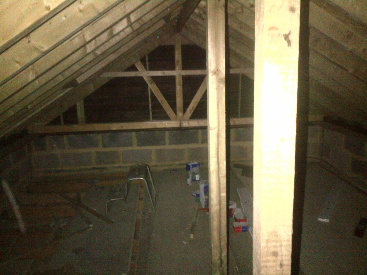

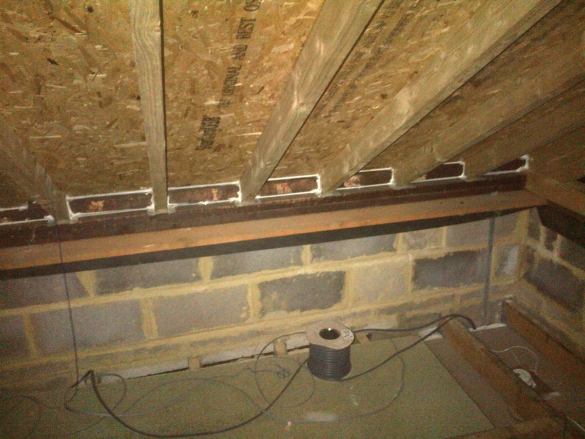

Thanks for the reply woody, that certainly puts my mind at rest. The thing about piers every 3metres still makes me want to put a fence post on the inside middle of the 7metre walls. Ive attached some piccys of the roof

I don't know much about roofs, but I can't see what prevents your pitched roof from spreading and pushing the tops of the walls off.
If that floor is well-fixed to the long wall and the 4m-end walls, you should be OK for wind load, as the floor acts as a rigid plate and transfers load to the end walls.
Are you in Scotland, by chance?
Yep the floor joists are fixed into the wall using mortar joist hangers, noggins between the joists also. The roof uses an attic style truss each end with 2 extra supporting posts in the middle. The wall plate is bolted down to the wall also. The tiles are lightweight plastic to minimise the weight of the roof. The floor isnt fixed to the 4 metre walls but a partition wall within the building is tied into one of the 4m walls, the other end of this wall has a lintel for a doorway tieing it into the other 4m wall. Imagine the building having 2 long rooms, one that is 2.4m wide and 7metres long. The other being 1.5metres wide and 7metres long.
