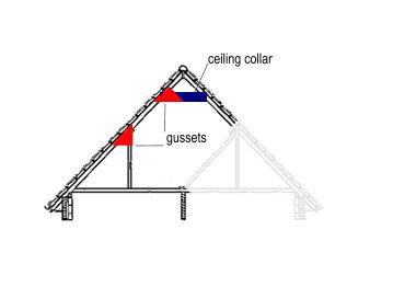

OK, so you need to temporarily brace the rafters to allow purlin removal and space to erect the stub walls which will replace them!
Could the stub walls be erected below the purlins, the purlins cut out in smaller sections and the beefed up timbers applied under the rafters progressively?...pinenot
Ok so you suggest building new wall, then cut out a section of the purlin them put in the new timbers and carry on abit at a time.
Sounds good to me :)
Thank you
Yes, but I think I should expand that advice a bit more.
Replacing purlins with a dwarf wall is not the full picture, either the purlins will be built into the gable walls and will be of sufficient girth to support the purlins un-braced, or as is more common, braces between the base of the purlins will transfer the load to a load bearing wall.
To provide sufficient load bearing properties, the stub wall should be fixed to the rafters via gusset plates glued and screwed. These will mimic the developed shape of the crux formed between the pitch of the rafters and the vertical suds of the stub wall.
Also ceiling collars, with gussets should be fitted at ceiling height...pinenot
