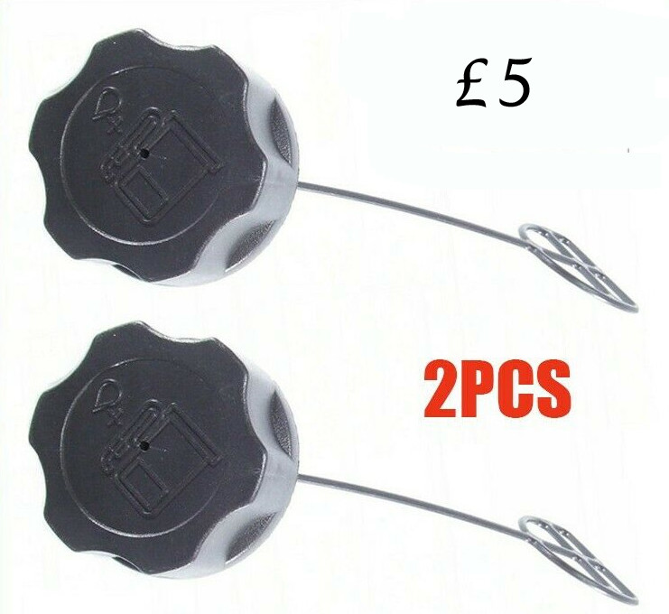

From underside the cap i pused using a small screwdriver & out popped a rubber thing & something that looks like a cigarette filter.
The cigarette filter is quite hard,clean underneath & dirty to the outside.
The rubber thing has a 2mm hole etc passing through it to then the section where the rubber actually touches itself creating a closed seal.
The way it is fitted & i have 2 of these & both the same i dont see how when the tank vapour locks this seal opens.
I say that as looking at it i would say its a one way thing.If i was to fit it the other way then the pressure would go up the 2mm hole then this currently rubber closed seal would be forced open to release it.
The way it is how does this even open under pressure i mean i dont see how its even possible.
Should i be looking for a different type of valve to fit in the cap or please advise.
Also remember both the cigarette filters are hard & not spongy
Should i invest in these as i see a hole in the top.
What do you think ??
The idea is it doesn't release under pressure, it releases under vacuum. As you consume fuel from the tank, air has to be able to get in, or you get a vacuum which will prevent fuel flowing to the carb., as you have found.
Ah right i now understand,hence why that seal is fitted the way it does.
So should i purchase the 2 caps as shown above as these obviously arent working
For a fiver it's worth a go so long as they don't allow your fuel to spill through or allow it to evaporate.
