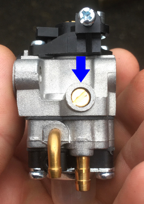

With regards mine in respect of jets I have a threaded screw which is pointed at the end. I use this when revs are full and turn it left / right etc.

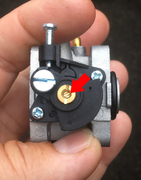

I believe there is also a screw at the top which passes down through the part you can see rotate through the Venturi when the throttle lever is operated.
So I’m my case 2 ?
I’ve only touched what i would call the mixture screw.

Please see photos of my screws.
The blue screw is what i adjust when throttle held down.
The red screw ive never touched.
This i assume must be the part that allows fuel in at start up ?
Please advise what i need to do in order to check it or adjust it so my starting issues can be resolved.
