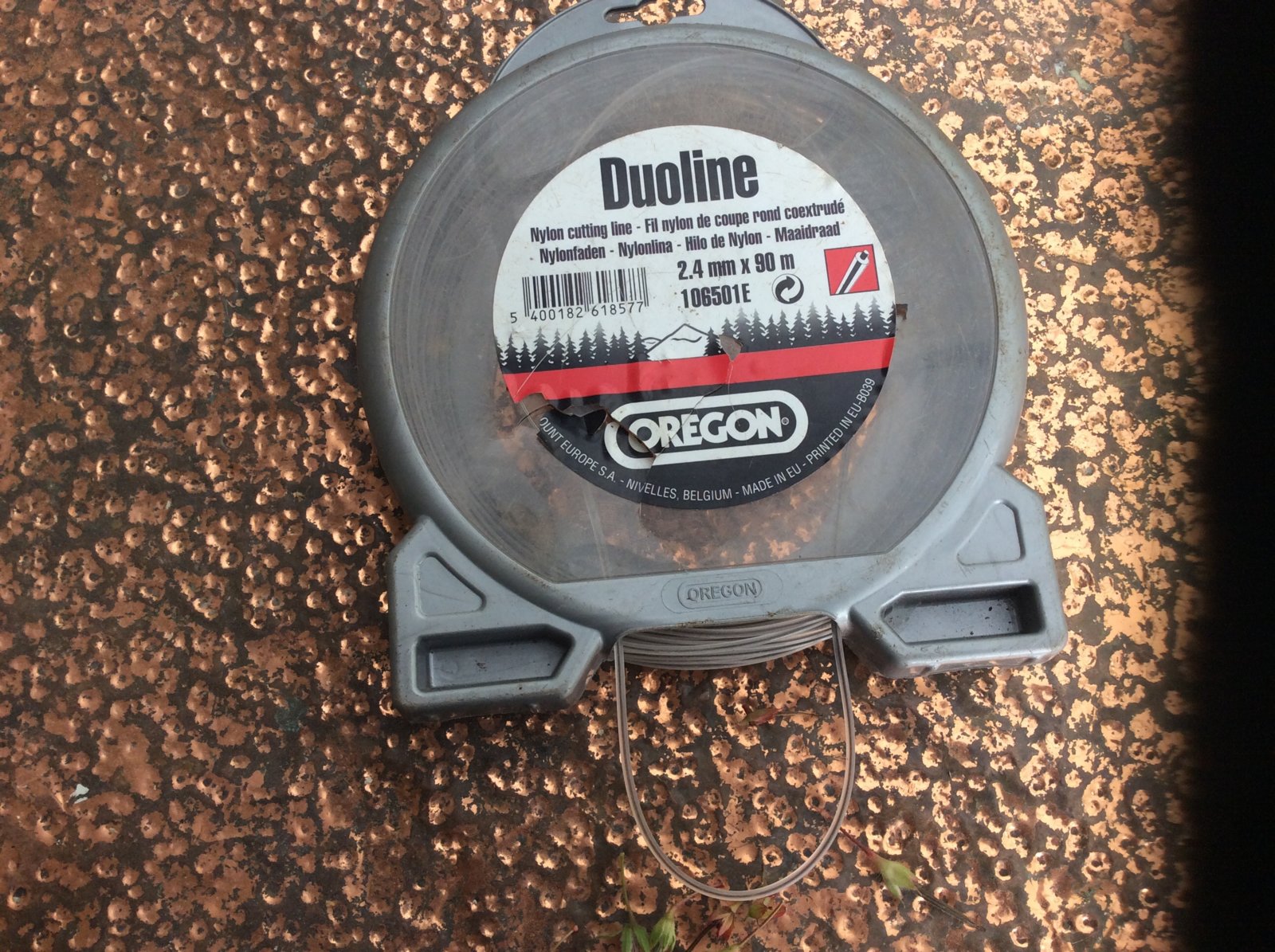

I use standard round 2.4mm Oregon nylon line most of the time for just grass, but if I'm going to be smashing through some nettles and brambles etc then I go for the Duoline that's pictured above. That is very tough and wears much slower than the plain nylon line. It is more expensive, but it lasts much, much longer. If just using it on grass I find I can sometimes go half an hour between bumping out the line with it. If you aren't paying attention it will cut through plastic plant pots, mark the bark on trees, and damage all sorts of things though, especially if running at 100% on the strimmer, so some care required with it (as with all line really though).
