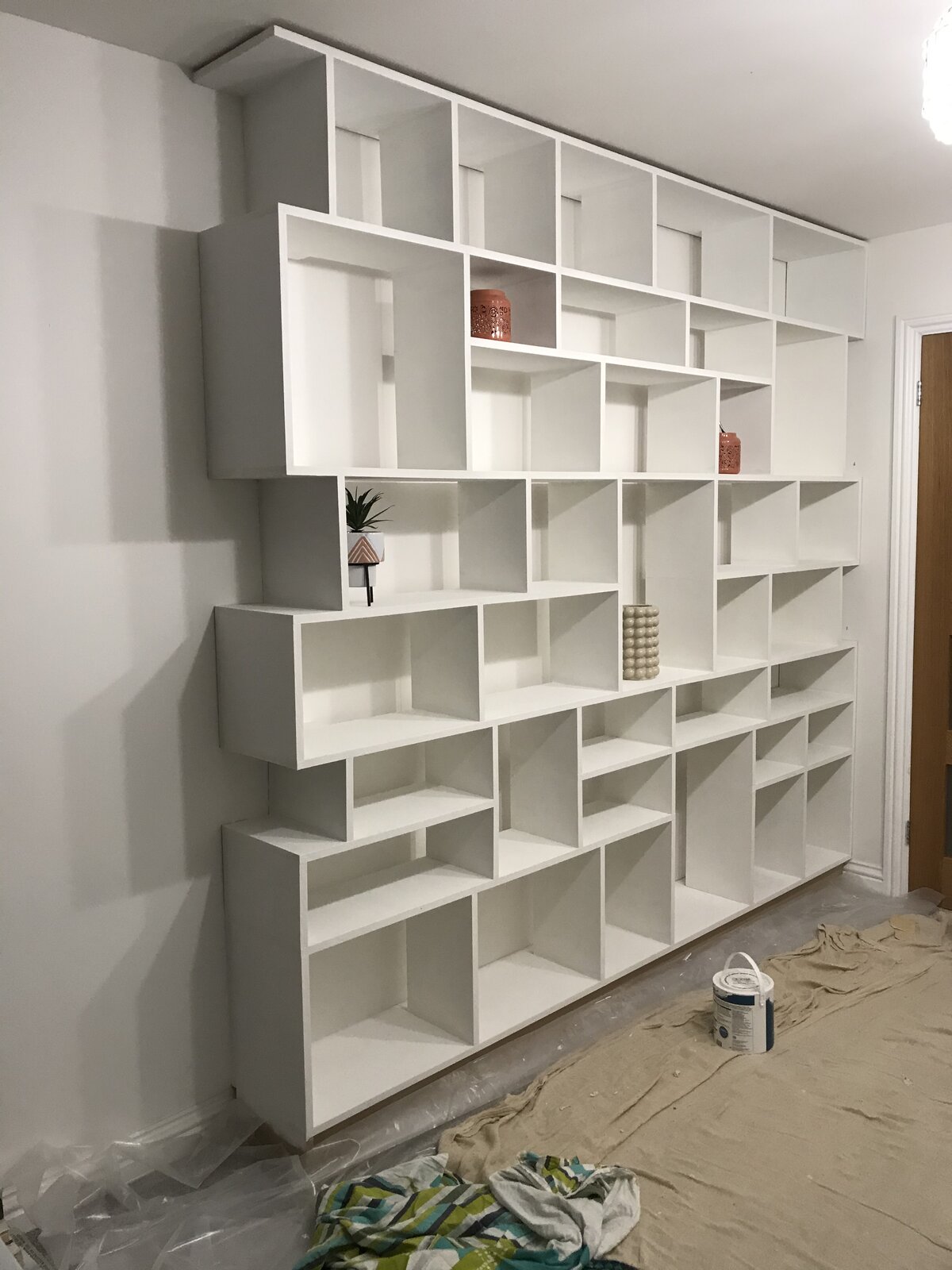

I’ve built this bookcase which is awaiting its top coat of brown.

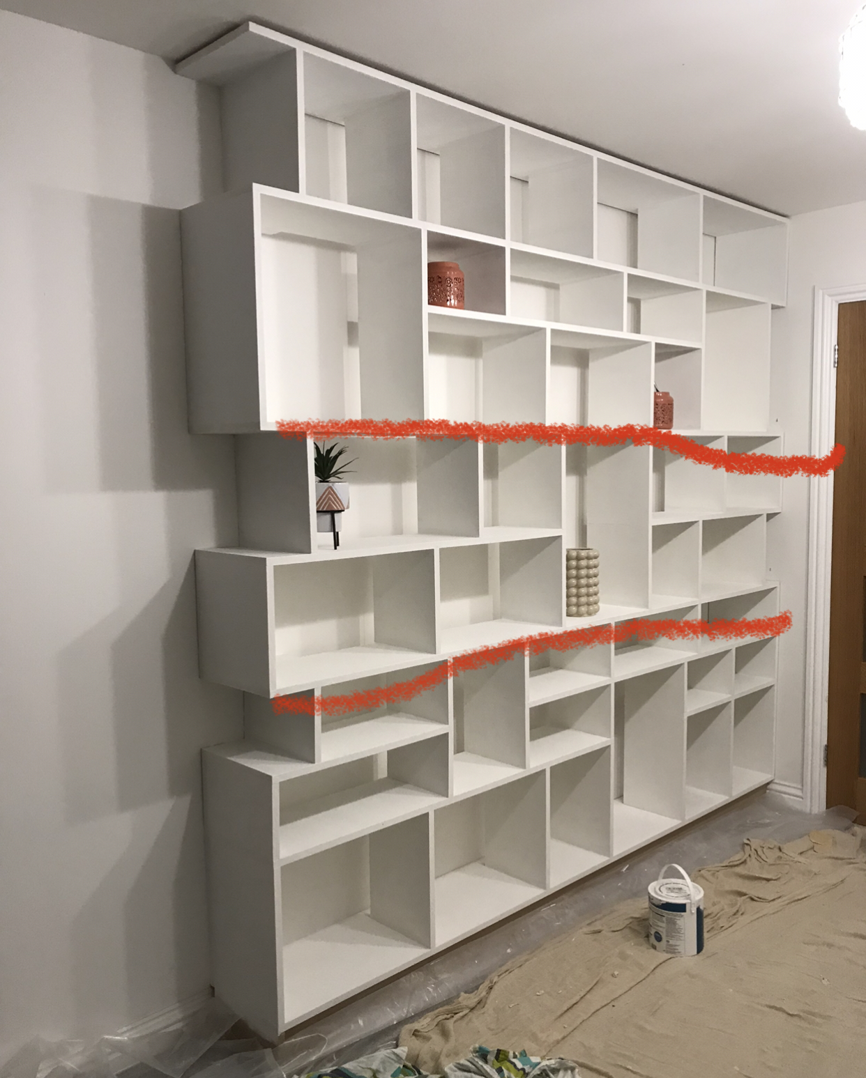

I am planning for two lengths of striplight to be fitted to the back of these two shelves to provide a backlit effect:

The strip can be cut to size and stick to the back of the shelf. I was planning to wire the connecting cable into a junction box and then take these two sets of wires to my transformer. I also need a way to pin the wires behind the shelves so they aren’t visible. A sticky cable tie perhaps as I am unable to get a hammer behind the shelf for a cable pin?
