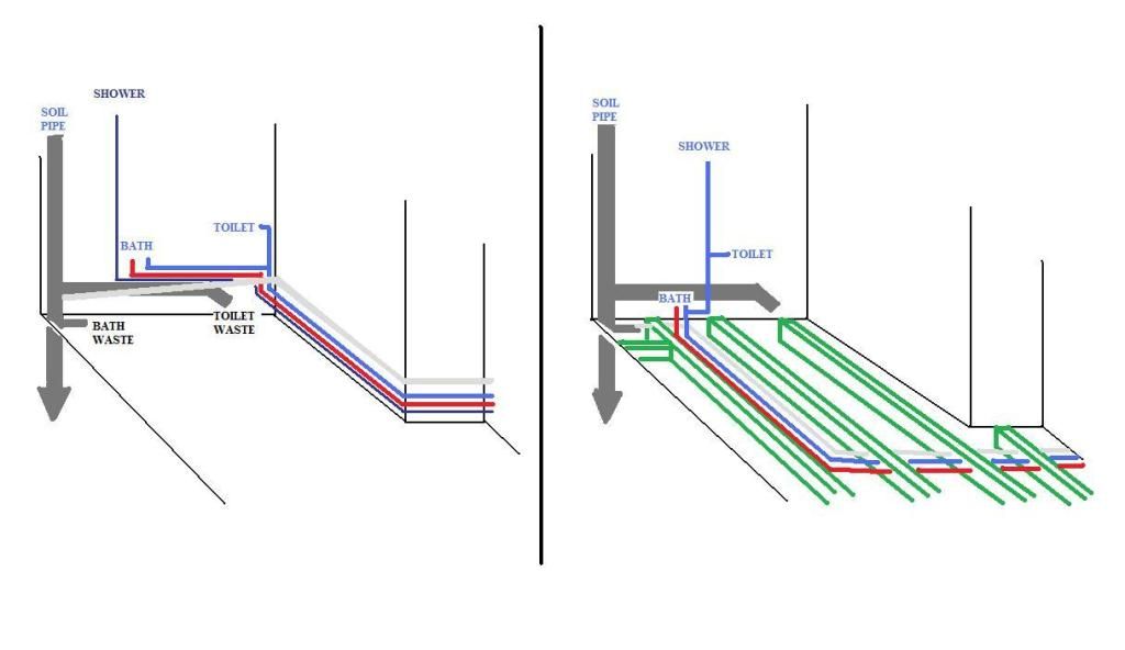

The first step is to move the pipes from along the wall to under floorboards, but I'm realising its not gonna be that simple.
Question 1: waste from basin is 32mm. I need to get the right slope through the 'safe' parts of the joists to the soil pipe, but the current 2 points of entry into it are above the floorboards.
any suggestions welcome as all i can think of is removing a section of the soil pipe (not sure how though) and breaking into the boxing that covers around it on the floor below and making a point of entry there???
