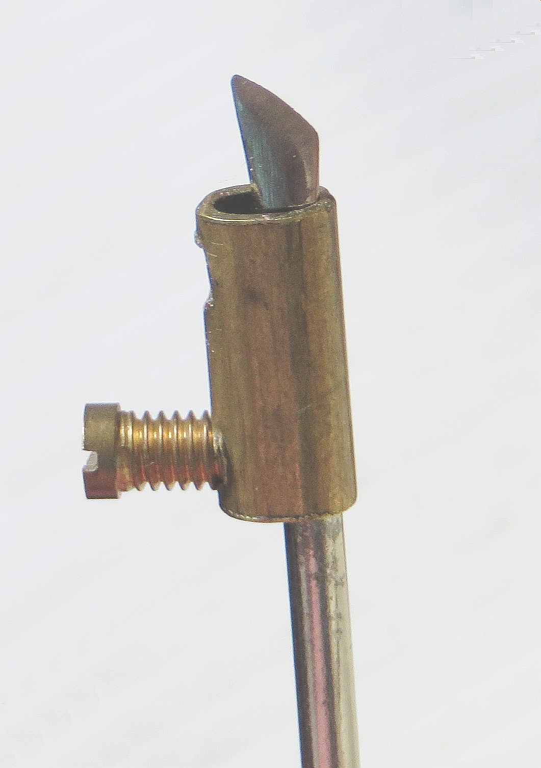

This is what I use :
It's a sharpened screwdriver blade with the insert of a choc-block connector as an adjustable depth stop.
