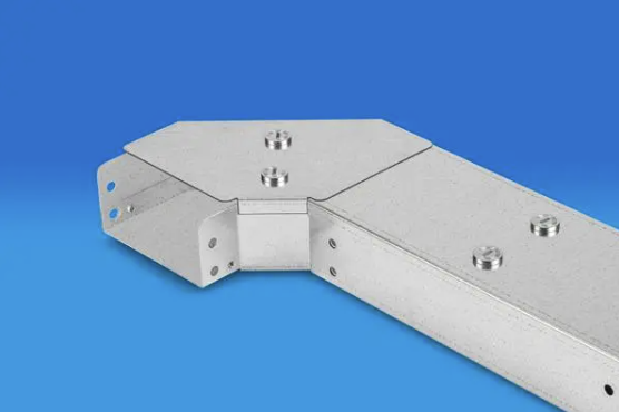

I thought that IPXXD was essentially the same as IP4X, since it requires there to be "protection against unintentional access to live parts with a wire of minimum diameter 1.0mm" ?IPXXD is far less stringent than IP4X.
No, it isn't the same at all. Otherwise there would be no reason for the two designations.I thought that IPXXD was essentially the same as IP4X, since it requires there to be "protection against unintentional access to live parts with a wire of minimum diameter 1.0mm" ?
AIUI The big difference is that IP4X requires a solid object of 1mm or greater size to be prevented from entering the enclosure at all. Whereas IPxxD allows the "access probe" to enter the enclosure as long as it doesn't come in contact with hazardous parts. The access probe is only 100mm long.I thought that IPXXD was essentially the same as IP4X, since it requires there to be "protection against unintentional access to live parts with a wire of minimum diameter 1.0mm" ?
I understand what the two different 'designations' mean but I still personally feel that, in terms of what 'matters', IPXXD achiNo, it isn't the same at all. Otherwise there would be no reason for the two designations.
That's always been my understanding, with the one exception that I thought (perhaps wrongly!) that IPXXD required that the 100 mm long) probe could not come into contact with "live" ("not hazardous") parts. If that were the case (maybe not - I'll have to check!) then what you go on to write, namely ....AIUI The big difference is that IP4X requires a solid object of 1mm or greater size to be prevented from entering the enclosure at all. Whereas IPxxD allows the "access probe" to enter the enclosure as long as it doesn't come in contact with hazardous parts. The access probe is only 100mm long.
.... would cease to be relevant, since, even if the wires only had basic insulation, they would still not be 'live' parts - so there would be no live parts for the probe to touch!If we assume that wires with only basic insulation are "hazardous"* and sheathed cables are not then it would seem the main difference would arise when only some parts of a trunking system contained wires with only basic insulation, then parts of the trunking system more than 100mm away from the wires with only basic insulation would not need to worry about IP ratings.
Thanks, but I think that article merely adds to the confusion/uncertainty I discussed previously ...![]()
Trunking and IP Ratings - Voltimum UK
In this article, NAPIT’s Bill Allan discusses the application of the IP Code to cable trunking.www.voltimum.co.uk
Nothing ever is on here....Good to know it's not a simple answer
Trunking used to contain uninsulated conductors?Comments?
