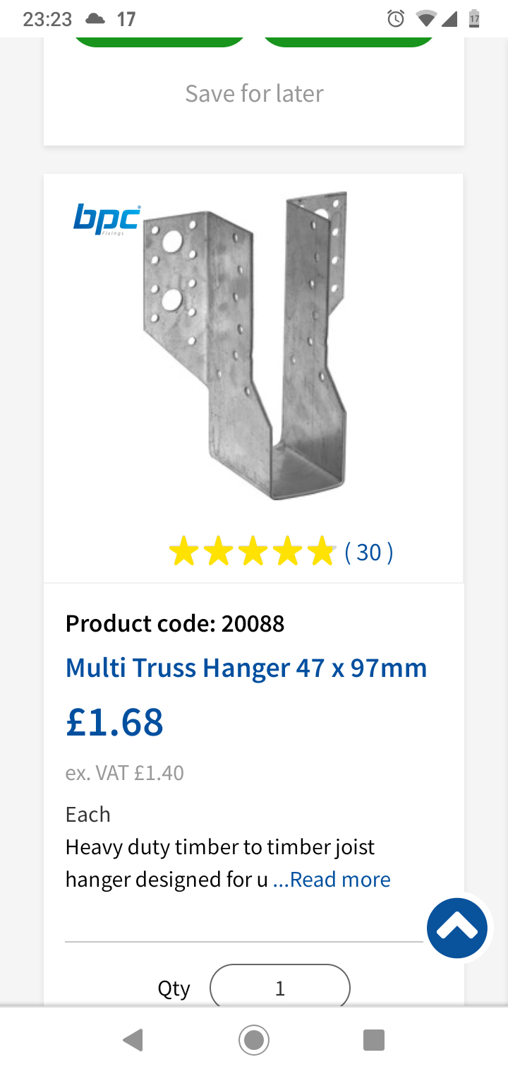

What size joists you using? Can't see any dimensions for the BPC hangars I usually use (43424 from the same supplier as above) but they appear to have more nail holes in the first 100mm than those posh ones you linked to, with your setup you can't spike the back cos there's a wall in the way. Those 20088s linked above- be handy if they specified what a heavy duty load was for double the cost!
And timber dimensions- grrr. Last batch of 4 x 2 I bought is more like 45 x 95 which is a pain when you have to stuff 100mm rigid insulation in.
thanks cdbe
i saw those but has scrubbed them as they are 97mm high and i'm using 120mm
from the picture, there is no place to fasten on approx the bottom 3rd meaning likely only 60mm would be able to be fastened
That said, i'll head over to BPC to see if they have a diagram with measurements on
