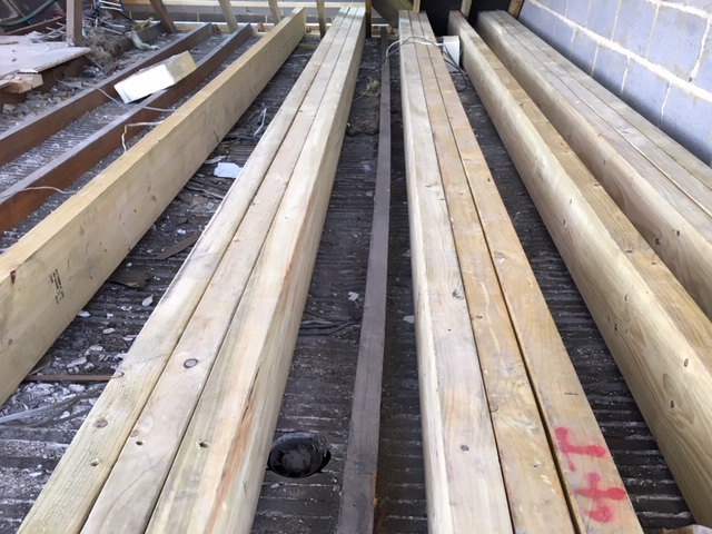

All the load/span calculations relate to acceptable deflection not the point at which the joist will fail. If you are taking boards up, you could fit noggins to stiffen the floor up, you could even sister the joists for as much as you could get at, the bending occurs in the middle of the span so the floor would be stiffer even with partial sistering of joists. I have the opposite "problem", my builder envisaged problems installing a steel that would cross under my joists to provide adequate stiffness because of its connection into a party wall. The engineer simply got around the issue with massive joists, doubled. Where my shower is (in my loft conversion) an extra joist were added because it is technically a bathroom. Some of the joist (not yet installed in the pics) are also flitch beams. You could park a lorry in my loft and it wouldn't bend!
Rather than sistering, what if I put 8 x 2 above the existing joists ..so we have a 8x2 --floorboard--8x2 sandwich. Will this have same structural effect as sistering? I'm going to puth the bath on a plinth anyway so this is a lot easier...
It would be roughly the same structurally as sistering in terms of bending stress and deflection, though it will not reduce shear stress at the bearings
