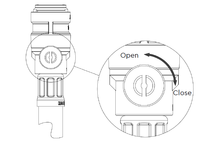

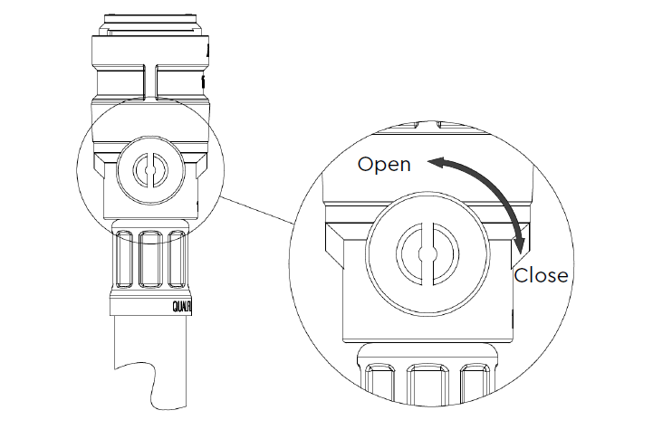

If your pump is equipped with these two isol valves then shut them and see how long it remains off.
You just shut each a 1/4 turn and then reopened each by the same amount and now no HW when pump starts?.
Strange, maybe slacken HW hose at pump to check for air.
You suggested I shut them, which is what I did. When I opened them, the pump ran for 2 or 3 seconds. I didn't run the hot water with the valves closed - I just assumed with no pump in the circuit I'd be back to low pressure or none at all. Sorry for the confusion.
