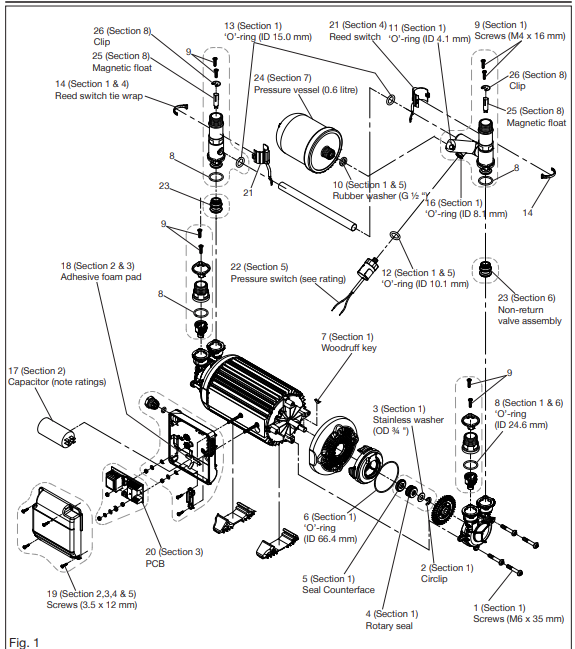

I do suspect it is running in parallel which does allow flow to dilute either side. I've attached an exploded view of the pump. Nothing stands out to me.
I did try something like this and when running just the hot, the 15mm pipe was very hot and the cold outlet was hot
Doing the opposite kept the 15mm pipe hot and the cold outlet was warm.

It does seem to be a straight through bit of pipe which doesn't seem very clever to me anyhow, there is a 4.1MM O ring on the T off to the PG but nothing like that on the straight pipe.

So I did the xover test and no water came out. When I run just cold water, the 15mm pipe gets hot and I can feel the hot water pullung through and up the cold outlet. When I run the hot water I can feel the cold running through the pipe and cooling the hot outlet. It seems that its made to do this which is strange. I managed to get my hands on a positive head pump for testing which I connected last night and works with no issues at all. I am going to return my pump this morning and look to go with positive head.
Its more than strange, its almost unbelievable that its done it this manner, it makes some sense if a say a 1mm/1.5mm orifice was fitted in the pipe to give a very small flow of ~ 0.2LPM, brings in either hot or cold + a very small flow from the unused end, to stop that side overheating and burning the seals out, say washing a car with cold only.
I think originally, they had two pressure switches, one on each outlet, with the EV/pressure vessel on the hot end, they then had just one switch + the EV/pressure vessel on the Hot end only, assumes that hot is normally requred as well as cold.
Yes I agree. I gave the tech team my feedback but he was adamant that was was not the pump but its clearly setup to allow flow to travel between the 2 sides. The positive head one is also significantly quieter so this is certainly the way to go for me.
