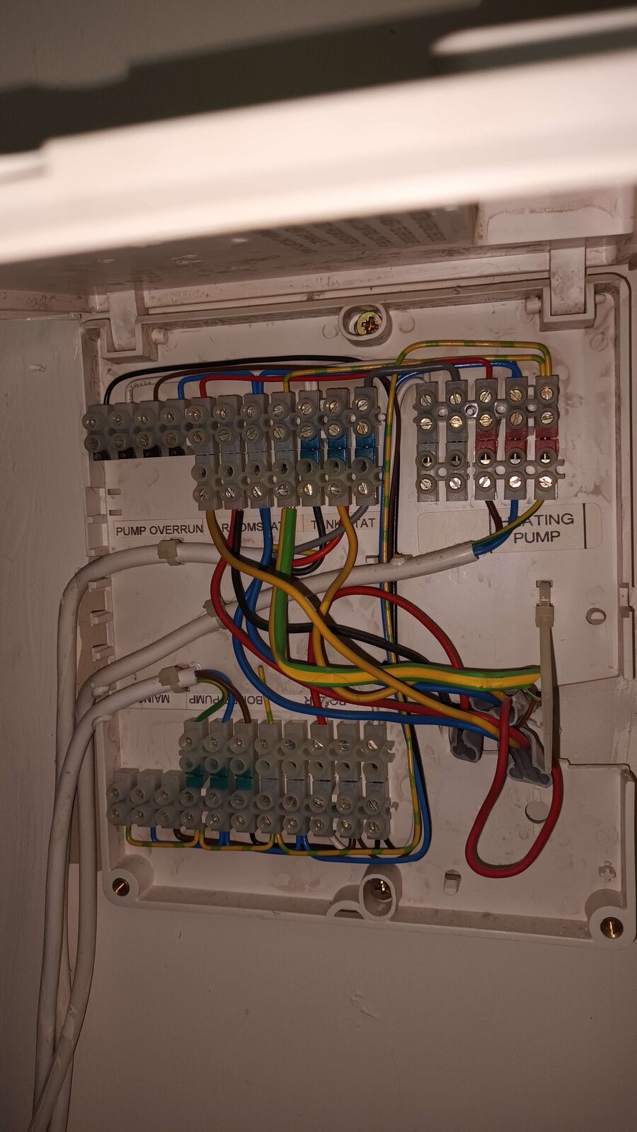

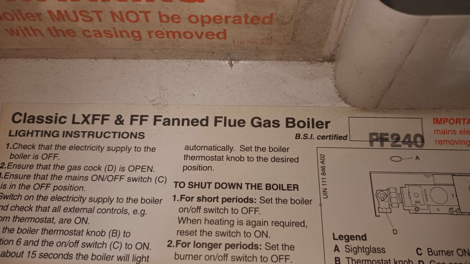

Hi all. any help is gratefully received!
I installed a Nest (DIY) back in October but I have since realised that it was not working as expected.
It does not seem to be using the tank stat and hence I suspect that I am using a lot of gas. Not good at the moment.
It was also not firing the boiler for calls for heat, instead just pumping any hot water that was present due to a previous call for hot water.
I believe that I have a 1990's style S-Plan with no zone valves. Instead I have seperate pumps for H and HW. I also have a non-powered valve that diverts water to H or HW. Not quite sure how that works.
The tank is (I believe) a thermal store.
Pictures attached are all before I made any changes. I will then post pics of where I am at.
Don't reply yet - part 2 to follow.....

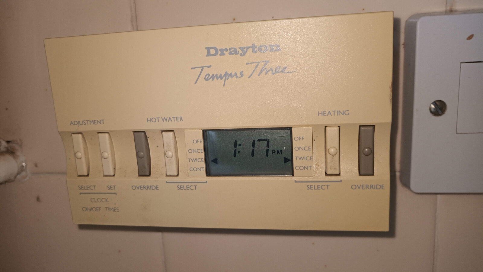

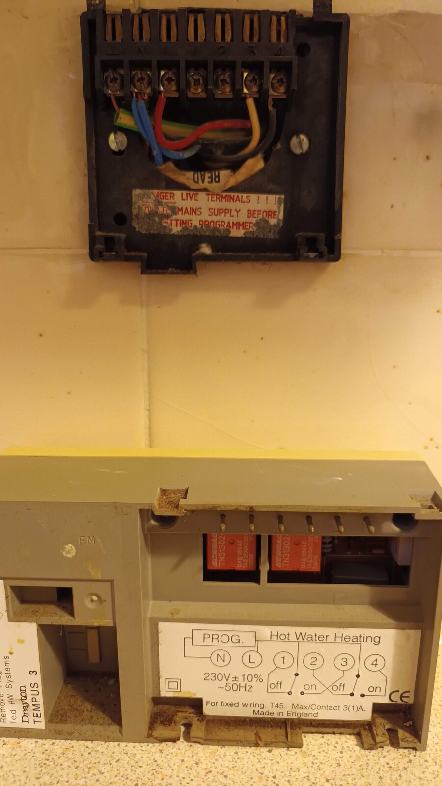

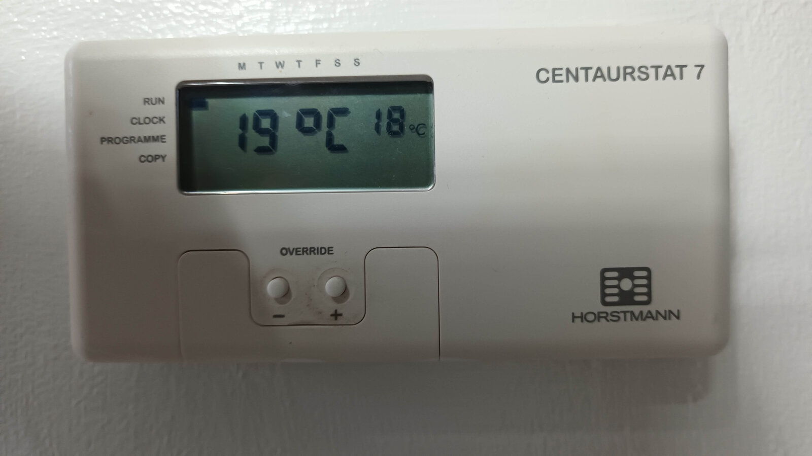

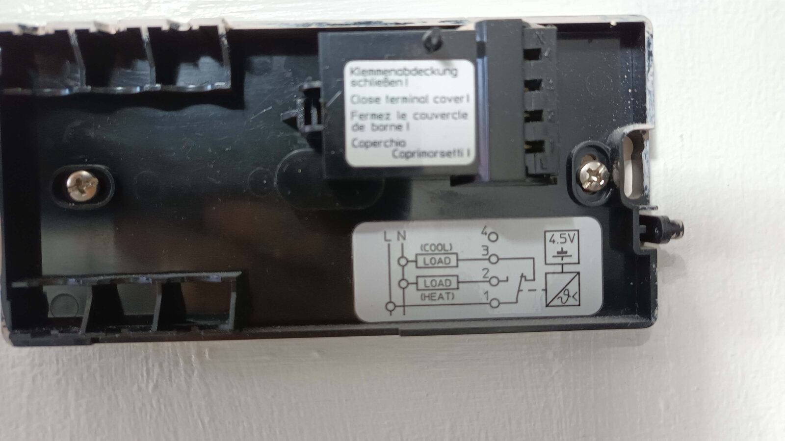

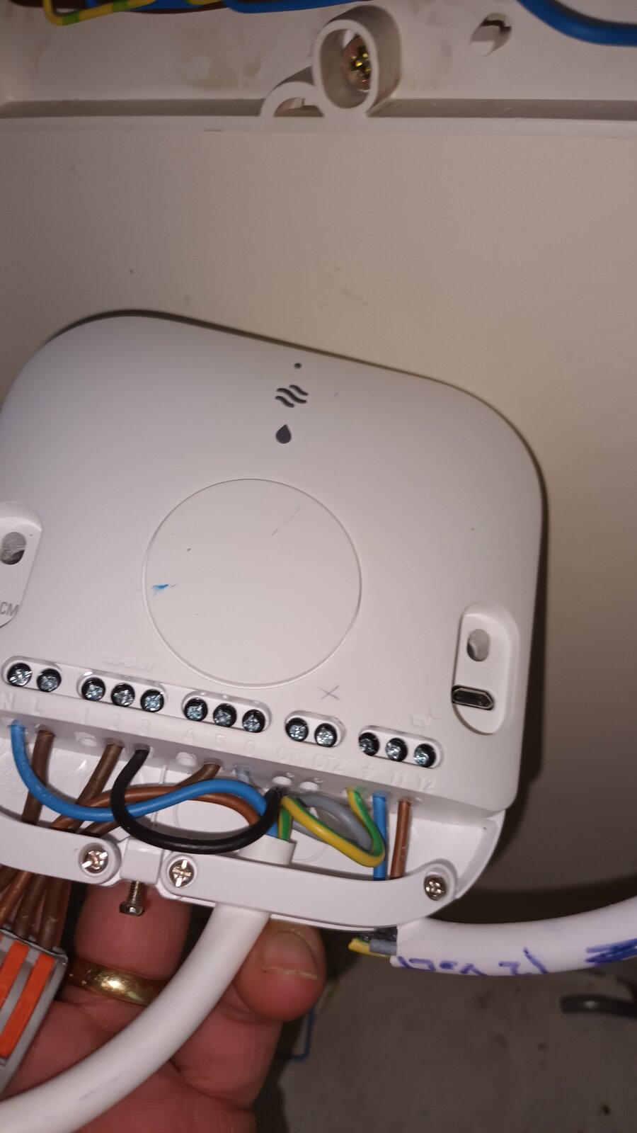

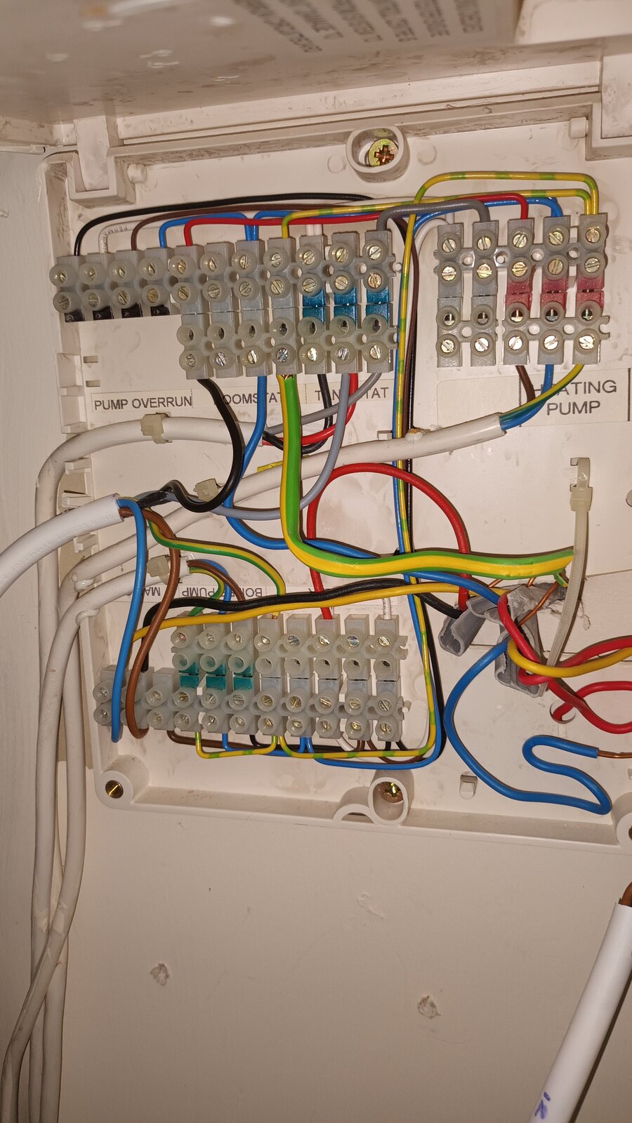

So, I have:
1) Used the old thermostat wires to power the thermostat via the HeatLink 12V outputs.
2) I could not find any permanent live in the boiler cupboard and hence used the redundant wires from the programmer (call for H and HW) to get live to get live and neutral to the boiler cupboard.
3) All other programmer wires are joined together using Weygos, in the same way that they were joined up previously.
I can't recall why I still have a blue wire from the room stat going in (over the S in Roomstat). If I remove this wire then I can hear the boiler clicking when there is a call for heat, but it does not fire.
I have for now run a wire from where the HeatLink call for H is wired, to the (empty in this pic) plug above where the HeatLink call for HW is.
I did that because calls for HW fire the boiler and this was the only way I could find to make a call for H fire the boiler. No doubt it is should not be required though.
I am not convinced that the tank stat is being powered properly, but not sure what to do about that.
I have clearly got something wrong :unsure:
(The unused red wire (was never in use) and the now unused blue wire are both safely capped off with seperate Weygoes).
Happy to be called a numpty but I am stuck and would welcome your advice, please.

No you have a thermal store, this is how it works when switched on the water from the boiler is circulated around the cylinder via 1 pump, when a demand for heating is requested the CH pump circulates this water around the radiators, you do not have a HW pump, when hot water is demanded there is a high heat gain inside the cylinder runs through the inside of this coil and runs from the tap or outlet that has opened, I have never wired a nest to your set up, give me ten mins and I will try and work out a way to do it

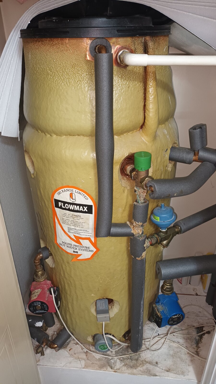

Thanks Ian - but see the attached (respectfully). The red pump is labelled "heating" and the blue pump definitely activates when HW is requested. I believe this is why we have such a powerful shower (which was one of the selling points of the house when we bought it all those years ago).
you have a powerfull shower because it is mains fed and blends, the pump comes on because the stat in the cylinder detects a temp drop and pumps HW from the primary water from the cylinder back to the boiler keep the primary water hot the pump is not pumping the water that comes out of your hw shower or tap, you should wire the room the existing room thermostat to the nest as a single channel ane leave the rest of the wiring as is, the Cylinder thermostat on that does not directly control the temp of the water inthe taps but in the core of the cylinder , the temp of the HW coming out of the taps is controlled by the blending valve on the pipework

when you have CH calling the CH pump runs to circulate the water from the cylinder to the radiators, when you run the hw the CH pump stops, when the hw demand stops, the ch pump doesnt start again until the store is back to temp (Cyl stat) then the ch pump will kick in again, the cyl stat acts as a changeover, it doesnt work like a standard cyl stat does
Had a think about it and should be quite easy
Horstman terminal 3 to nest 3
Horstman terminal 4 to nest 6
N&L to nest and L&2&5 linked
the wires in centaurplus 1&2 join together isolate or totally remove all the other wires
let me know how you get on and dont mess about with the wires inside the wiring centre
