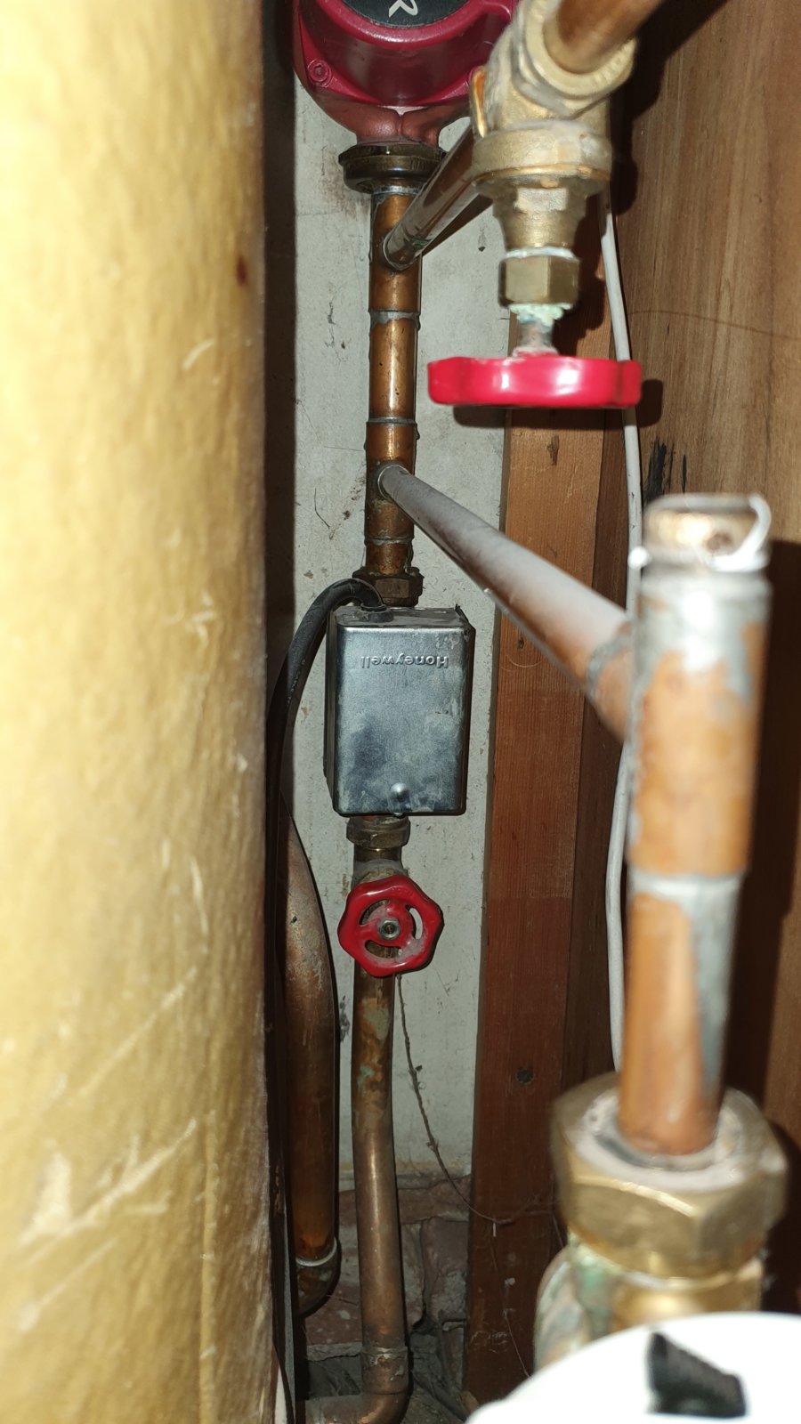

Hi all,
I've recently had a glowworm 30r energy system boiler installed along with a Nest thermostat. All was good for approx 3 weeks up until last night. We noticed that the heating wasn't coming on despite the thermostat calling for heat. I've tried resetting the thermostat and the boiler but to no avail. Both look to be working fine. No error codes.
I've found that the hot water works correctly. So I've set the valve for the CH to manually open so the hot water being on allows for the radiators to now heat up.
This valve appears to be stiff so my thoughts are that it has failed and remains constantly closed.
My question is, how should this valve behave? Ie when heat is requested by the nest thermostat to its heat link I hear it click as if acknowledging a request for heat. Should the valve then open and then at this point should that turn the boiler on?
At present nothing is happening but it appears that the above process is what happened for the hot water using a different valve.

The valve should behave as when there’s a call for heat, the valve is motored open and operates a microswitch, which then operates the boiler, once satisfied it then removes the power to the valve and the valve springs shut.

It does sound like that, but is that for hot water or heating? Looks like you have a Drayton valve towards the front?
It's for heating.
From what I gather the Drayton valve is for hot water only and the Honeywell is for Central heating only.
Is that normal?

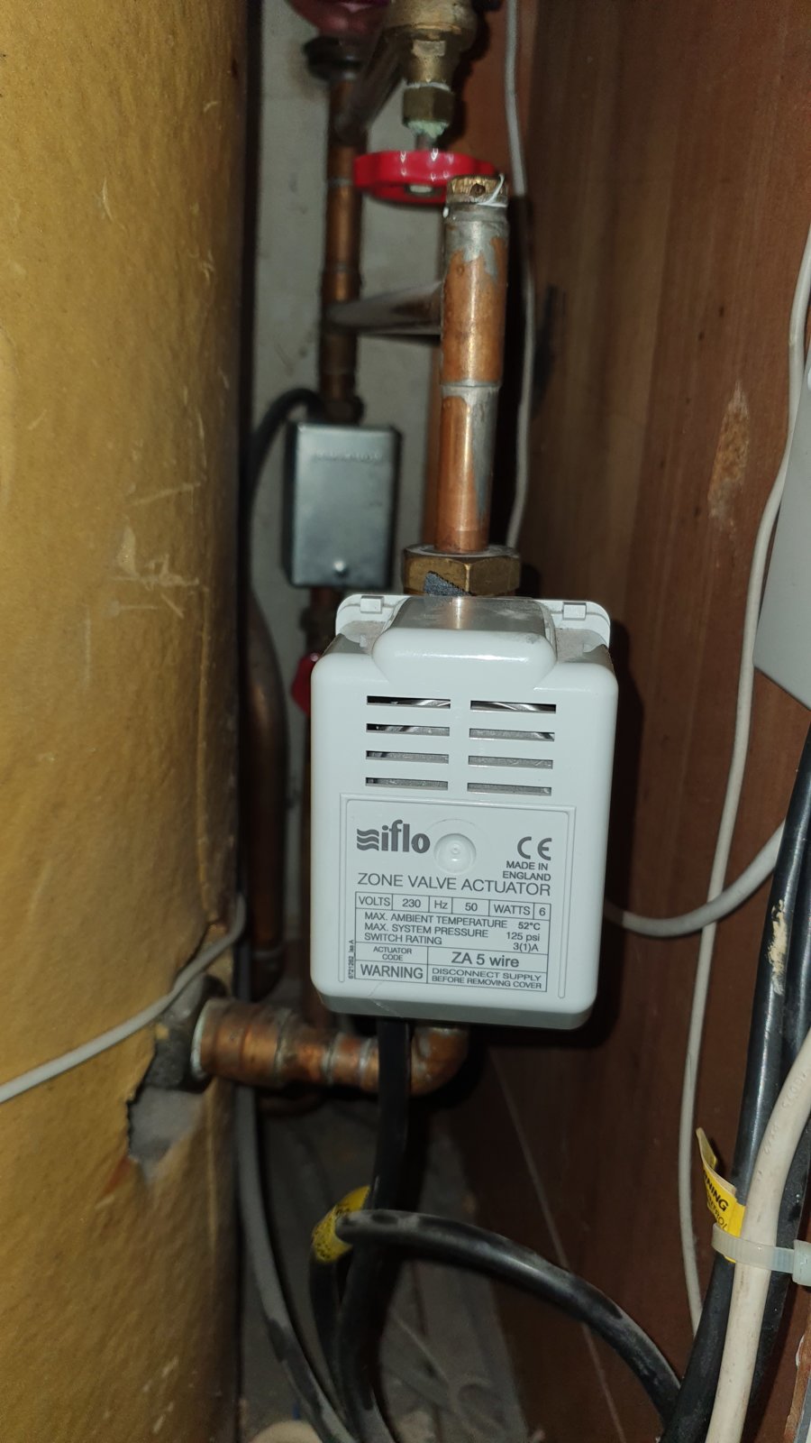

I moved in to the property in September and this is the first time I've had any experience of this type of system so I'm still trying to get to grips with it.

Either valve and actuator make could have been used for either application. They are just basically 2-port motorised valves.
Actuators heads, the electrical part of the valve, are a common point of failure - so the chances are good that it has failed in some way. Their motors fail, their microswitches fail, they can jam, or simply break. Its worth seeing if you can remove the head from the valve, to see if the actual valve is free to turn manually - but ensure the power is off.
The it should work, is that your stat should signal the valve that there is a demand for heat, your actuator / valve should then move to the open position, where upon a microswitch is closed and that signals the boiler and pump to run.

Thanks again for the help. I was referring to the manual lever being stiff to move to open it manually (which I've done so it is now always open, but only to let the water travel around the system when requesting hot water).
It sounds like maybe the motor is ok but the microswitch has failed. Or something along those lines. Difficult to narrow it down. Unsure if to try replacing the motor first or just get my heating engineer to replace the whole valve.
Just replace the actuator (head of the valve) if it turns easily when removed.
With the actuator taken off, it should be just about possible to operate the valve with you bare fingers, or quite easily with pliers. You can get just the actuators much cheaper than that, take a look on Ebay..
I'll check that out. Are they easy to remove? I take it the system shouldn't need draining while I replace just the actuator?
If I then find the valve won't turn, then that's a different story? In fact I know I can open it using the manual lever so the valve should be good. Just hopefully the actuator causing the problem.

No other way round if the motor is OK and power is going to the motor , then the lever will offer no resistance , if motored open and no resistance on the lever then it is the micro switch
There is resistance to the lever. It just doesn't seem to do anything when there is a request for heat. Is there something I could be missing?
It worked previously all fine. Nothing has changed. Wiring looks good. No slipped wires.
I may remove the old one tonight to have a closer inspection and order a new one. My heating engineer isn't getting back to me in any rush.
If you have a multi meter, first thing to check is with a demand for heat is there 240vAC going to the motor of the valve
