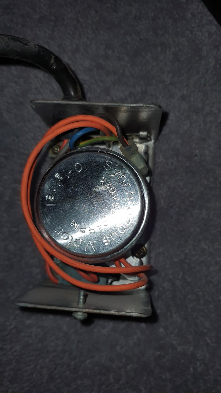

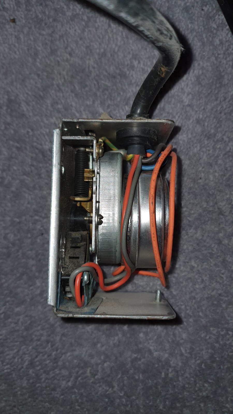

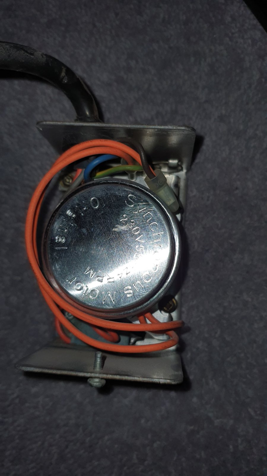

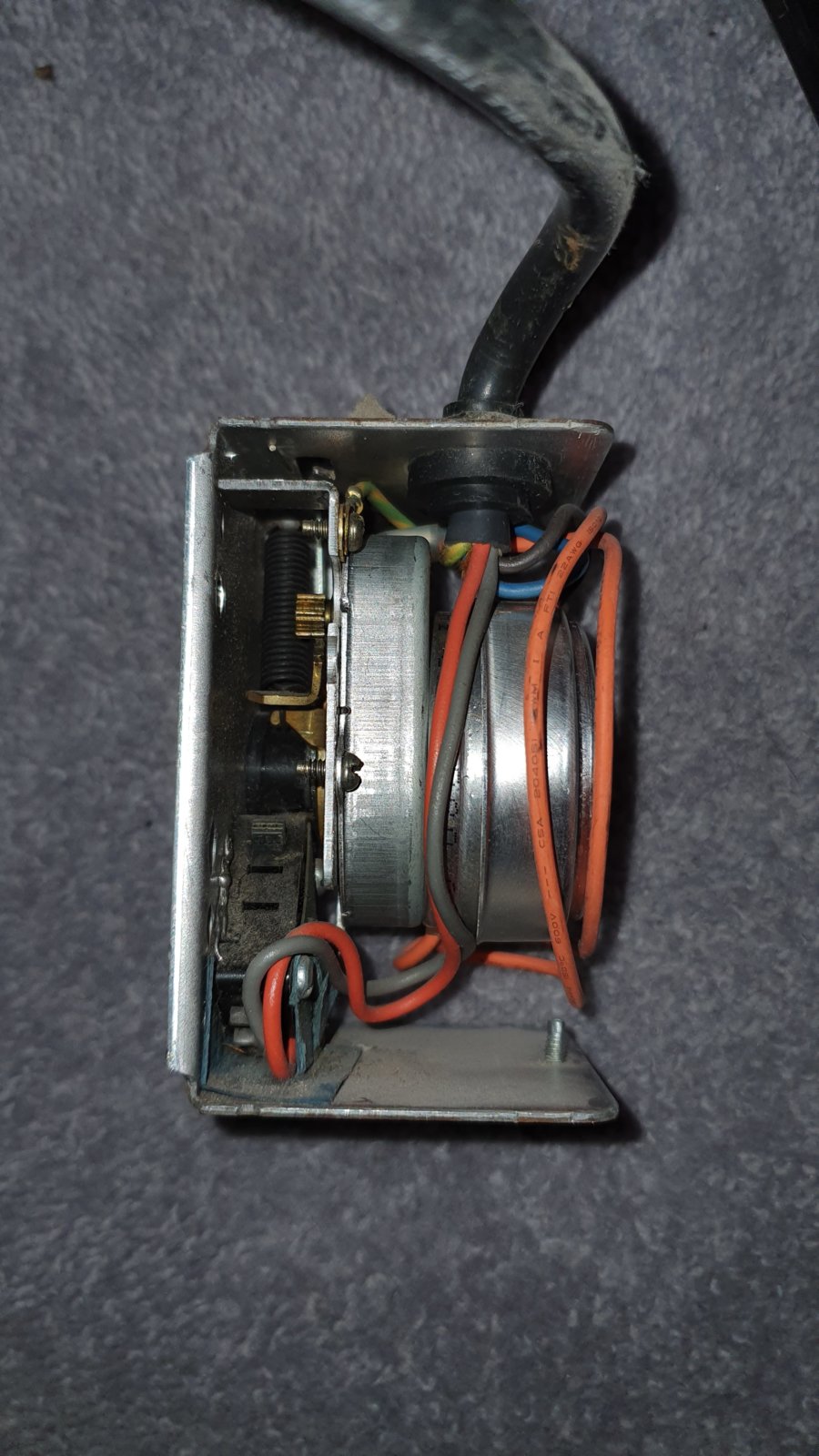

Ok so I've taken it off but I'm not entirely sure how to test if power is being received. Could someone provide some tips?
Thanks. I gave it a go but it blew the fuse. Not sure what that indicates. No reading on the meter. I've ordered a new part anyway so hopefully when it arrives it solves my problem.

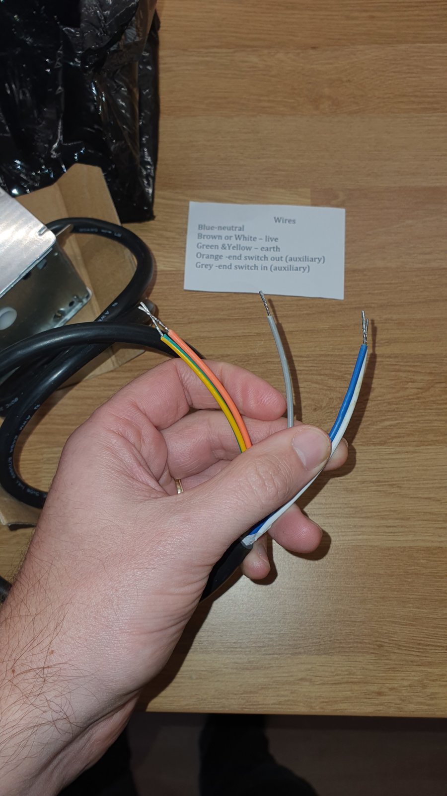

The one I ordered has 5 wires but one wire is a different colour. It appears to be white instead of black. I take it I can just wire it up as normal and replace the black for white?
normally only the 28mm valves have a white wire but so many around these days so post a pic of the new one when it arrives and I will tell you
Looks black to me? :confused: Hope it’ll work and last.
Edit: sorry thought you were on about the flex, my bad :oops:
Yes there’s a white wire.
Maybe what I see as grey is actually black and the white is the grey? That would explain it.
Hopefully. I'll see how I go when it arrives. Thanks for all the advice so far.
Hopefully it is a bad photo and there is a brown in there somewhere, that head can be used in 28mm or 22 mm zone valves so the white would be if used on a 28mm zone valve with gravity HW, you will have to wait until the actuator arrives to see
Ok, got the part. It is a white wire but fortunately they provide a label in the box.
