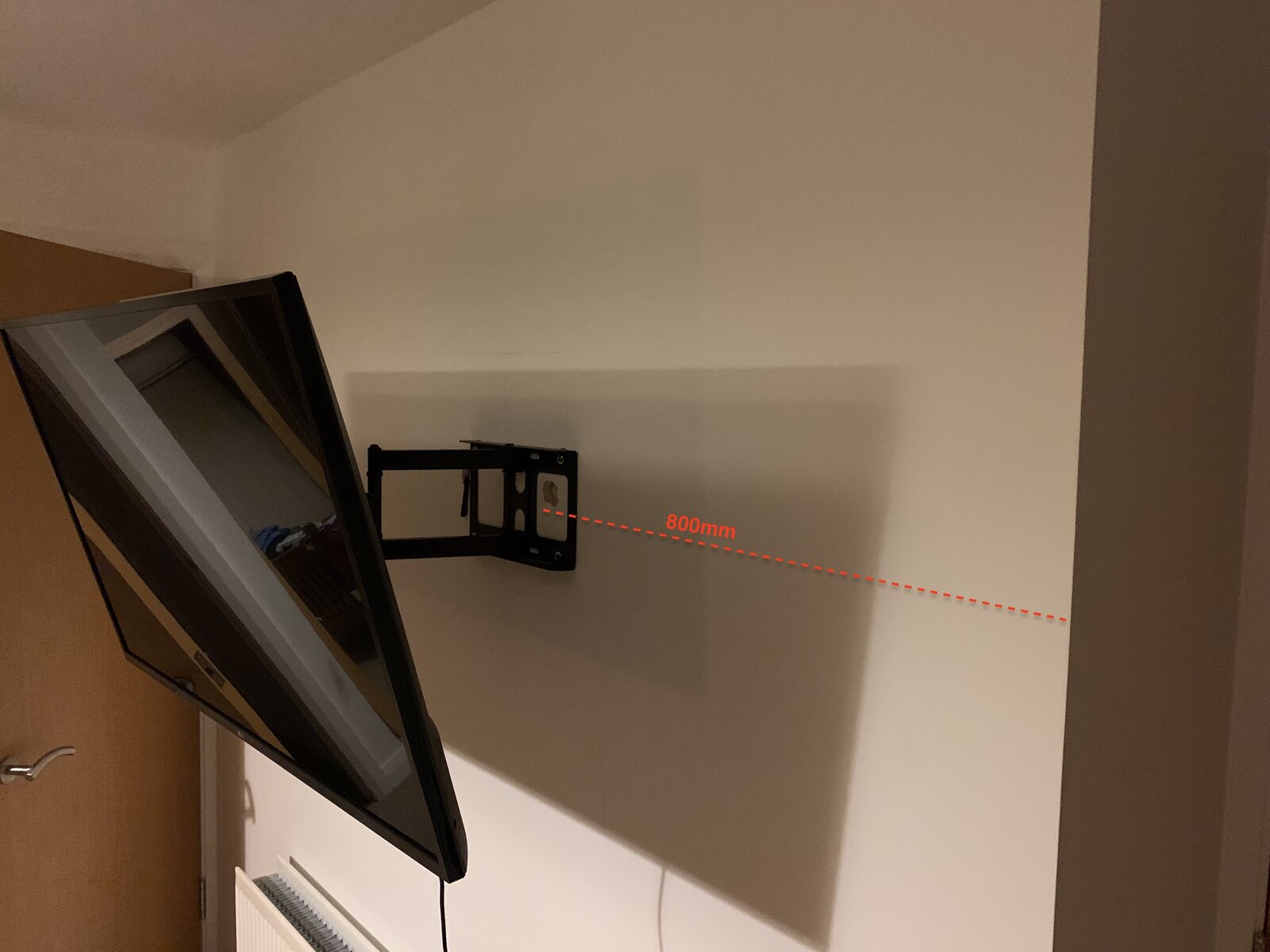

Installed a TV bracket onto a stud wall using 4x25mm Gripits. Seems solid but for an insurance policy I'd like to stick 2 coach screws into the stud as well but need to make sure I get the middle of it. As you can see, I'm having to patch up two holes as one was too close to the stud for the Gripit's wings to release.
I've attached two photos.
1. The part of the stud screwed to the plasterboard - what diameter would it be? 1.5/2"?
2. Are the studs not meant to be 600mm apart?

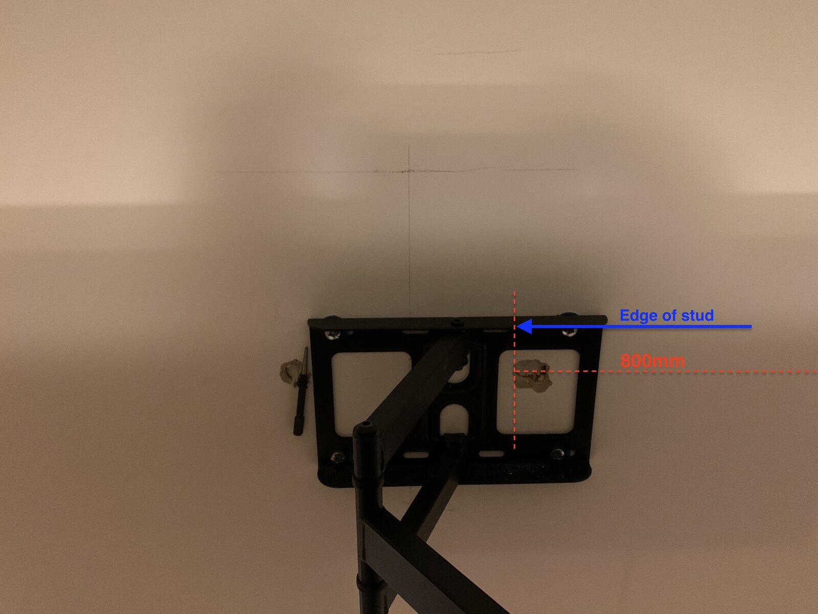

Maybe I wasn’t clear, where I’ve marked “edge of stud” is the actual edge. I can actually see it.
You probably were clear, the diagram clearly stated it. :rolleyes: at me.
The stud is probably around 40mm wide. Go 20mm in and drill your pilot hole. I'd use a Pilot hole to hedge your bets in case it's narrower than expected and to reduce the chances of splitting.

Sorry mate, I know that may have sounded cheeky. Definitely wasn't intended that way.
I measured in 20mm as you said then drilled a pilot hole and screwed in the coach screws in. Everything seems to have gone well. I'll put it this way, nothing went CRACK and the wall is still standing! :D The TV bracket is going nowhere! Big thanks for that advice.

They're very likely to be 38mm wide. Thinner or thicker isn't impossible, but would be unusual.
A pilot hole is just for the screw to go into, an identical hole used to find the location of the stud would probably be called something else (exploratory holes?). If you're able to locate the stud, or one edge, then I wouldn't bother mucking around with my suggestion for exploratory holes.
