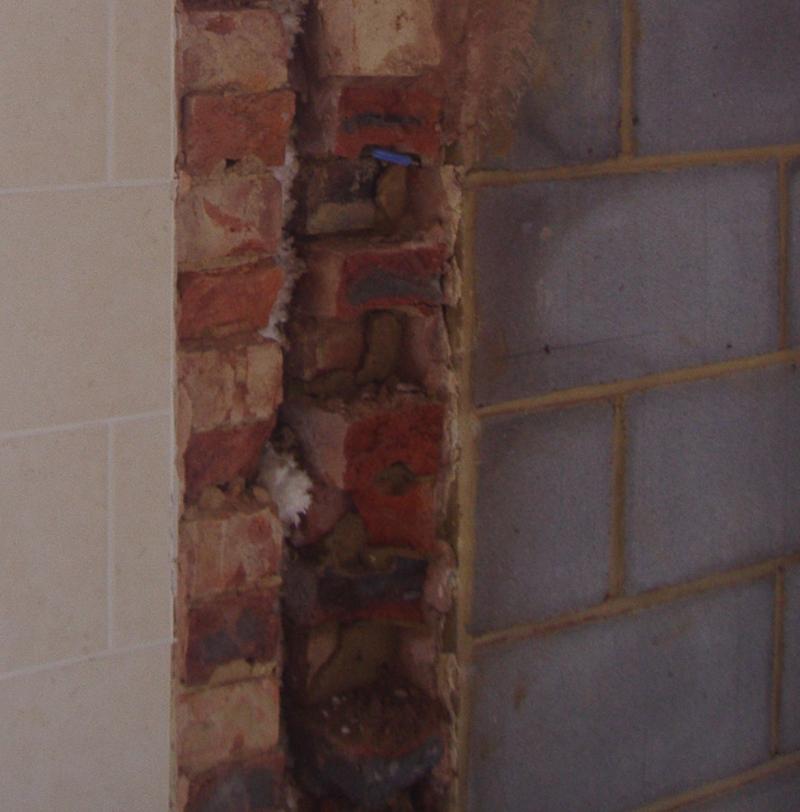

Can anyone tell me what would happen if a Wall Connector system wasn't used on a new extension - existing building wall?
That depends upon whether ANY connectors were used and whether the buildings benefitted from being connected.
Hi

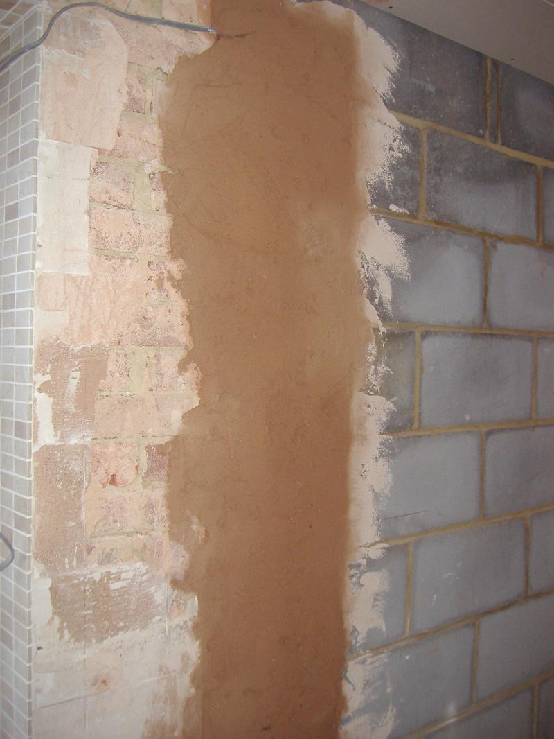

The reason I ask is that I'm having an extension built and they used those wall starter kit things to tie in the new connecting walls. However, when they took out a bit of the existing wall (about 2.5m) that is perpendicular to open into the new area, a lot of the existing bricks that the wall connector was secured to have come away.
You can see the screws and wall plugs sticking through in thin air. I asked whether they were going to cement in the gaps to strengthen it and they said yes.
However, when I got in tonight it's been done and sounds hollow. I suspect its just been plasterboarded and bonded, which means the wall connector is not attached to anything!
Please see pic - I hope it makes sense.
