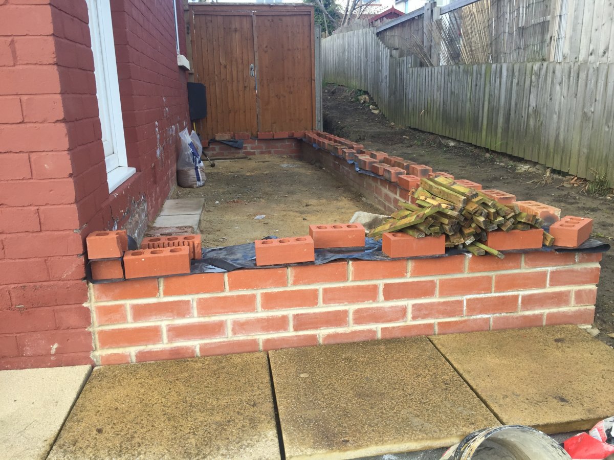

I am currently building a small side extension to my house under permitted development.
I managed to lay the foundations and build up to DPC last year before the winter kicked in. I am back on the case now and have a few questions if anyone can help.
The house is made out of imperial bricks and therefore I have used 70mm bricks and matched to the top line of the the houses existing courses (shown in photo).
I am hoping to lay the DPC and then lay two more courses of 70 mm bricks. I am then going to block work the rest of the extension with the intent of rendering the extension and the front of my property. My question is I am using this wall starter to tie in the block work to the house. As the blocks are metric the course levels will be out of line with the existing imperial house brickwork. On an aesthetic level i don't care what it looks like as i have the 6 courses of house bricks matched and inline (which will be shown and below the render) and I will be then be rendering the blocks.
My question may seem silly but is this method correct, using the wall starter and not matching courses? Is there any alternative. Many thanks.
Would you not want to render down to the dpc, so you can just use blocks above dpc.
Wall starter above dpc and it does not matter about matching the courses as it won't be seen.
Thanks for the reply.
I was working on the basis I needed some kind of gap between the DPC and the Base of the render in case some kind of bridging occurred.
Is that not the case? If not then blocks straight onto the DPC would save me some time and bricks.
That sounds good. So on my 100mm wide bricks I can use 112mm DPC and leave the 10 - 12 mm spare DPC extending past the face.
The existing house DPC doesn't protrude but as long as my bellcast bead doesn't bridge it i should be fine?
I am sure others will say different, but that is the way I would do it. You can then literally sit the bell cast on the DPM.
For the existing house yes that's fine, just sit the bead above the DPM.
Thanks tomfe. I like this post about fixing batons along the existing DPC to allow the bellcast bead to rest onto allow for rendering up to DPC.

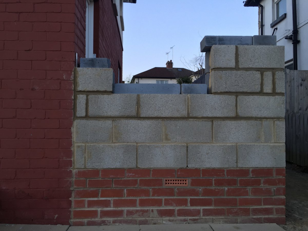

Here is update. I ended up using the 70mm bricks for the two courses above the DPC as I had tons left over and thought i may aswell use them.
Can anyone advise on Regs for building out from the house before an opening (is there a minimum width of brick /block? You can see from the Image I have started an opening for the window. The brick work will be tied into the Wall starter but how do I carry on up?
Forgot to say, Its only a single storey extension, using a catnic cavity lintel above window.
