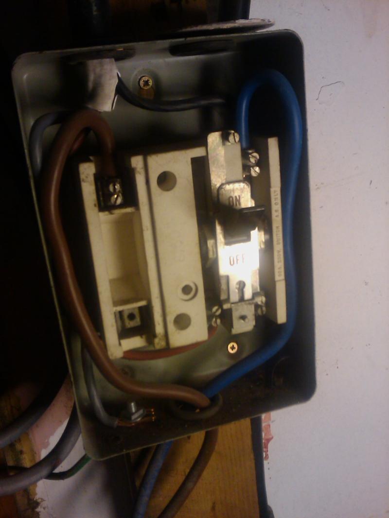

Just for reference regarding a site i was on
A shop downstairs and a flat above with its own independant door
The supply to the building is within the shop downstairs
Red phase only for the shop meter
Blue phase only via a switchfuse then 30 metre swa up to the flat meter

The cut out downstairs is 100 amp i assume the switchfuse was put in to downrate to 60 amp due to the underrated swa.
Im assuming edf would want an unswitched 100 amp rated cable run in
I will post pics later the work was appalling :x

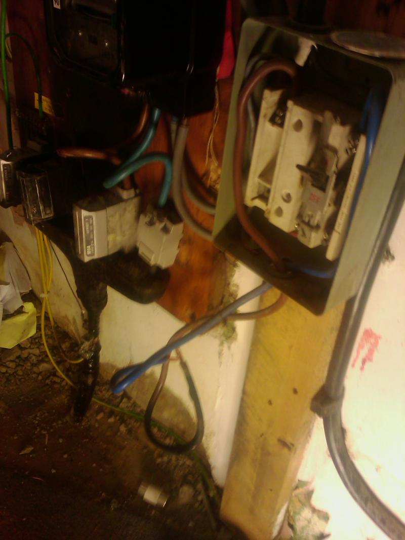

Dno man there today changing the downstairs cut out but said point blank the cables nought to do with them, i will leave it to our office to sort out

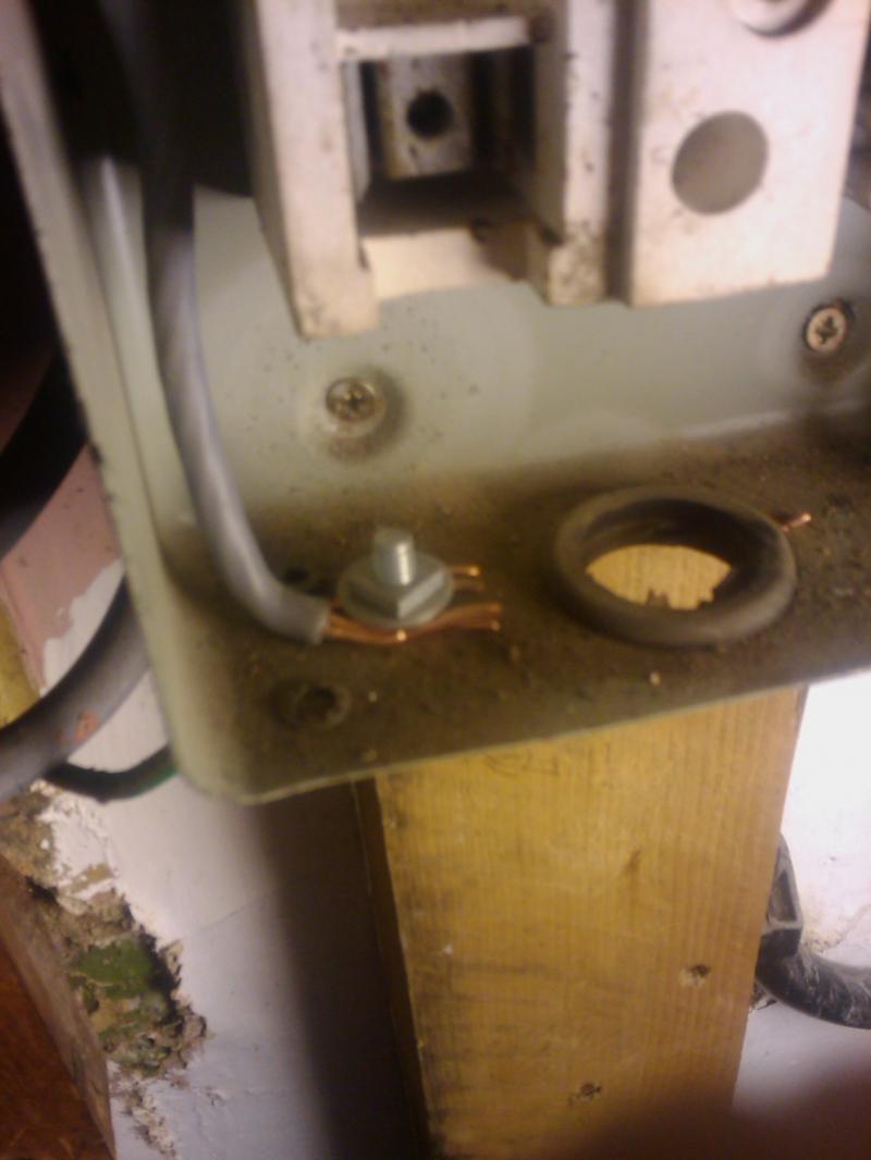

Something not right here, the Br +Bl tails now disconnected were from the cut out :?
Rough only earth connection to flat above

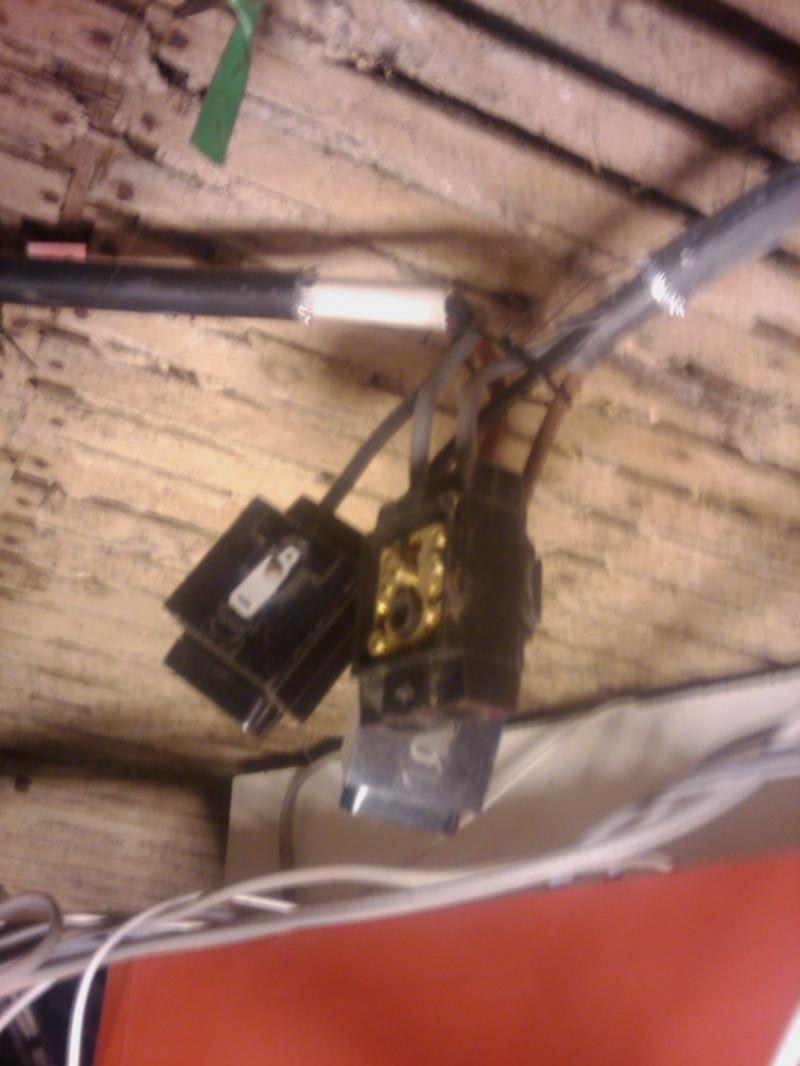

Swa connection to upstairs meter 3 core luckily
join above shop ceiling, sub main to flat, cover missing to the earth luckily
Yep, that's a DIY meter move.
Someone will be having to pay for a new supply installation to the flat :roll:
Had they left the meter in the shop then it would have been OK-ish (ignoring the dodgy standard of work) - though somewhat impractical as it would have meant access to the shop to read the meter.
