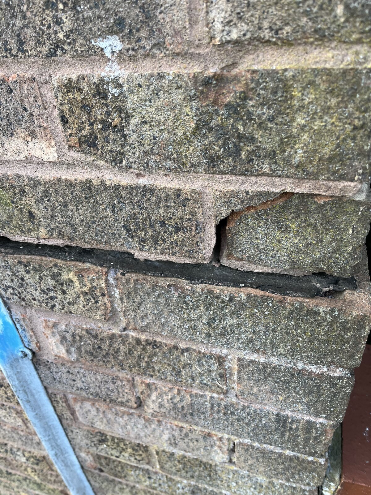

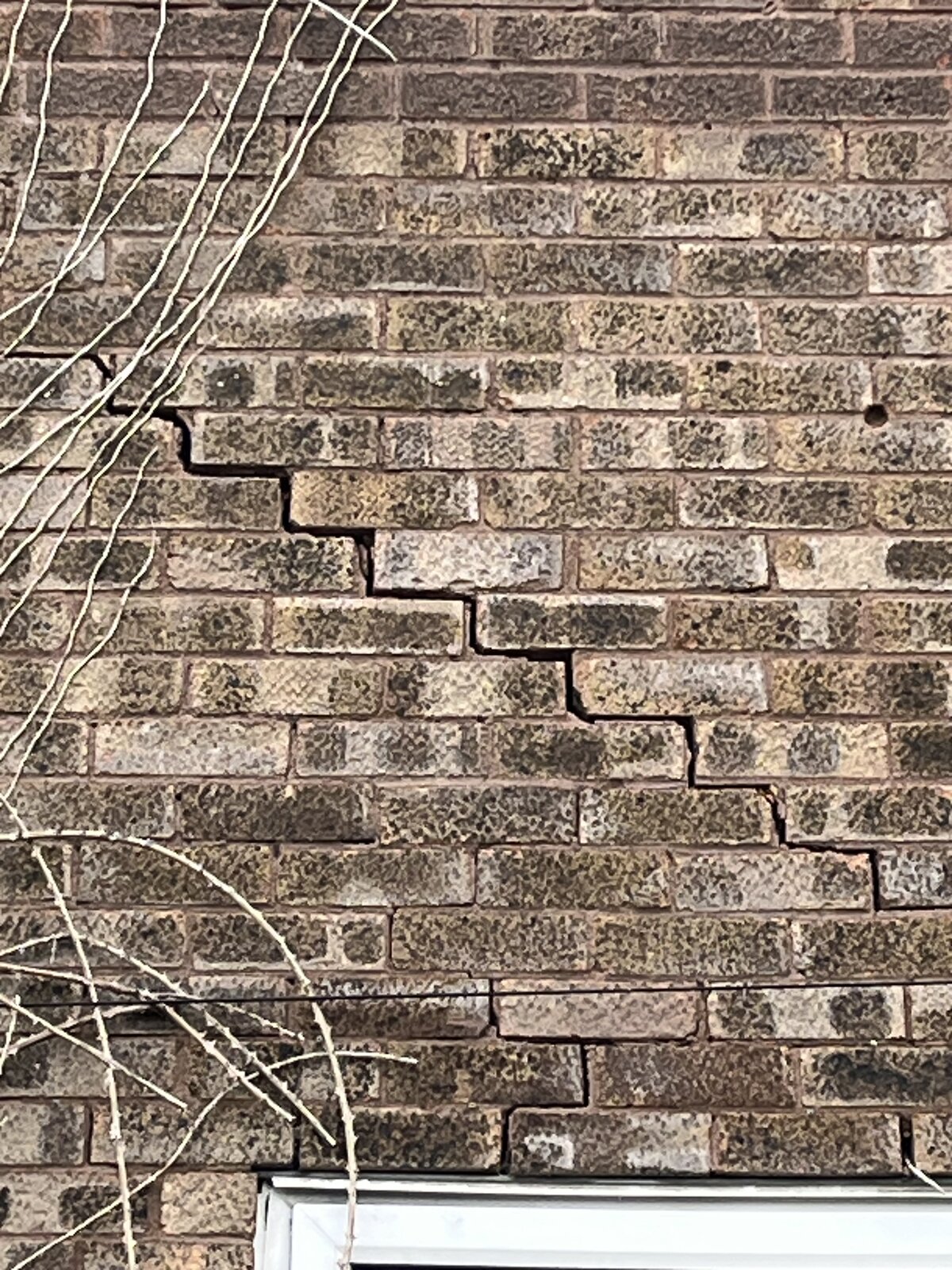

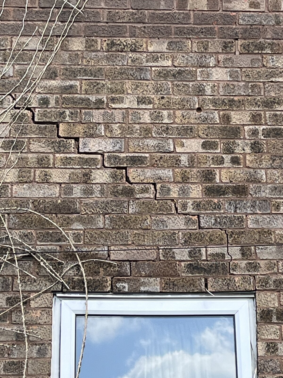

I know it’s hard by just seeing photos but I was hoping someone could give me a guide as to how bad what seems subsidence is. My housing association although markers have been out on the building will not comment on building

No. The crack starts from downstairs kitchen window upto my flat above

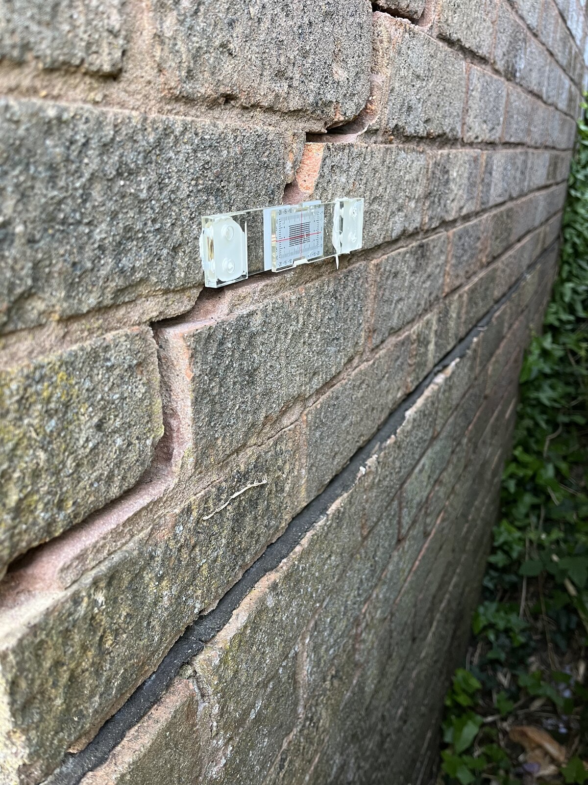

It must be a few weeks since plastic markers were fitted
The flats are housing association, but thank you for your help
I am a subsidence specialist, and this looks like subsidence

What makes you say its categorically subsidence, and not say lintel failure or another reason related to the construction method?
needs a picture from further back to see how the crack relates to the building -especially if the crack goes to the corner of the building
given the crack gets bigger towards the top might indicate subsidence
I would say the crack is large enough to need something done about it

That looks like cracking in several locations?
Is that cracking in the same place internally?
Where is the cracking in context of the rest of the wall - an image of the whole elevations would help.

Is someone coming out to record the crack gauge readings regularly? Is the gauge on every crack in different locations
Is a structural engineer involved or just a general technician from the association?

Thanks for your reply. We have had our local newspaper out this morning and have our local councillor involved. There are cracks all over the building apparently built on an old gravel pit and we are on top of a steep hill. The roof need replacing and windows
