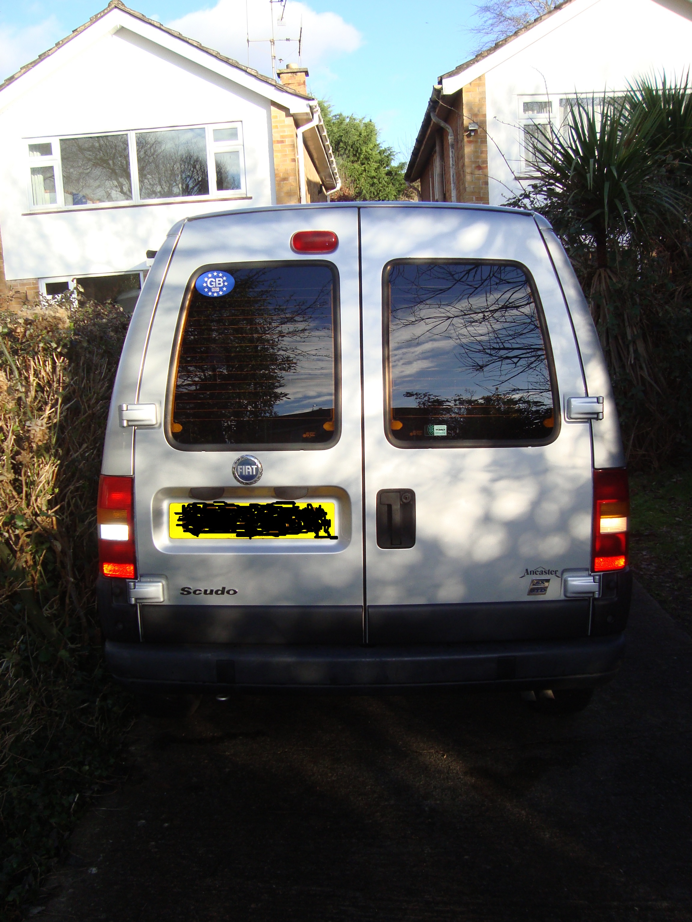

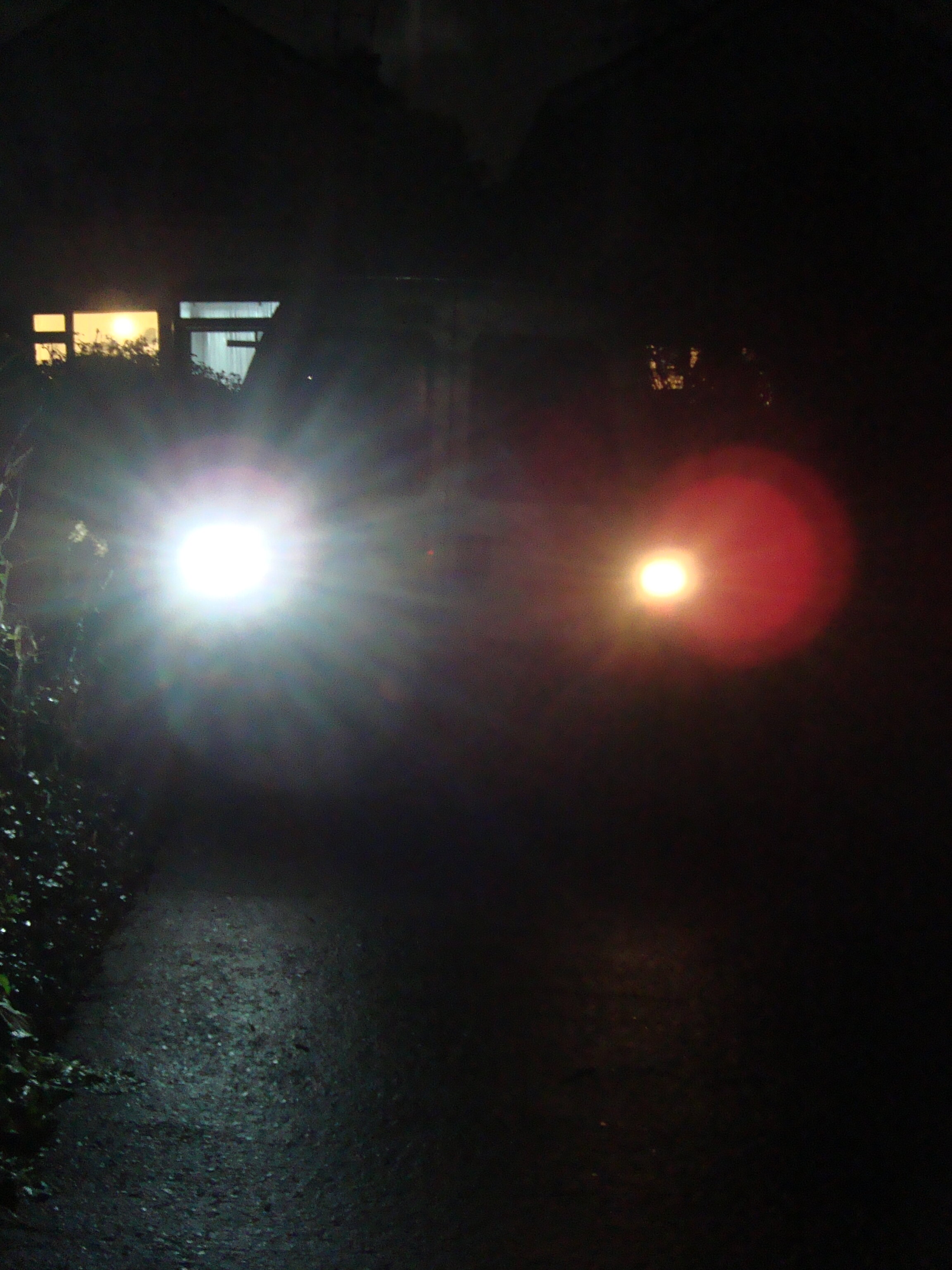

Suggestions For Brighter Reversing Bulbs

Thanks again, you saved me a bit of aggro. I cancelled the original order with Amazon and reordered the correct bulbs. Was too late to cancel, so they tried to deliver both cancelled and new orders yesterday. Refused the cancelled order and driver said would return it. Amazingly he actually spoke English. Anyway, saved me having to take to post office.
Will see how the new bulbs go and interested to see how long they last.
