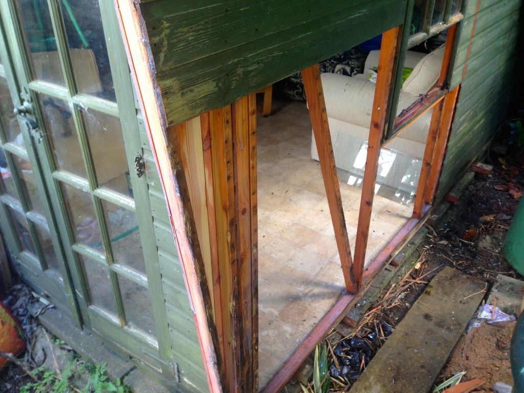

Summerhouse rotting in corner

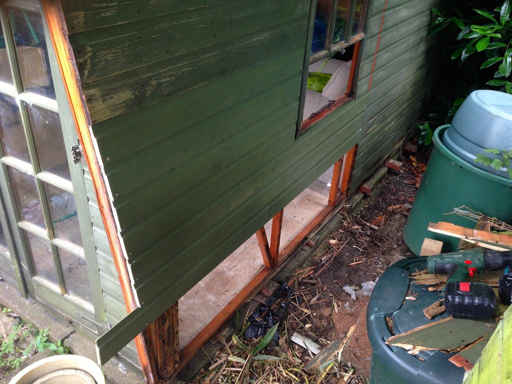

New panels purchased, though they are slightly thicker than the originals they still fit into each other just fine. Treated the new panels, then painted them...
Rotten panels removed and shed framework treated with preservative..
New panels positioned into place, then marked out and cut to size...
End cuts treated & painted, screw holes treated & painted, then screwed into place and the side of the shed given a lick of paint. Just need to repair the window and fit guttering which is what probably contributed to the rotted panels.

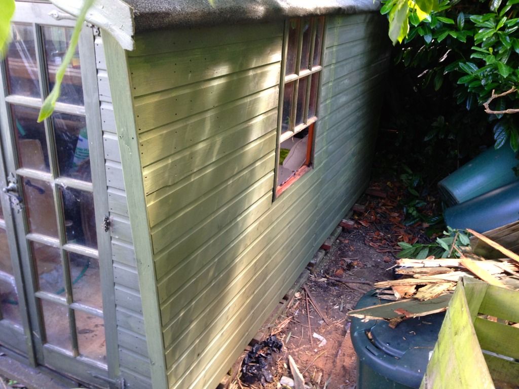

I couldn't find any shiplap to match the panels so was a bit stumped.
It was decided by the boss that major spending on this project was a waste as the masterplan involves replacing it within the next year or so.
so I repaired the rotting wood as best I could from the outside, using wood hardener, wood treatment and wood filler (the inside has had a second skin fitted ) Then on the affected section (which isn't really visable) I fitted treated and painted shed panels (vertically) which sit under the flashing.
Bit of a bodge but will do the job for a year or so.
