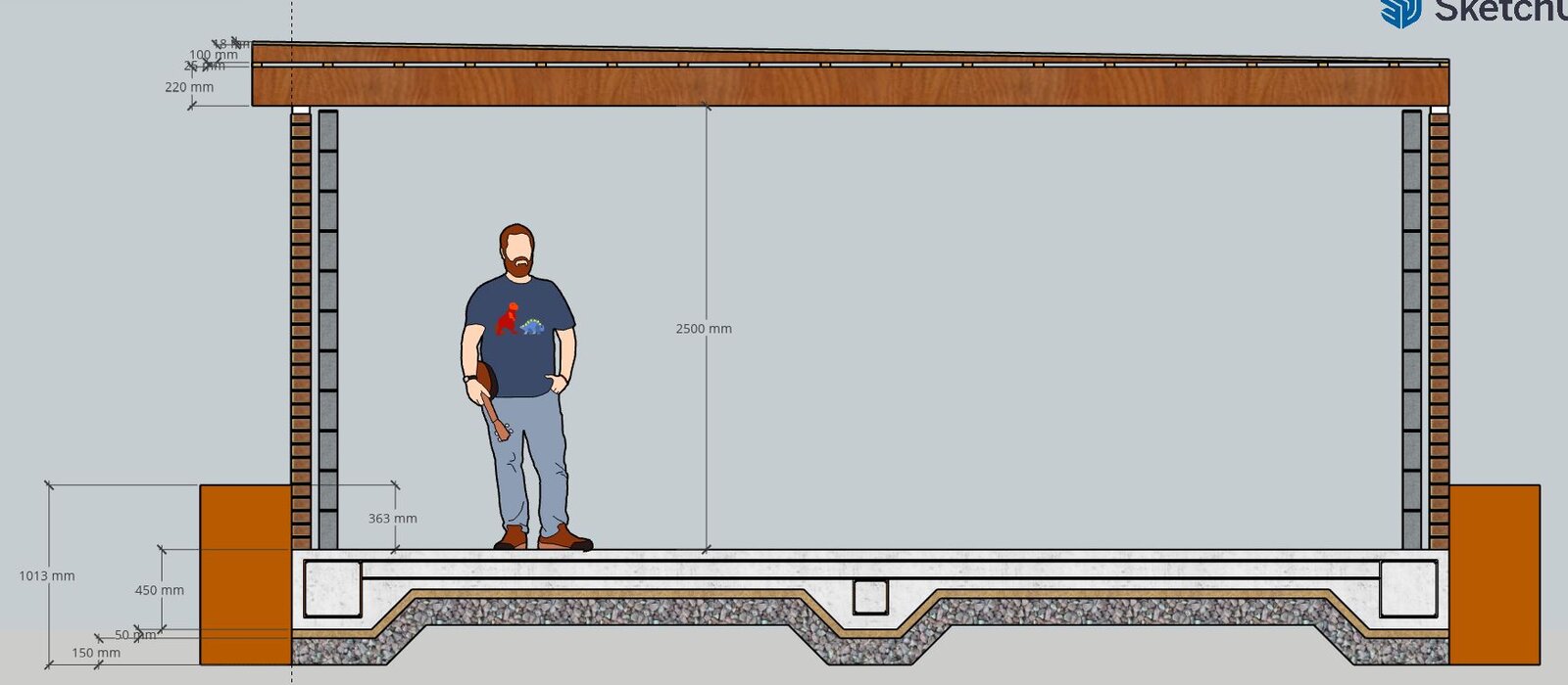

So im think the same... need internal floor about 300mm below external ground level.
understand the converns about damp etc, however due to soil (i mean clay!) conditions i am doing a RC raft with twin skin breeze/face brick construction.
With the right application of my DPM would i be right in thinking the damp ingress can be avoided?

its a combination of factors
1) i want 2.4m internal head height
2) the building is 5m x 6m so according to the span tables i will need 9 x 3 roof joist (can go for 5 x 2 but need to start messing about with RSJs etc)
2400mm head height height + 220mm joist + 25mm cross batten + 100mm firing + 25mm for 18mmOSB and roofing material
i wasnt going to insulate the floor as its just a gym, i will do the wall cavity and a cold roof. But if i wanted to insulate floor in future i could still put down some insulation + screed layer and have plenty of head height remaining.

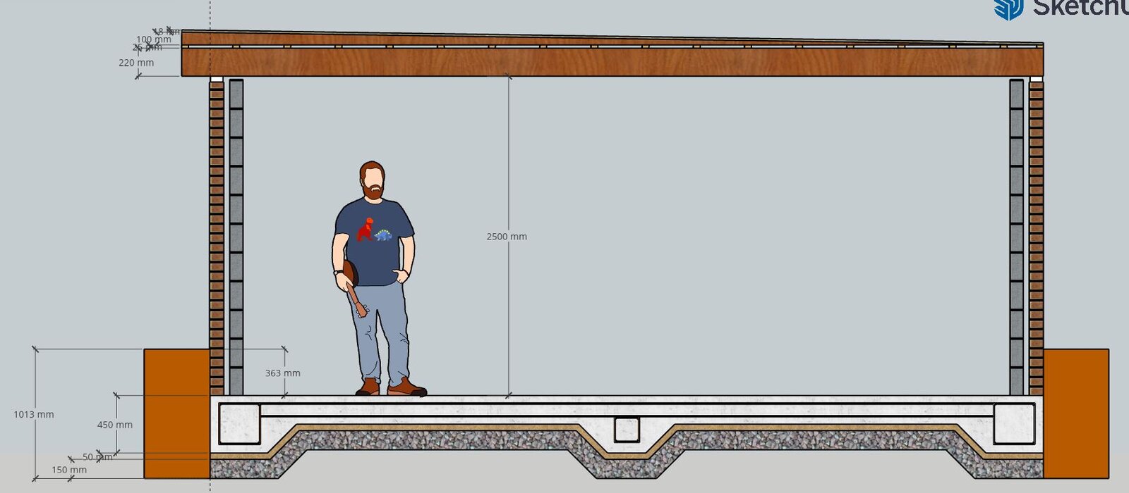

Just to clarify - this is what im currently thinking

On Craig's drawing 50mm could be lost straight off by pitching the roof from the middle so firring 0 to 50 to 0.
9x3 or a steel plus 5x2 is to me a no brainer!!
It is of course completely feasible to build a partly sunken building that is dry BUT it won't be cheap and it needs proper detailing. You would simply form a concrete tank to the required depth and bring the walls 150 above ground to sit your structure on. It would need external taanking and might need provision to resist flotation dependant on where ground water level is. The entrance would need thought.
