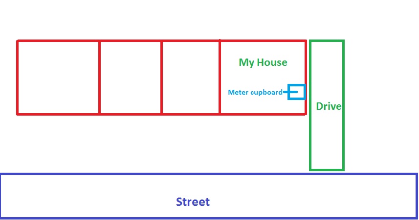

I'm surprised the dno are getting difficult, I thought the idea was always to connect every house directly to the supply cable, where are they planning to connect you? They can't connect you across anyone else's land. Consider a cu move or at least a cutout move to the front of the house.
The original earth was probably the water pipe. That was allowed in those days. But as soon as the cu was changed it was required to be brought up to standard. No earth is more like c1 than c3! Very dangerous.
Meter/CU cupboard is at the front of the house already, the wall immediately to the right (2 foot away) of the meter, on the other side of that is the closest corner of the house to the road.
All they'd have to do is lift a section of monoblock (however wide they need for a trench) maybe 10m up the drive and that's then the street right there, new cable comes through the wall and everything is right there?
But instead they're suggesting continuing on with this upgrading the same "looped" supply setup, running cables through lofts and down through halls and whatnot....
Just tell them you'd like to escalate it as you're not happy with their proposal. Make it clear you're happy to be reasonable regarding solutions, but you don't want cables coming down from above through other people's property. You just need them to back down before you do ;)

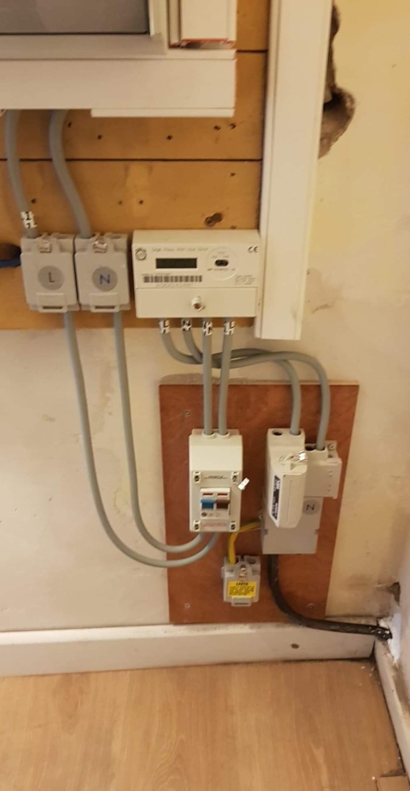

So that's the new supply been installed.
It's 100a and they kindly fitted the isolator I requested and also drilled an extra hole for me while they were there for the SWA for the outbuildings.
Looks like a nice tidy job...?

Not sure about tidy, interesting combination of meter boards, and i wouldn't have left those tails on the outside swinging so far from the wall. Could have dressed them in tight to reduce the chance of them getting snagged
Indeed - but, unless I'm missing something, the DNO's earth does not appear to be connected to anything. How is your installation earthed?
Kind Regards, John
Correct, they've advised that it's my responsibility to arrange an electrician to run the earth from the cutout to the consumer unit.
In reality I'll run 16mm2 to an additional earth block and take off from that to the consumer unit and also the armour of the SWA that's going to be running to the first outbuilding.
Correct, they've advised that it's my responsibility to arrange an electrician to run the earth from the cutout to the consumer unit. In reality I'll run 16mm2 to an additional earth block and take off from that to the consumer unit and also the armour of the SWA that's going to be running to the first outbuilding.
Fair enough, but you really should not be using the installation until that earth connection is installed - we earth installations for a (safety) reason!
Kind Regards, John
Kind Regards, John
I totally agree but it's taken them 5 months to do this work with constant pushing from me, we had no choice to use it in that time, it's just been installed this afternoon.
I'll connect up the earth myself tomorrow, I have the 16mm2 cable and the block already and can of course now safely isolate the supply.
You don't need an earth block, they have supplied one already. (Not to mention most cus have a set of earth terminals to use)
Better to avoid extra joints.
