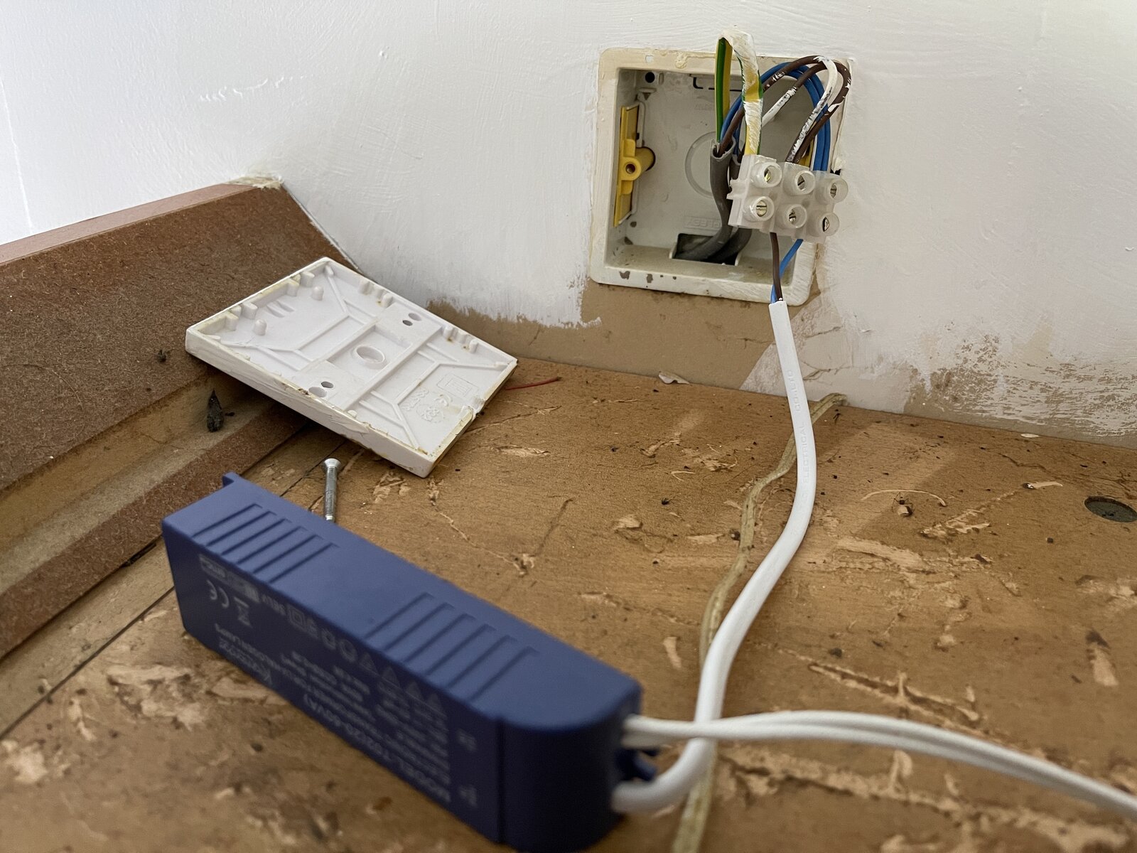

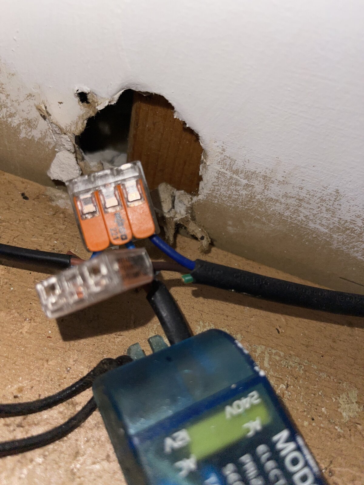

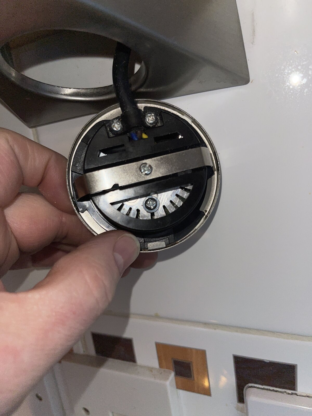

I am not an electrician and this is NOT my work. The under-cabinet light fitting is metal and plastic as can be seen in the first picture. There are live, neutral and earth wires clearly visible inside the fitting, however, at the other end, where the fitting is connected to the mains, the earth wire has been cut, ie. is not connected to anything.
This lot was left uncovered on top of the unit - second picture.

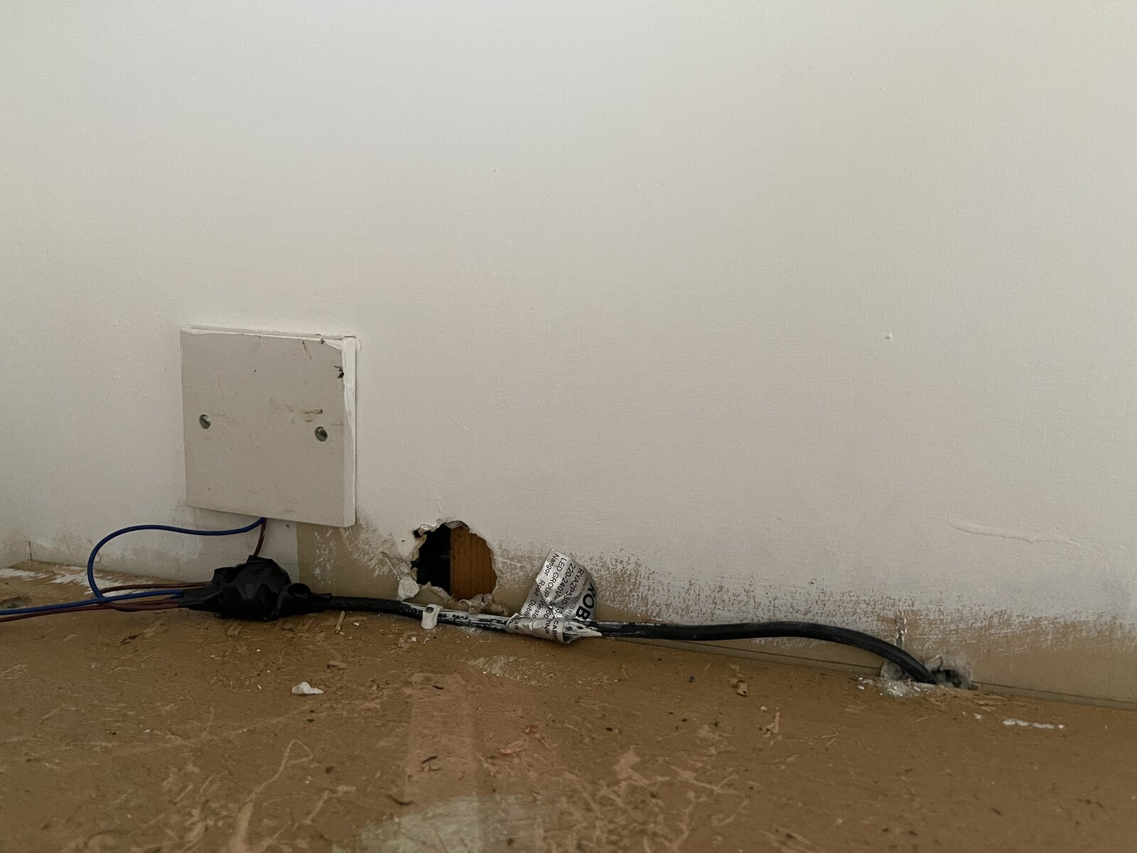

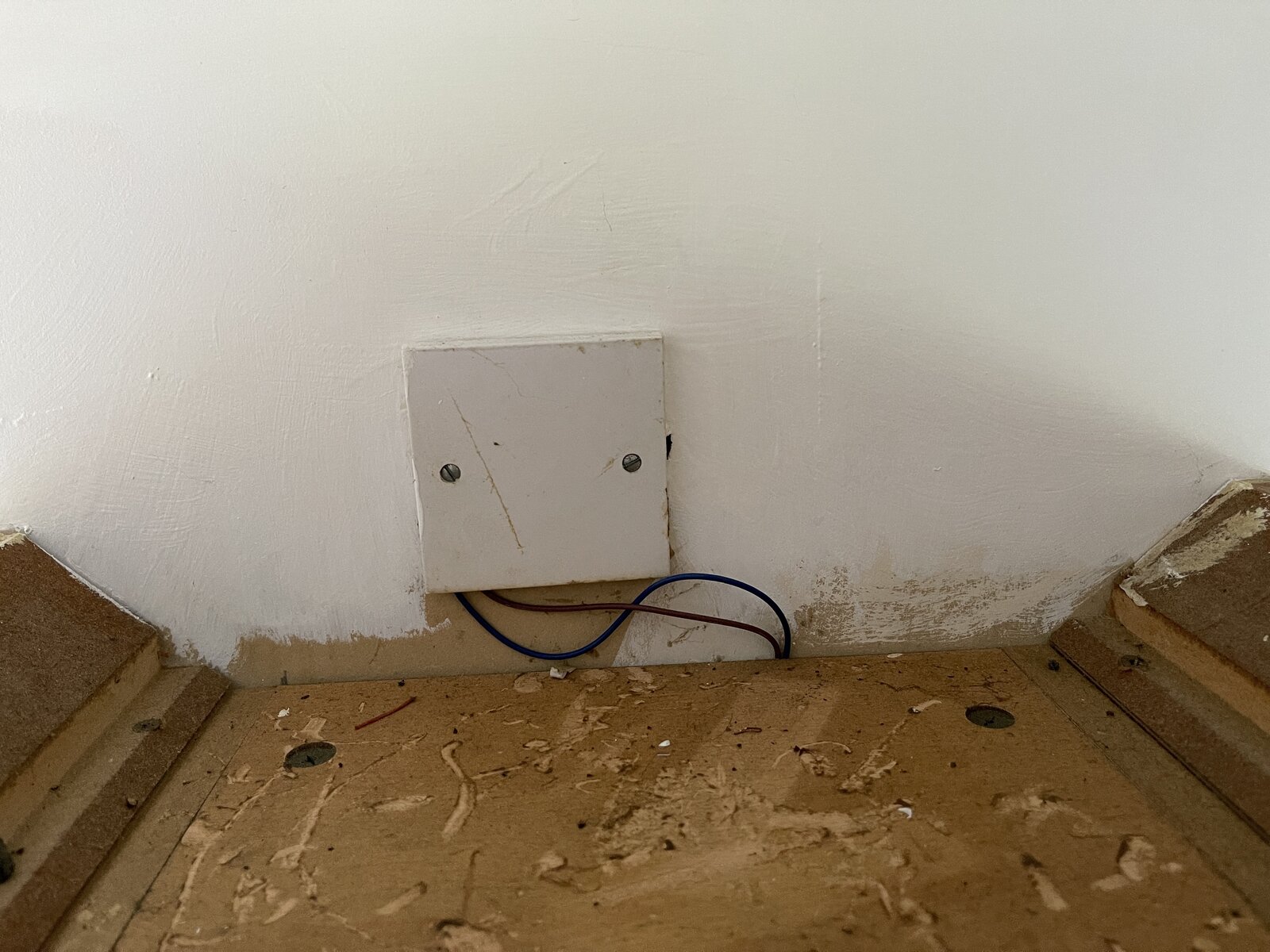

The final picture also shows terminal block lying exposed on top of another unit.
I’d appreciate thoughts and words of wisdom from any pros that may read this.
Thanks.

Its not clear from the pics but looks like double insulated transformers which do not need an earth connection and the lights and the cables back to the transformers run at 12 volt so do not need an earth to them.
Though technically the earth wires within the 240v mains cables should be connected even if not used.
The 240v mains cables and the output connections to the lights even though 12 volt, should really be in an enclosure.
It looked to me like the light in the picture was tapped off the mains side, and the transformer was for another light.
Either way though, it needs cleaning up, anything that needs an earth needs to get one and all mains connections need to be in suitable enclosures.

That’s a Robus Commodore LED under cabinet kitchen light. Yes they do need to be earthed, whoever installed it was not an electrician, those connections can’t be left exposed on the top of the cabinet either.

Document with photos, and call your landlord to sort. A Class I fitting with no earth is not acceptable.
