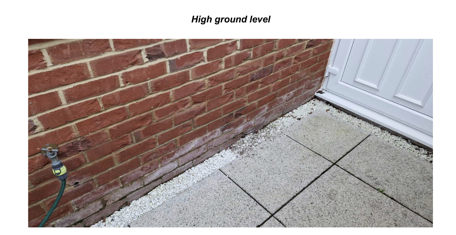

I am in a process of purchasing a semi-detached property built in 2017. I've requested a survey which has come back mostly ok, however it has highlighted some potential issues which I would like to get perspective on.

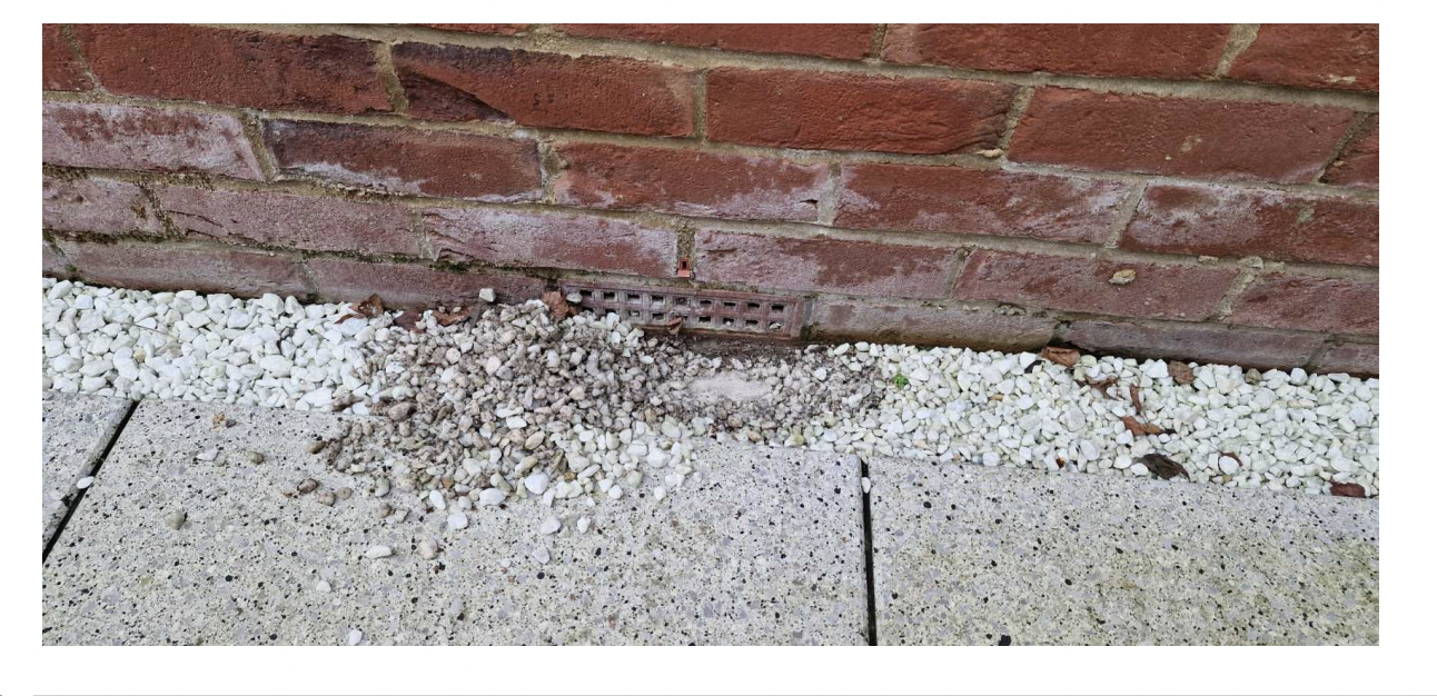

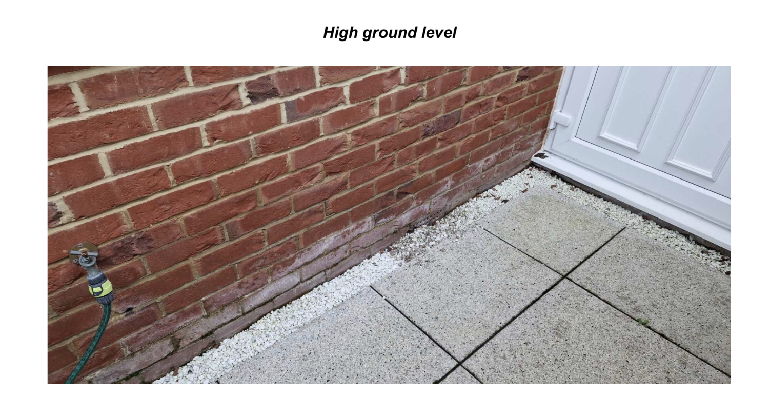

1. The ground level beyond the loose gravel finish and the damp proof course (DPC) is not greater than 150mm that is usually recommended.

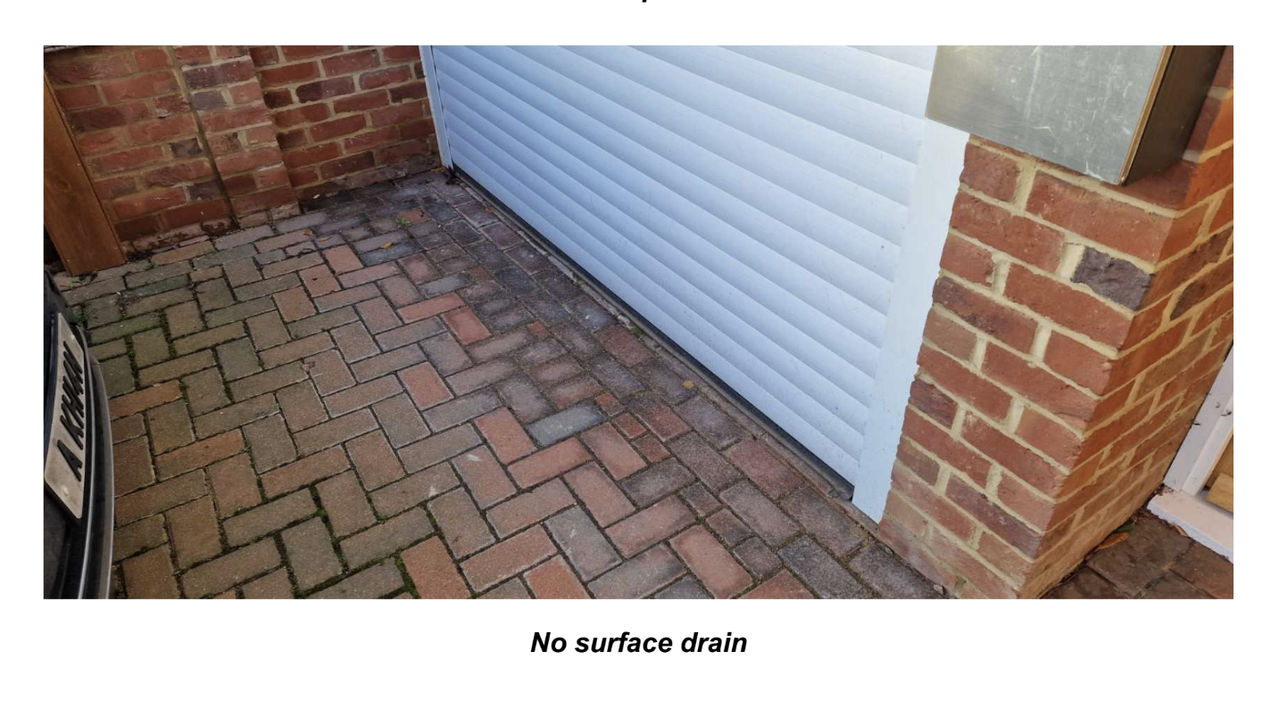

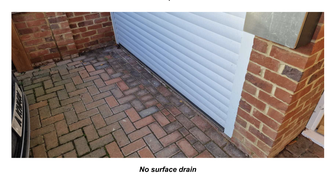

2. The driver to the front is sloping towards the house. The ACO drain was not installed so water accumulates in-front of the garage.

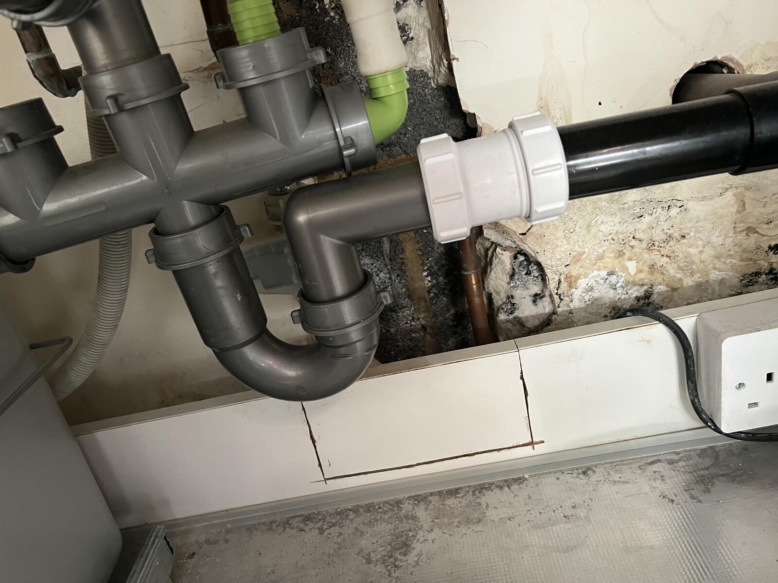

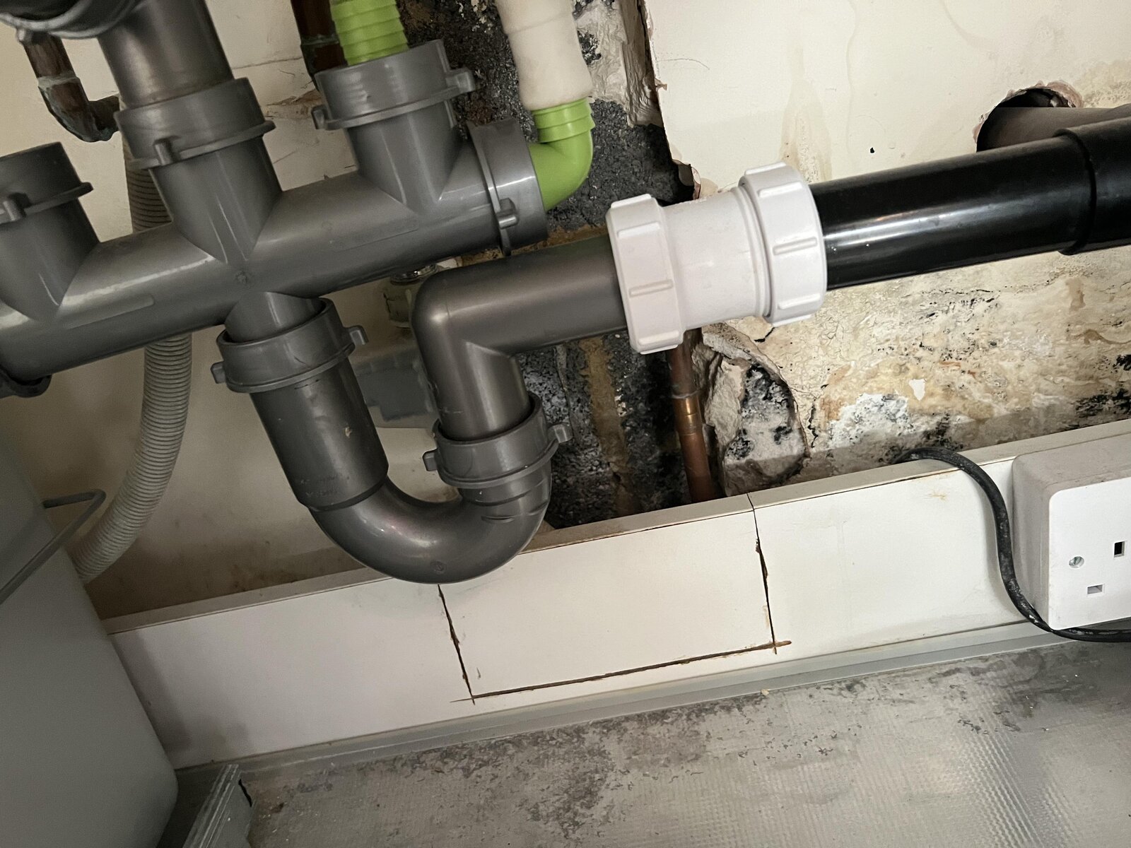

3. There is mold issue under the kitchen sink. Not sure if this is from an old leaking pipe or outside. Need a plumber to investigate.

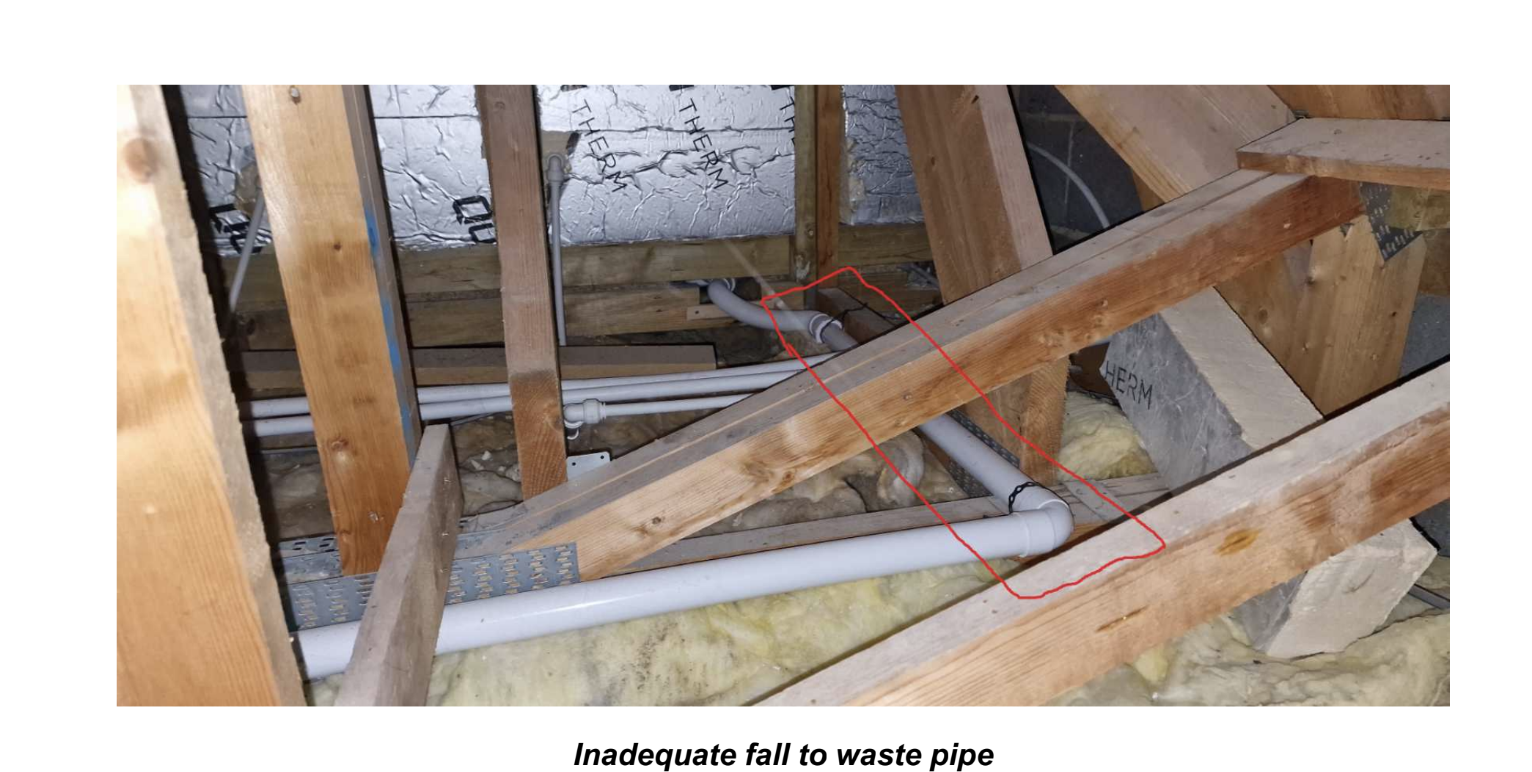

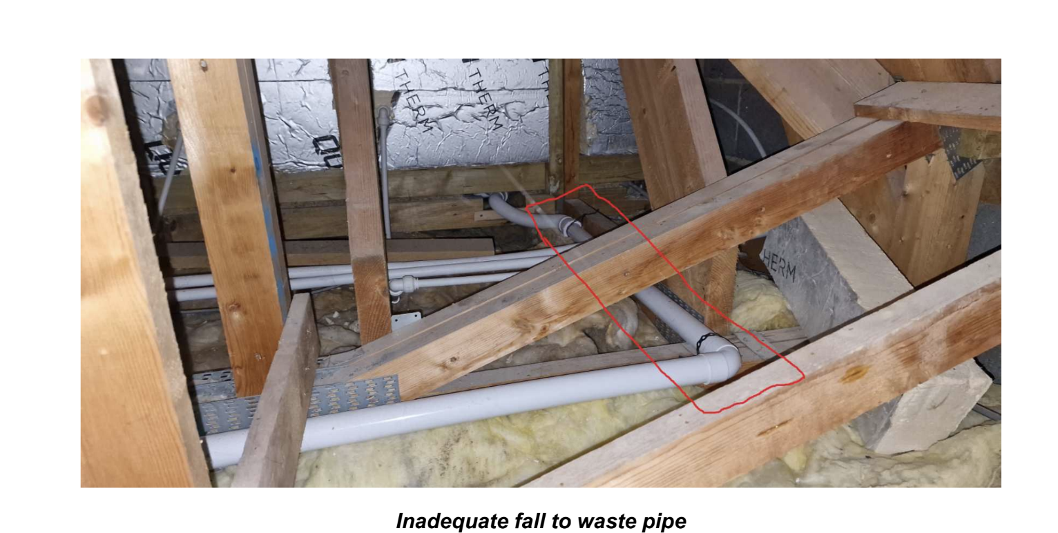

4. Another problem is that there is inadequate fall for one of the waste-pipes. Again will need a plumber to see and quote for the job but should i test the system to see if there is any back sewage.

I'd say all fairly minor issues. The >150mm ground level is due to the fact that the ground has been raised compared to the original.

If they have not written subsidence or foundation issue, I would say your covered there in absence of any other signs. DPC breach by soil / ground being too high won't directly impact wall foundations. Looks like there is a suspended floor the other side of the entrance path wall, as there is a subfloor airbrick in place?
The high ground level and damp under kitchen sink may be the harder of the item raised to resolve but does depend on what is causing the problem in kitchen and how practical it would be to have a 150mm lower entrance path compared to what is there now. If it is not linked to the damp wall issue you could probably ignore it or hold on and monitor it.
However, it is possible there maybe a linkeage to the damp on the kitchen wall under sink and the high ground level. Is that area near the front door, with a outside tap, the near the kitchen sink wall? or nearby? The marking on the wall does show some water splash / soaking above the DPC line and maybe some salts residue. Although, on a cavity wall that shouldn't necessarily = damp on inside wall, but could cause the issue if the other circumstances support it.
The drainage channel requirement in front of garage shouldn't be too hard to deal with. Get a builder to quote or you could take a guess as to what it would cost. A lot will depend on availability of nearby drain and how much re-instatement is therefore required.
I spoke with agent who spoke with the owner, the cooper pipe apparently leads to the outside tap (seen in the pictures) there was a slow leak for an extended period of time which was fixed 10 months ago. The concern is that it might have been leaking for a long time before it was detected and fixed.
I am getting the quotes for remedial works and will revert back.
90% of the population will likely find BS mould at the back of their kitchen sink.
Do you know this property is as it was built ? Under sink would appear to have new pipework ( cheap ikea type cr*p ) that would not have been installed in a new property .
Check with seller to see if any work was done after the build .

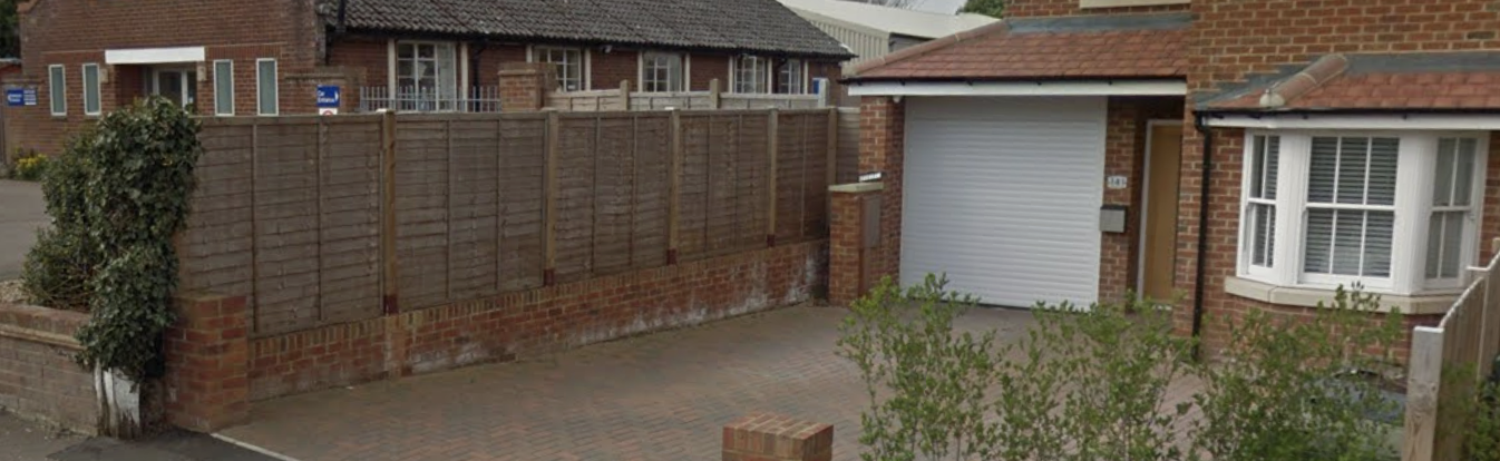

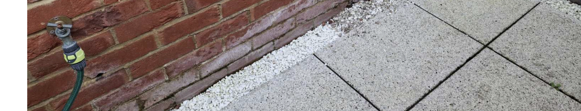

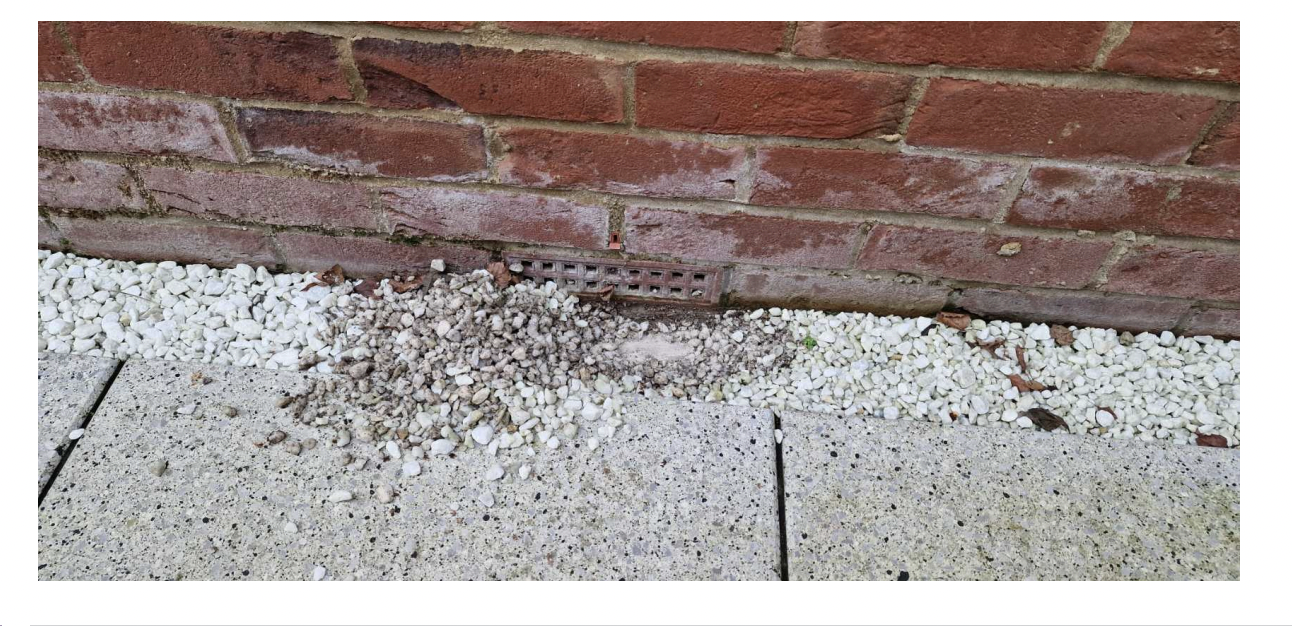

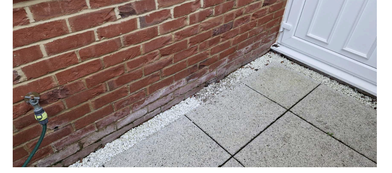

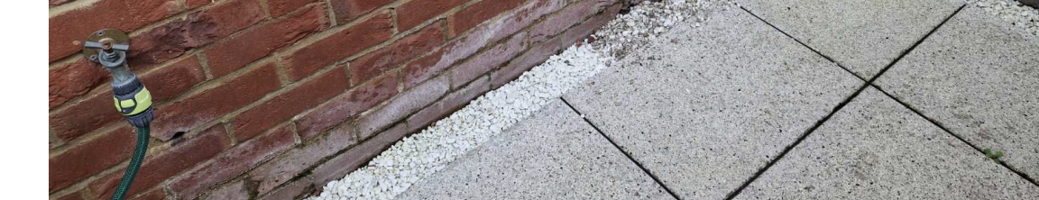

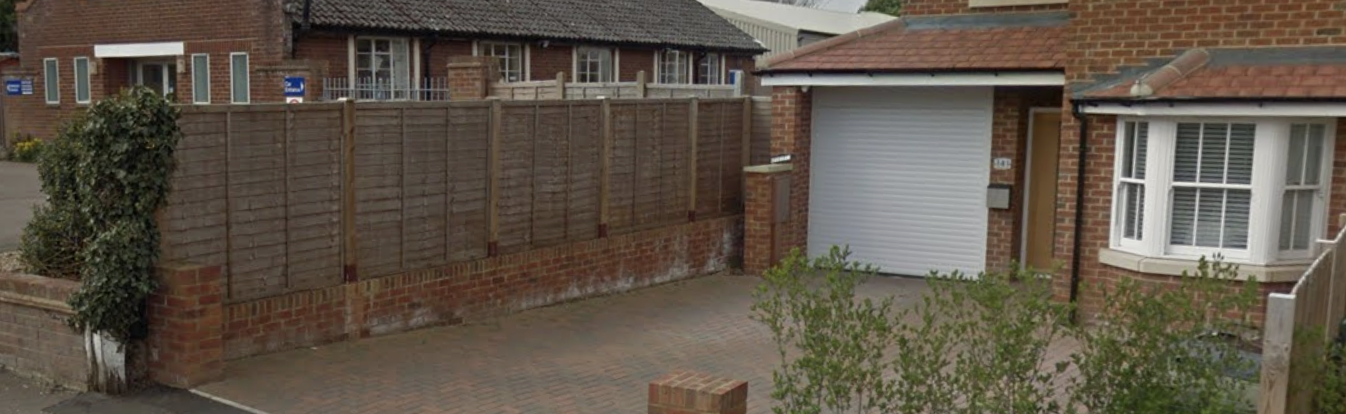

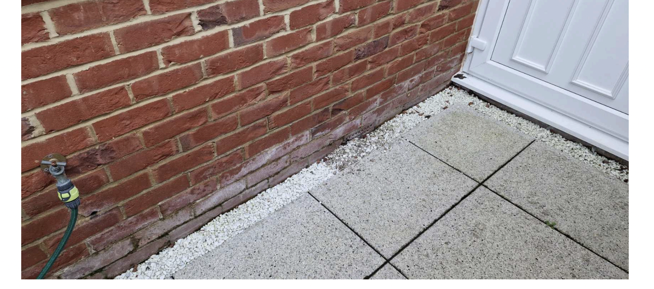

1. In both the report and on the pictures (below Google Street picture from 3 years ago) there is clear signs of efflorescence on the base of the property. I suspect this has to do with two reasons - 1. Property being relatively newer so drying out initially, 2. Escape of water which I mentioned below (e.g. ground being higher than 150mm above DPC and the lack of surface drainage in the driveway).
Both issues I will look to address, but is there anything else to suspect or worth investigating? The surveyor did not find. note any significant damp (except near the light wall in the garage) inside.

The efflorescence at the base of the wall does not look anything like drying-out new brickwork. It looks like a water leak.
