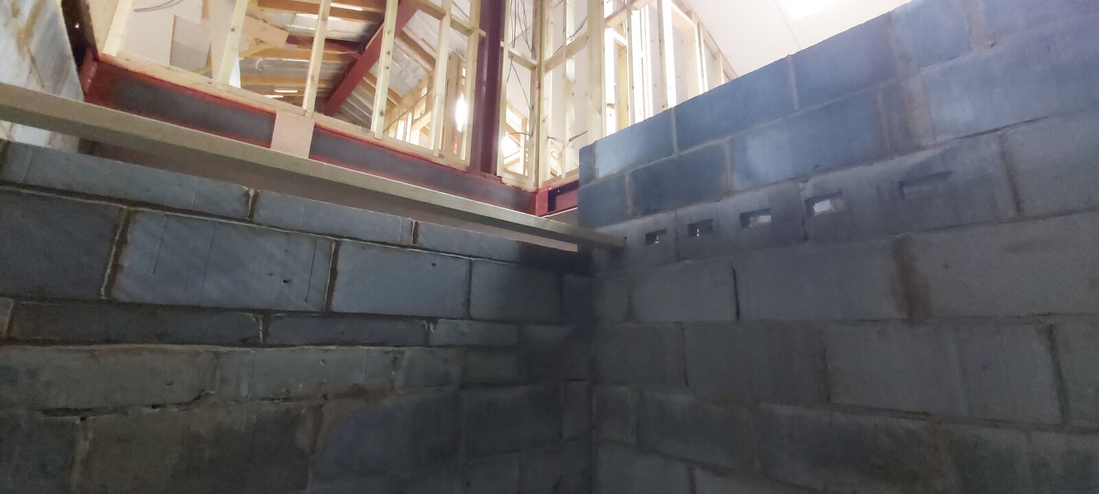

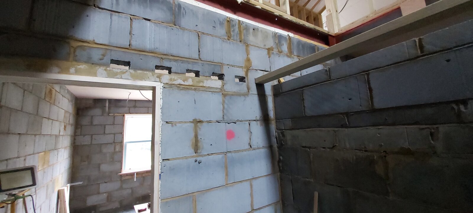

I am building a suspended ceiling over a small bathroom. I have opened pigeon holes on opposing walls to fit C24 4x2 joists laid on their flat side, not on their edge. The clear span is 1800mm and the bearing into the walls is 95mm. I have spaced the 4x2s 195mm apart (100mm gaps between joists). The floor above will be either 18mm or 25mm ply.
Could someone please tell me if I have enough support for the floor above, or better what is the permissible load?
PS I could replace one joist with a concrete lintel if needs be.

So it seems I need to strengthen it a bit, here are some photos.
I could replace the first 4x2 with a concrete 65x100 lintel, that would hold the edge of the platform and on the other side there is a wall we are sitting on...

So the platform is the quarter landing of a staircase? or it supports a quarter landing of a staircase?
I think it supports the landing, I will finish in 18mm or 25mm ply. The staircase man will add a 25mm-32mm "redwood" or some other material on it. I think on one side, that which is over the door as in the photo, it will be my platform taking the load.
So you'll have 2 inch of joist, 1 inch of board, and 1.5 inches of board again..
And you're striving for minimal height build up, but really, if you turned the 4x2 the other way and ditched the board you were going to fit, and fit the board the stair man will fit, your buildup is just one inch higher, and significantly stronger
Do you really need that inch? I mean, really?
No, you are right. And the 4x2 on its edge will be stronger. I am going on site now to take a look.
I pulled myself up on that single 4x2 on the photo, and yes it flexes I'd say 10mm at least, I am 83.5kg. But it is a C16, tomorrow I am getting some C24 to see what difference it might make.
