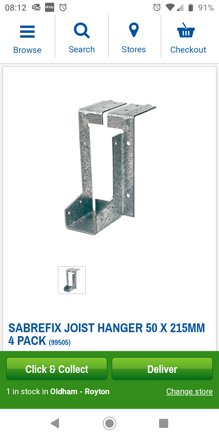

I also favour the masonry joist hangers, but wouldn't bother messing about with resin. Something like these:
Sit them on top of the brick and screw and plug from the front through a couple of the 4 holes provided. Drill a few holes in the mortar with a thin masonry bit to form a slot and tap the hangar in.
Nice idea, don't forget to pack the slot with dry mix mortar afterwards to avoid any void
No, the idea is that you fill the slot with resin mortar before you insert the hanger, then there are no voids when you have finished. You don't quite fill the slot because when you push the hanger in it will expel a little grout and it's just wasteful. And resin mortar isn't free.
No need for dry mix packing, and nowhere to pack it anyway, because the slot is full of resin mortar and hanger.
