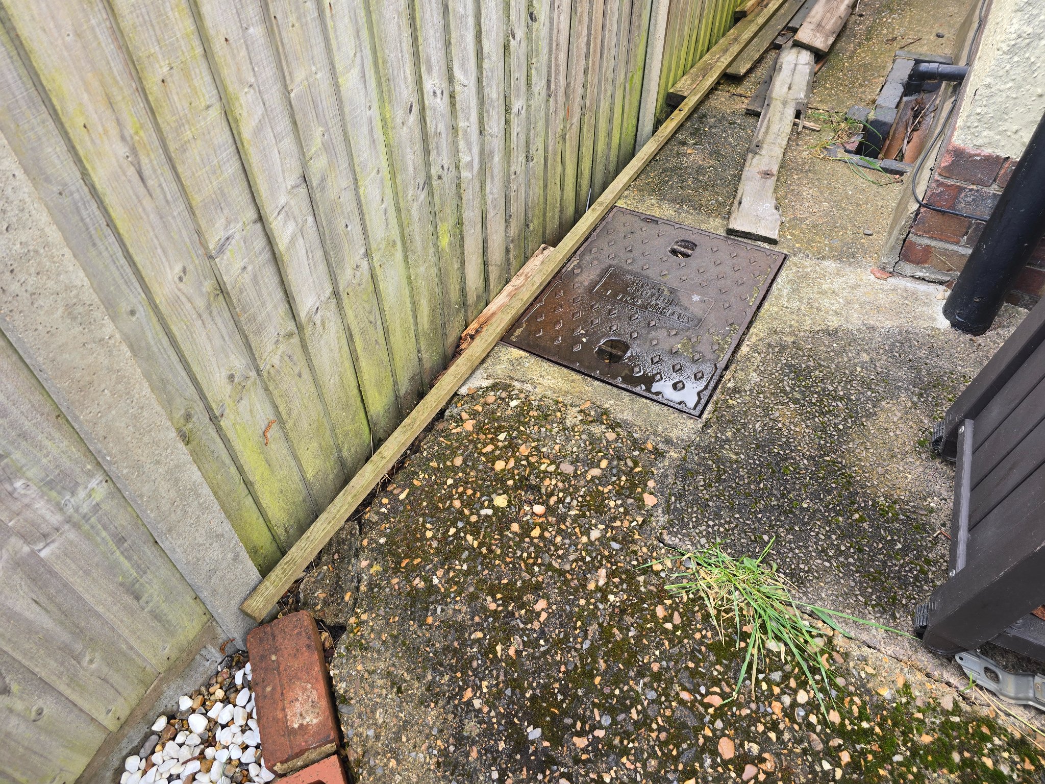

If you can clip it to the wall under the render as far as the corner it will be a lot easier to then cut a channel acoss the concrete with an angle grinder to the fence and break it out with an SDS chisel. If you are going to fix it along the base of the fence then the exit won't need to be square and the angle grinder should give a nice curve to bring the cable up. But it should not be too difficult to bury it a reasonable depth behind the shrubs.
Ok, that's interesting, thanks. to make sure I'm picturing this right, do you mean corner of the house towards the back garden? and is keeping it as low down as the render to make sure it goes under the door?
As its 16mm, its got quite wide bend radius.
Attached a pic that shows the bottom corner of the house next to the fence in question.

Yes that corner.
I meant under the render for aesthetic reasons, it won't look as obvious.
It might also be worth looking inside the inspection chamber of the drains and see if it's viable that you can simply drill a sloping hole at the end of the channel through the side of it below the frame of the lid and than clip it inside around the side of the chamber and come out again along the fencee line via another hole. To be honest I am am not sure if there are any regs preventing that but hopefully someone more knowledgable will tell you if there is.
Just a suggestion but it would save channelling as much concreteif that is difficult for you.
Thanks, thats an interesting idea, I'll look into that. Turns out the simple answer of channeling out a bit of the concrete is a no go, as the space is too small. I could lift the fence is guess?
