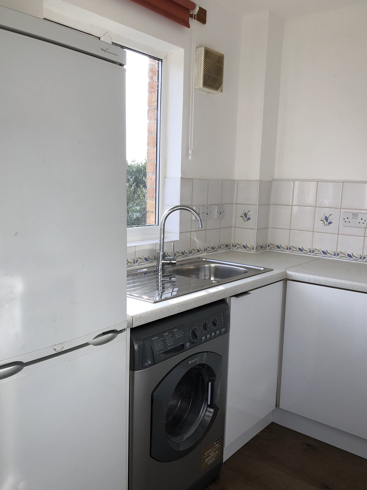

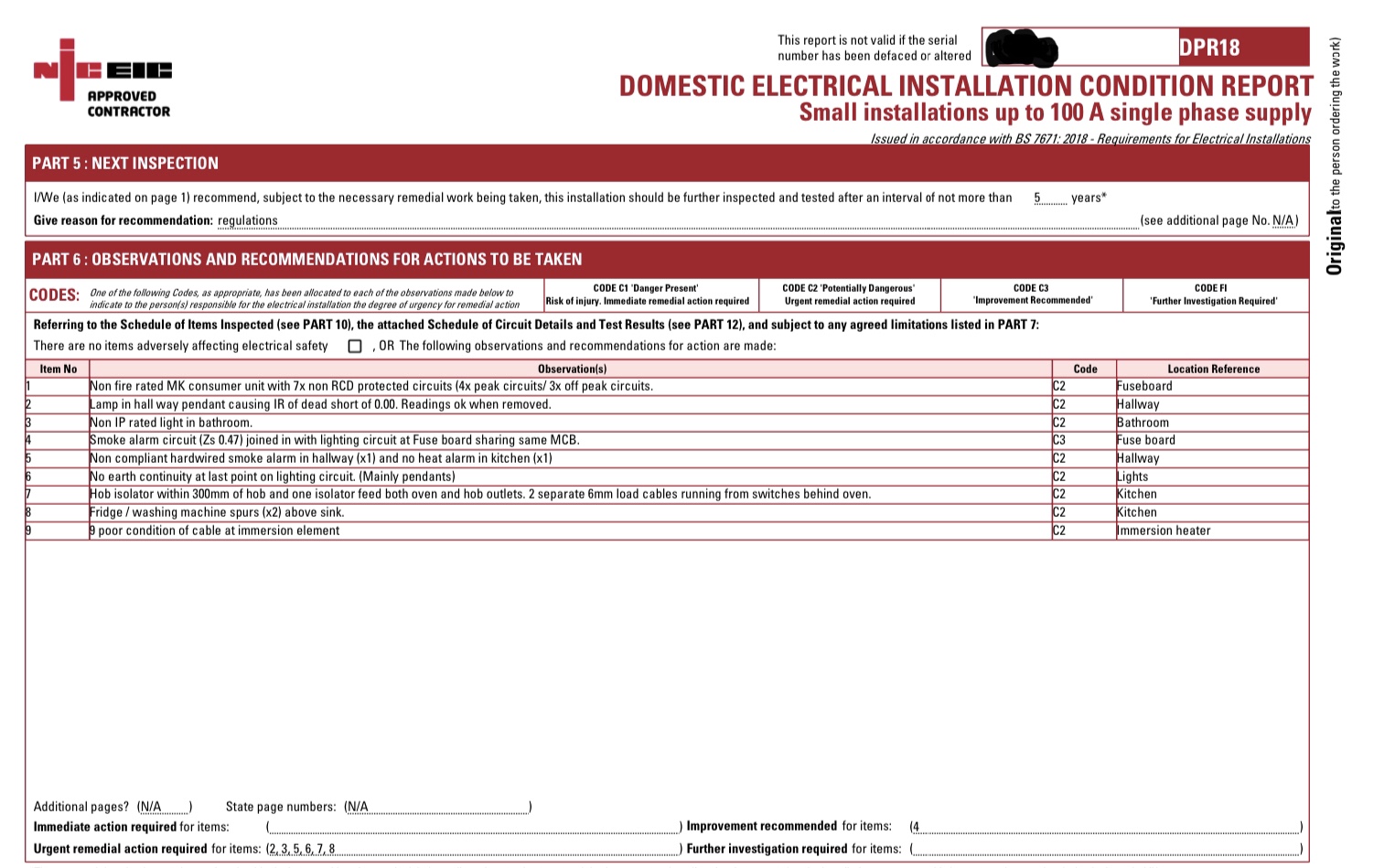

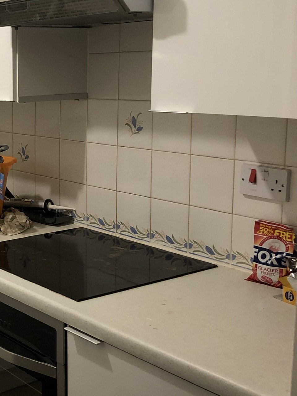

Can anyone advice how you measure the 300mm from sink/cooker to isolation switch? I have a failure from a condition report that states the isolation switches are too close. It’s odd as the property was built in 1995 and one assumes it was properly signed off. I’ve also had previous checks done without issue. I’m not bothered about rework but don’t want unnecessary blanking and trunking.

What regulation is quoted for the ‘failure’. There are no quoted distances in the wiring regulations!
Best practice is 300mm minimum but I have fitted them less than that before, sometimes there isn’t another option.

Condition report for rental.

As said, there is no such regulation. As suggested, I would suggest that you challenge them to tell you what regulation has been violated and then, when they can't, if that is the only reason for the 'fail', ask them to issue a revised, 'pass', report.

That's strictly true (although most would quote the relevant reg number on the EICR). However, even when reg numbers are not mentioned, the "issues detailed" have to be consistent with:
Notes for the Person Producing the Report in Appendix 6 of BS7671 said:
Only damage, deterioration, defects, dangerous conditions and non-compliance with the requirements of the Regulations, which may give rise to danger, should be recorded.
... and, if challenged, the main way in which an inspector could attempt to justify 'an issue which he/she had detailed' would be by citing a regulation of BS7671 which had been violated.
@JohnW2 its fine if I can find someone who disagrees. But I’m not sure I can.
I'm not sure what sort of 'someone' you had in mind, but I very much doubt that you'll find anyone in this forum who will agree with many, if any, of those C2 codes!
It is, in my opinion, quite ridiculous.

Most don't quote Regulation numbers. In fact you are explicitly told that you're not supposed to.
Regulation numbers are meaningless for those reading the report.
No offence but where I’m coming from the someone needs to be a qualified person able to issue a compliance report.
if the general consensus is this is a try on I’ll get another report done.
quote is 800 + vat to “fix”.
i would go back to the electrician and ask him to provide some back up for his codings. I assume he is quoting for the ‘remedial’ work
... and/or, given that at least some of those C2s are, to say the least, very questionable, one might wave a copy of the EICR at NICEIC 'for their comment'!
