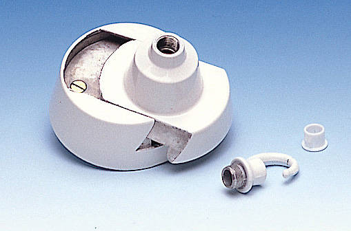

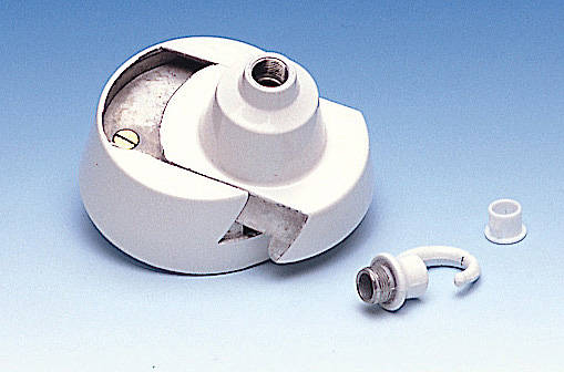

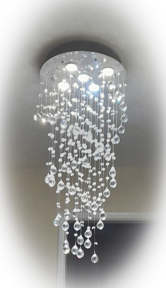

The ceiling rose is designed to run the supply rose to rose, but when we use lamps designed for other countries often these don't have the terminals required, I used a plug in ceiling rose, so changing a chandelier is wired on the ground, Ceiling rose.jpg then simply plugged in. No holding a lamp up in the air while wiring it, so I never have reason to open the base of ceiling rose. As to electronic switches, the dimmer switch can't adjust colour any more, dimming a tungsten bulb also produced a red glow, not so with LED, so using smart bulbs works better allowing the colour to also be changed so giving a better ambiance. Using however a 8 bulb chandelier this gets expensive, 20220415_000328_1.jpg but the whole reason for it is to get the light required in a large room, so don't really want to dim, so use a simple on/off smart switch battery powered so does not need a neutral (TP-Link/Tapo) in other rooms I have used Energenie/MiHome switches which pass a small current through the bulb when off, have had a shimmer and bulb glowing when switched off, and of 5 fitted 3 have failed in 8 years, so have been moving over, but the new switches only a year old, so time will tell.

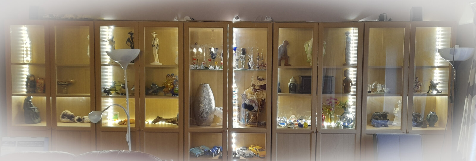

Smart switching can be three main locations, in the bulb, in the lamp (smart relay) and in the switch, I have all three, this lamp lamp-landing_1.jpgused a smart relay inside the lamp so I can select either centre or outer bulbs, the centre one is colour changing smart bulb, at rewire stage there is nothing stopping one from having multi-lamps in a room independently switched seen it first in Turkey, where they use CFL well before us, tungsten produces too much heat, and you could not dim CFL bulbs, so they split the lights 1/3 and 2/3 so one has three levels of lighting, be it wall lights or ceiling lights, one can arrange the lights so it does not look as if bulbs have blown, I have had to work with what I have, no where near rewire stage, so used cabinet lights to supplement living room lighting. When turned up full 20230227_163006_2.jpg there is around 60 watt of lighting there, but normally turned down 20230227_170703_1.jpg and set to some colour to enhance the display.

The ceiling rose is designed to run the supply rose to rose, but when we use lamps designed for other countries often these don't have the terminals required, I used a plug in ceiling rose, so changing a chandelier is wired on the ground, View attachment 336370 then simply plugged in. No holding a lamp up in the air while wiring it, so I never have reason to open the base of ceiling rose. As to electronic switches, the dimmer switch can't adjust colour any more, dimming a tungsten bulb also produced a red glow, not so with LED, so using smart bulbs works better allowing the colour to also be changed so giving a better ambiance. Using however a 8 bulb chandelier this gets expensive, View attachment 336373 but the whole reason for it is to get the light required in a large room, so don't really want to dim, so use a simple on/off smart switch battery powered so does not need a neutral (TP-Link/Tapo) in other rooms I have used Energenie/MiHome switches which pass a small current through the bulb when off, have had a shimmer and bulb glowing when switched off, and of 5 fitted 3 have failed in 8 years, so have been moving over, but the new switches only a year old, so time will tell.
