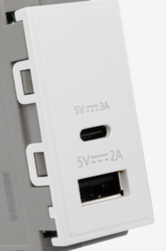

There are single width USB charger modules.
So the full list would be something like
CMA31102 - double plate two module Euro plus two module gridpro
MM586WH - USB charger Euro module
MM047WH - 13A fuse Euro module
GM2018PW - Gridpro 20A DP switch module.
GM2017PW - Gridpro flex outlet module.

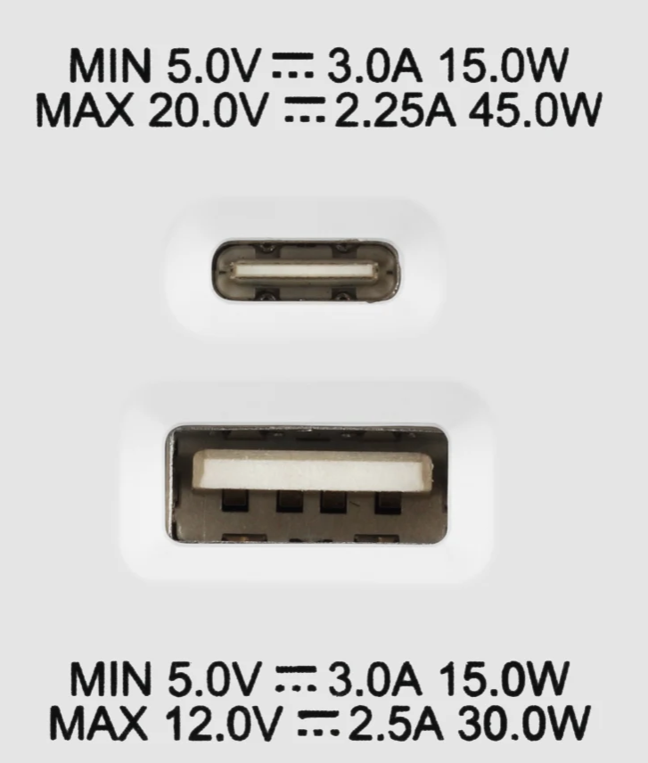

Seriously off the pace these days for USB chargers
vs
Quite a while ago we had a lengthy chat on if a USB charge socket was even permitted in a bathroom. Can’t remember the outcome, but even though its output is 5v - if it’s inside zone - then it has to be a SELV supply.
Can’t see that mentioned in the docs.
