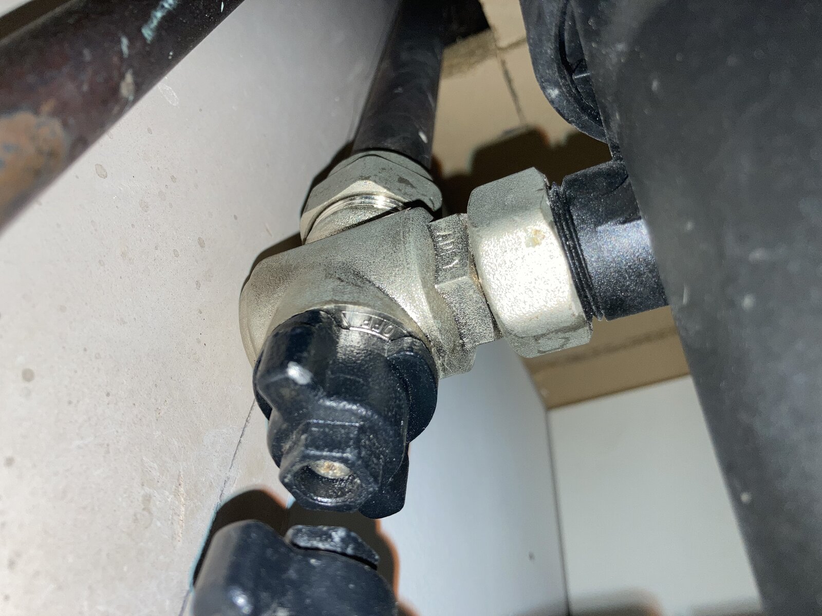

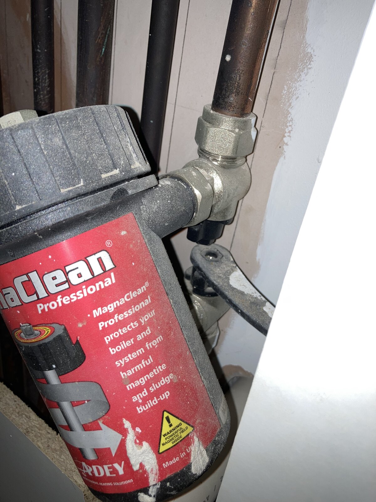

I am trying to put some central heating leak sealer into a magnaclean.
Unfortunately the magnaclean is in the very corner of a corner cupboard, I’m having to lay on my back and twist myself under the sink trap and have a very narrow space to work in.

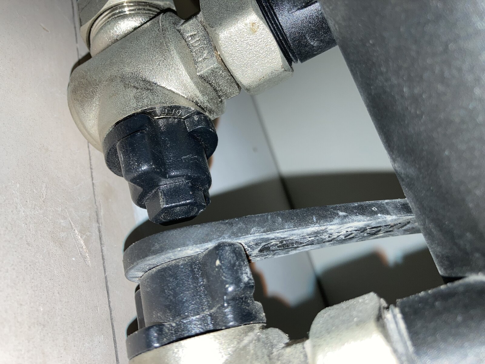

After much trial and error I realise there is off written on the valves but I’m pointing the 2 black handles to that direction yet there is still water flow when I’m trying to remove the magnaclean.
One attempt I tried undoing the top nut and water was spirting out and scared me, another time I twisted the main magnaflow loose a little and it was spirting out.
Does the black knob need to be pointing directly at the off? I’ve probably gone round a rotation or 2 clockwise, will this matter? And to ensure I don’t cause a massive flood which would be the safer way to see the valves are off to loosen the top nut or to twist the main magnaclean a little?

Your first and third photos show the valve in its OFF position, but if the plastic head is loose on its drive dog then the valve will still be open. You need both valves shut to isolate the Magnaclean body.
It doesn't matter how many revolutions you've made.
Try opening both, then run the pump. There will be a noticeable woosh when one valve is nearly closed. Note its position, open it, and repeat on the second valve; then place both valves just beyond their respective woosh position. Open the bleed key on the top to see if you have been successful; if you have the water will soon stop.

Yes the markers need to be exactly at off, as they are ball valves they need to be closed properly.
