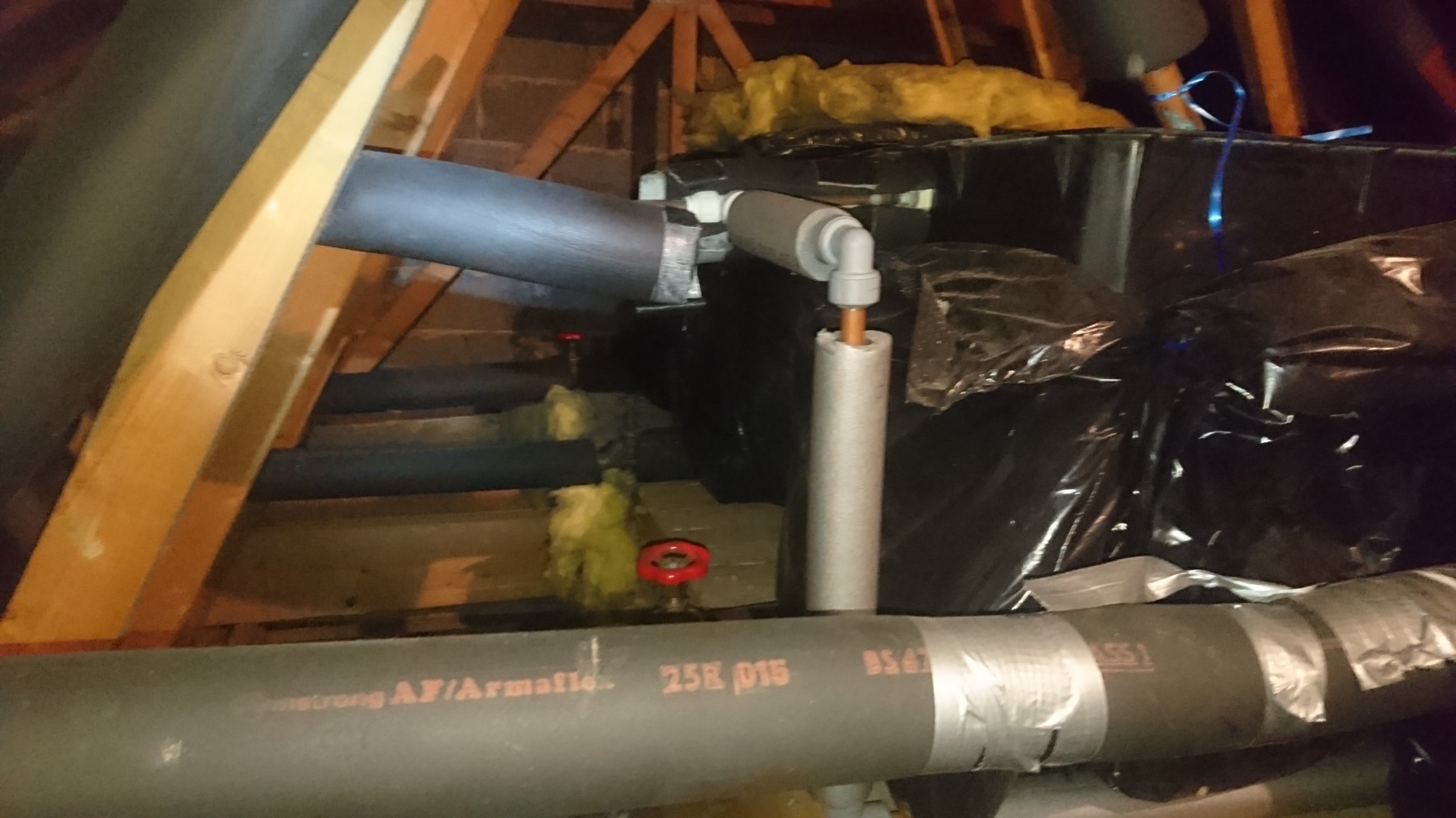

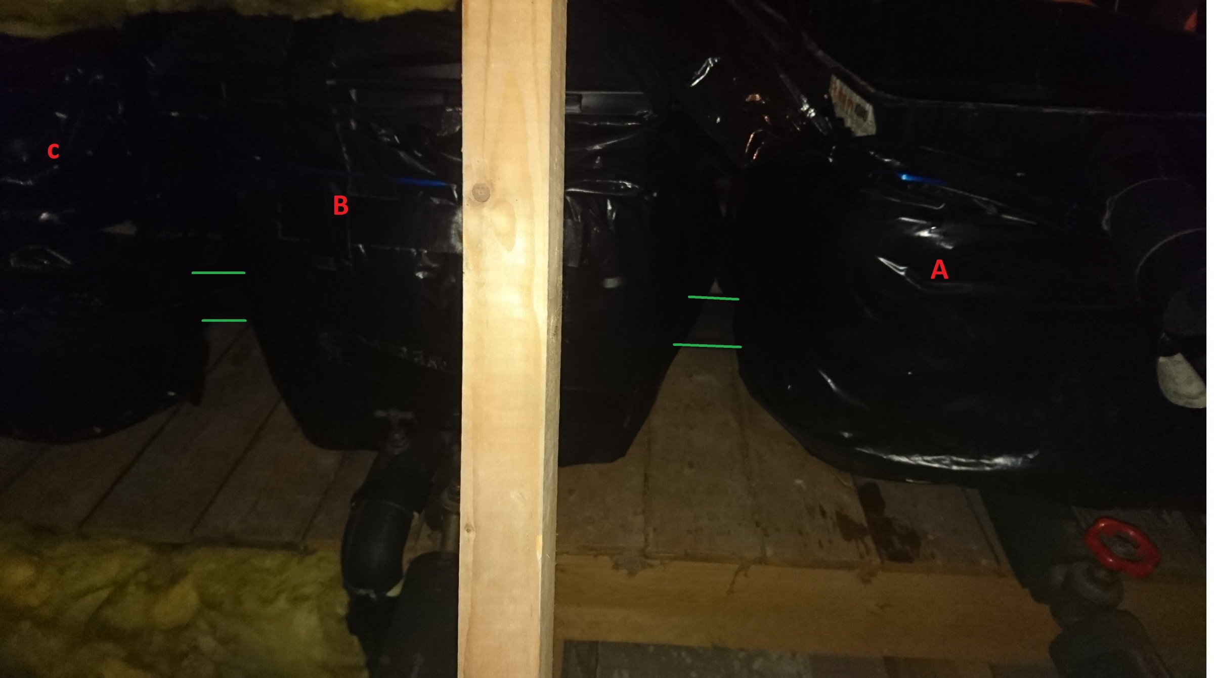

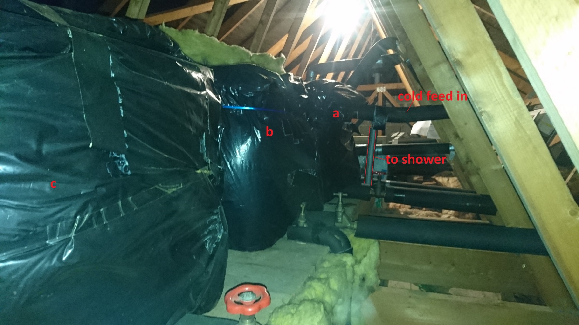

In the loft ive got one large tank with the inlet ball valve marked in as Tank A in my pic
This is connected to a further two tanks of the same size via a link pipe at the bottom( tanks B and C)..…

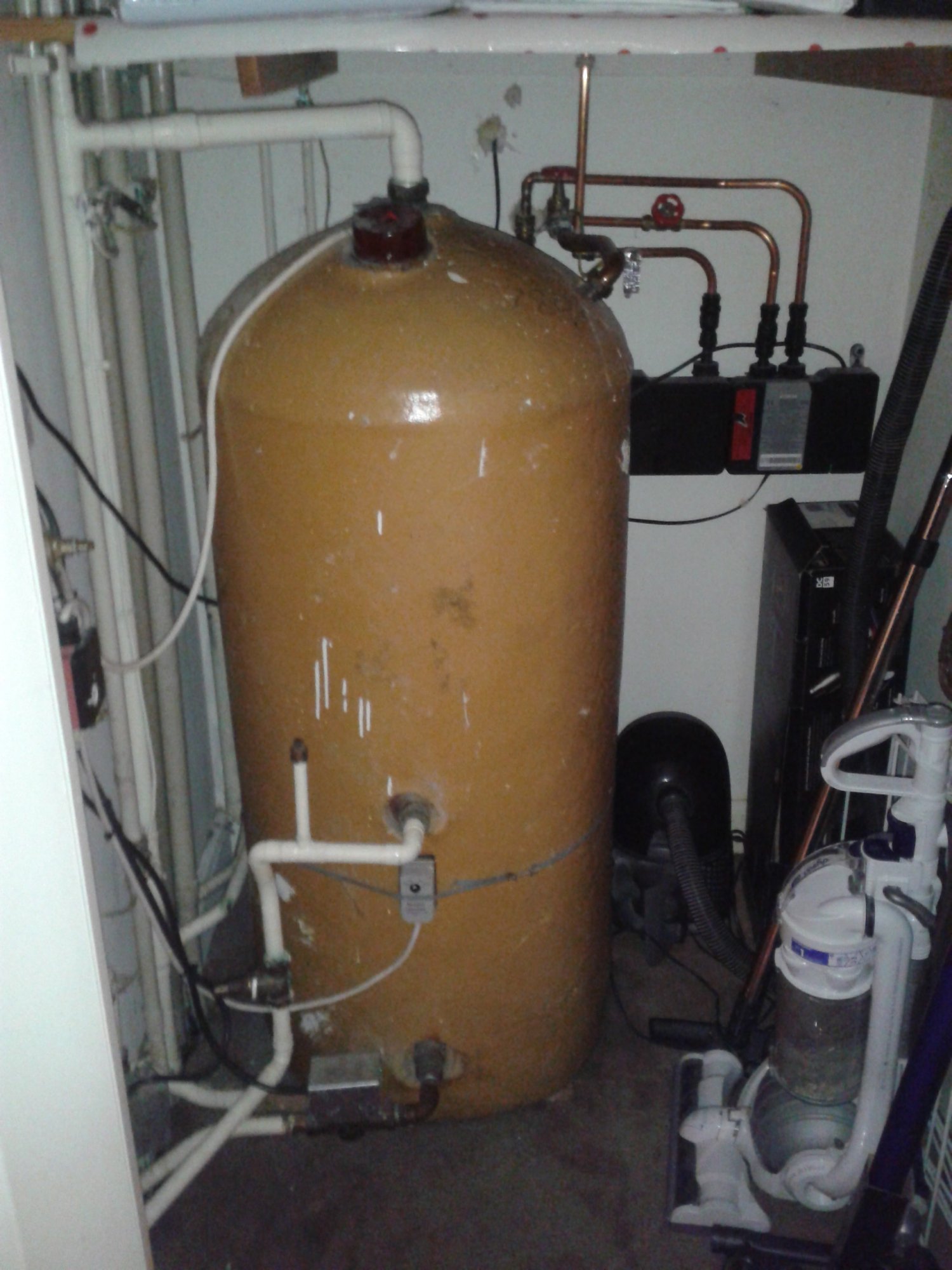

I think these serve as the supply for the hot water cylinder…..

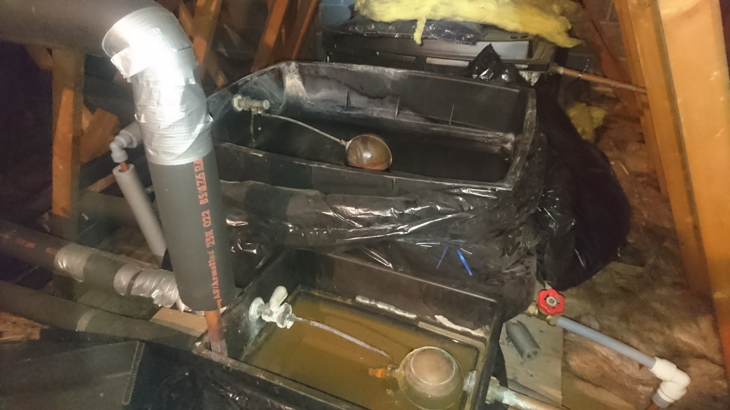

Then ive got the small feed tank for the CH at the forefront of the pic

You dont have a gravity system you have a fully pumped system, isolate the cold supply to the small F&E tank and then manually open the two zone valves (slide the lever across and lock it in the open position) make sure the electrical supply to your heating is off and open the drain down cock and start from the top opening the bleed valves on the radiators till the system is empty , refilling is the opposite

Looks like you've got an electric immersion element on the top of the hw cylinder. Turn this on to heat the water in cylinder whilst rest of system is out of action.
Also, before draining down, make sure the small (F&E) tank doesn't have debris in it. If it does, bail it out and clean before draining down, or all this crud will lodge in your pipework.

Yes, make sure hw and ch are turned off on the programmer before draining down. There should be a separate fused spur to switch on for immersion element. Follow the wire from the black cap of element on top of cylinder to the wall. Immersion will heat water instead of boiler whilst system drained down.
