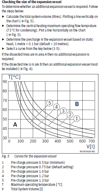

Why fit a sealed system with a system boiler? is the question.What are the pros for open vented in this case ?
Unless you are living in a flat, i can't see an obvious answer.
Considering this myself atm because of air in the system.1. You can have a sealed system on an open vented boiler, provided the boiler MI's says its OK. Most do.
2. On the sealed v. open vented debate, I prefer sealed. Because:
2.1 The only extra things to go wrong in the long run are the expansion vessel and pressure gauge. In my opinion this outweighs the chances of air causing corrosion if the inhibitor is not maintained.
2.2 You can get rid of the F&E tank, and its normal collection of nasty gunk waiting to be washed into the pipework.
