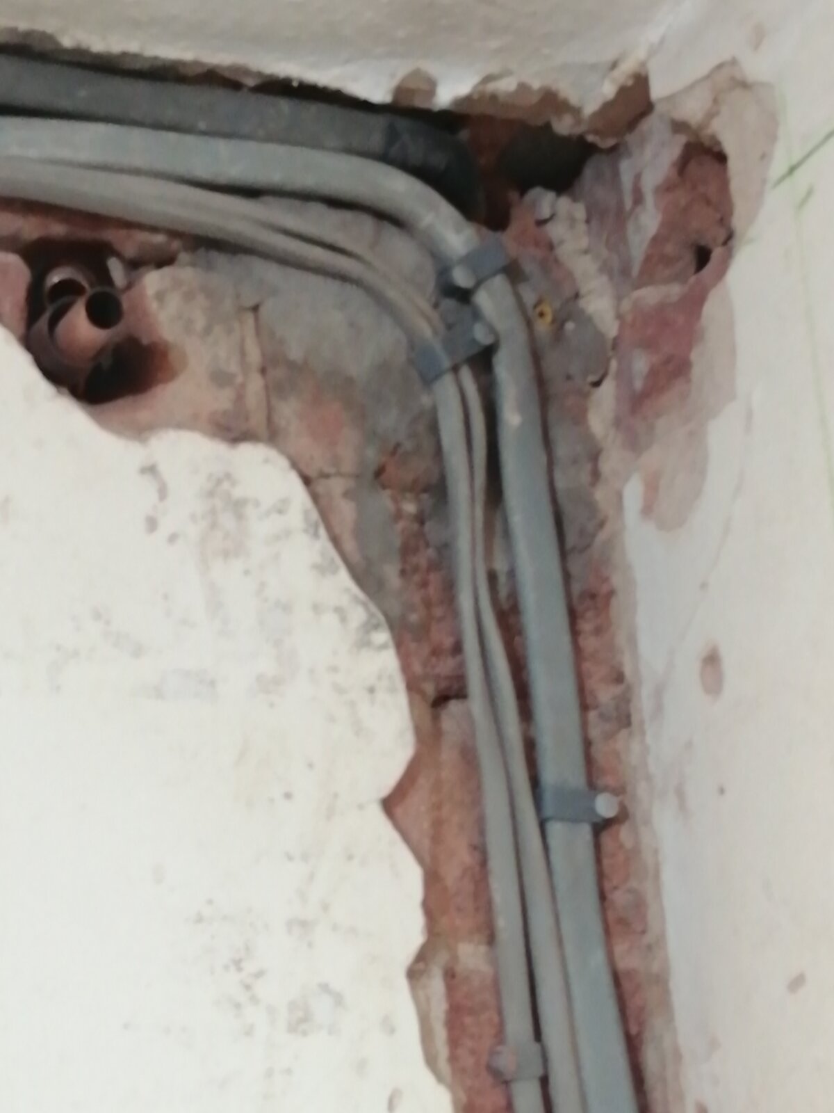

Been clipping cables against
on the chase but the cables were done in such a manner that they cross each other leaving a problem on a corner where the cables wont lay flat
Question> How bad is this if I just plaster over them
(on the photo the clip used will be changed to the appropriate sized cable clip)
I think as long as the cables are in a safe zone, clipped as per their radius, are not stressed, kinked or damaged and are below the surface of the plaster, I can't see an issue.
