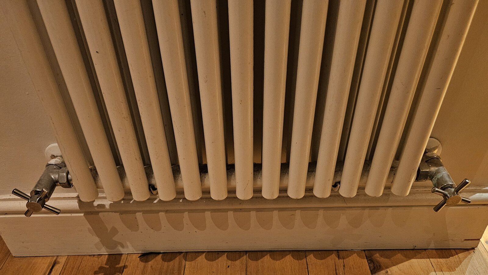

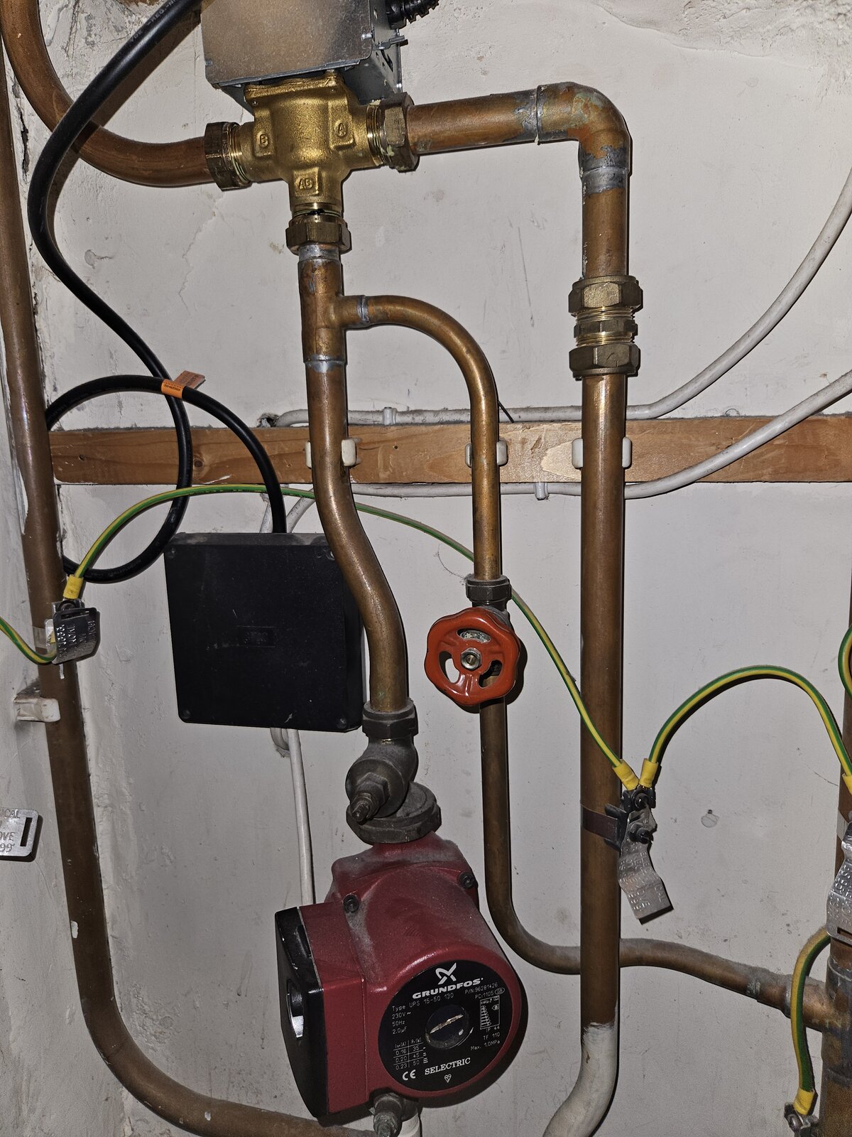

Hi All
I've just bought some Tado smart radiator thermostats (awaiting delivery).
I've checked all the radiators and they're all TRV's (including towel radiator), expect one, which has two manual valves. I am assuming this is perhaps a bypass radiator, however, my impression was generally these were fixed valves with two lockshields that you couldn't turn off, which isn't the case with this one, as you can.
The issue is, this is the main and large vertical radiator for the living room, therefore, ideally this is one I'd want a Tado Smart Radiator Thermoatat on.
1). Would I be right in thinking that if I wanted one on here, I'd need to switch one of the other radiators (in a less important area) to a manual valve to act as the bypass radiator?
2). Does bypass radiator have to be completely open / on the max heat setting, or could I turn it down low, to save costs if it does have to act as the bypass?
3). I don't know if I have a bypass valve, unfortunately. The boiler is a conventional boiler (Potterton 50EL), therefore, I can't imagine it has one built in like many modern combi ones do. I've checked by the fortic tank and can see what appears to be a gate valve. I'm not sure if this can act as a crude version of a bypass.
I've attached pictures of the gate valve and the manual valve radiator.
Any advice would be much appreciated this!

You do seem to have a manual bypass (red gate valve) and an old constant speed pump.
Therefore you don't need any rads to be locked open and can fit TRVs on all of them.
Yours was how my system was before i went down the CH rabbit hole.
Because you have a manual bypass and a CS pump, you could fit a ABV on the elbow. Which would improve things a little (better boiler performance etc).
If you ever change the pump. You'll have to do a few adjustments to take advantage of the PP mode energy savings.
Which would be going back to the manual valve bypass and adding a tacosetter device (flow meter) after it.
But for now you are ok.
You need to have the bypass open just enough to satisfy boiler flow through. It's a gate valve though and are ****e for setting flow. Perhaps open it up by 1/2 turn and see how you go.
The best way would be probably to fit the tacosetter inline with it but if you are not diy competant just do what plumbers do and guess (or leave it as it is!)

Thanks for this - I had seen some videos in which people had left the gate valve open a half turn to satisfy the boiler and was hoping that this might be the case here.
Looking at the manuals left by this area, it appears I have a Honeywell V4073A Motorised Mid-Position Valve. By the boiler in the kitchen, there was a manual for a ZV range 2-port spring return motorised zone valve with an auxiliary switch.
I suppose my only issue now is working out whether it is open enough... it seems rather stiff! I'm assuming the way round this is to simply loosen it enough, totally tighten it, then untighten it a half turn...?
But essentially, should the valve be in the correct position, I can put TRV's on all valves in the house without needing to worry about a bypass, and that getting an automatic bypass valve isn't needed per se, but would be good to have generally?

Yea, correct.
If the bypass isn't open enough, the boiler will trip. Just open it a little more, reset the boiler and so on and so forth.
Only a DIYer
The 'other valve' is the lockshield
Opening the TRV fully will make sure it doesn't close and stop flow.
If you have a look at balancing, it will probably explain the flow better.
