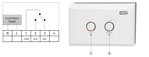

I assume the old ESI receiver looked like this:
SOLUTION 1
If you didn't have a two channel programmer, then the Tado simply replaces the ESI receiver. The wires are moved from the ESI terminals to the Tado terminals that have the same function.
ESI N to Tado N
ESI L to Tado L
ESI COM to Tado COM
ESI NO to Tado NO
Make sure the Tado jumper is in Position 1
SOLUTION 2
If you did replace a two channel programmer with the Tado, then the old room thermostat receiver needs to be decommissioned properly and a small wiring modification made to complete the circuit, it can't just be removed otherwise the wiring will be open circuit and the heating won't operate.
Then the wires that were in '1 COM' and '2 N/O' should be joined together to complete the circuit. This can be done at the receiver end, or preferably at the origin of the cable, then the receiver cable can be removed completely.

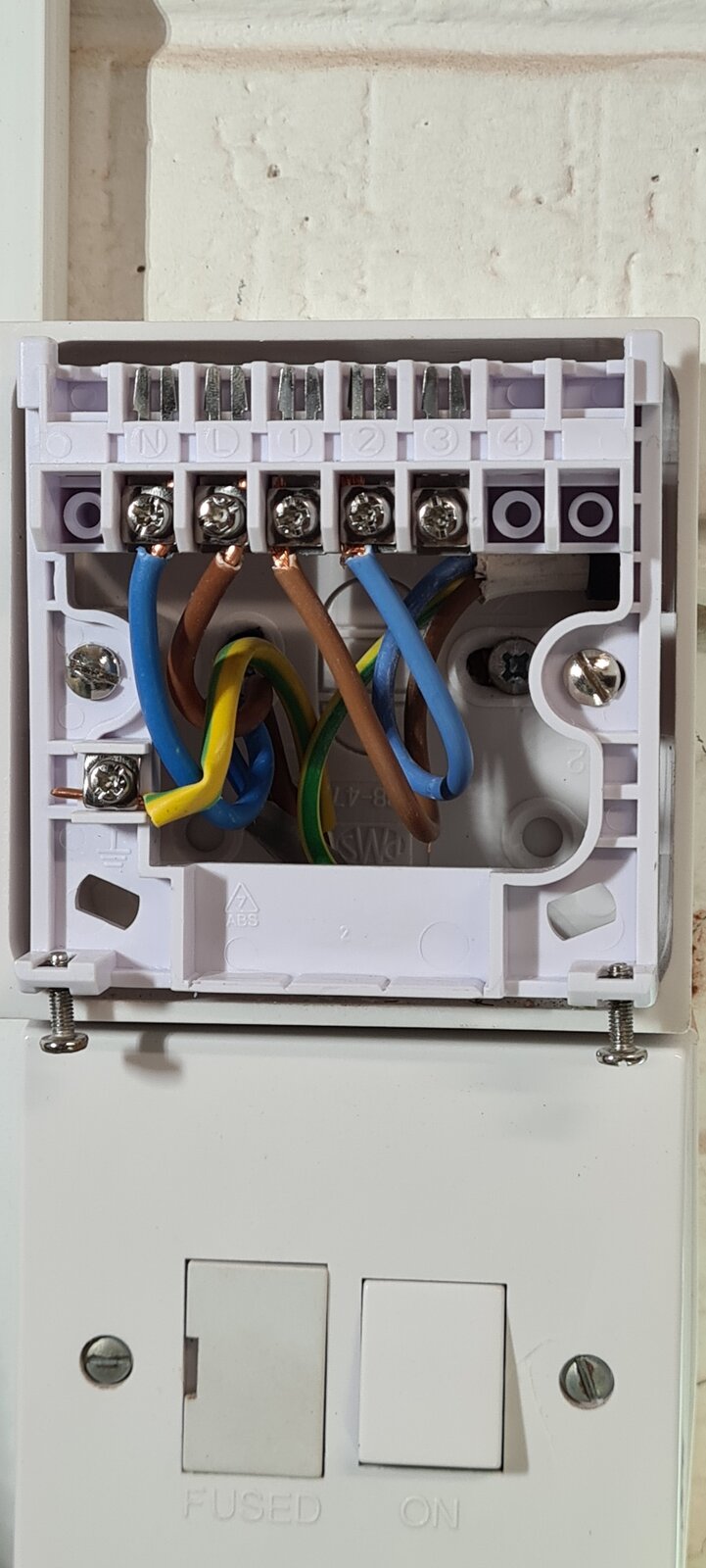

I have these pictures of the original wiring
Pic1 1 : Is how the ESI receiver was wired

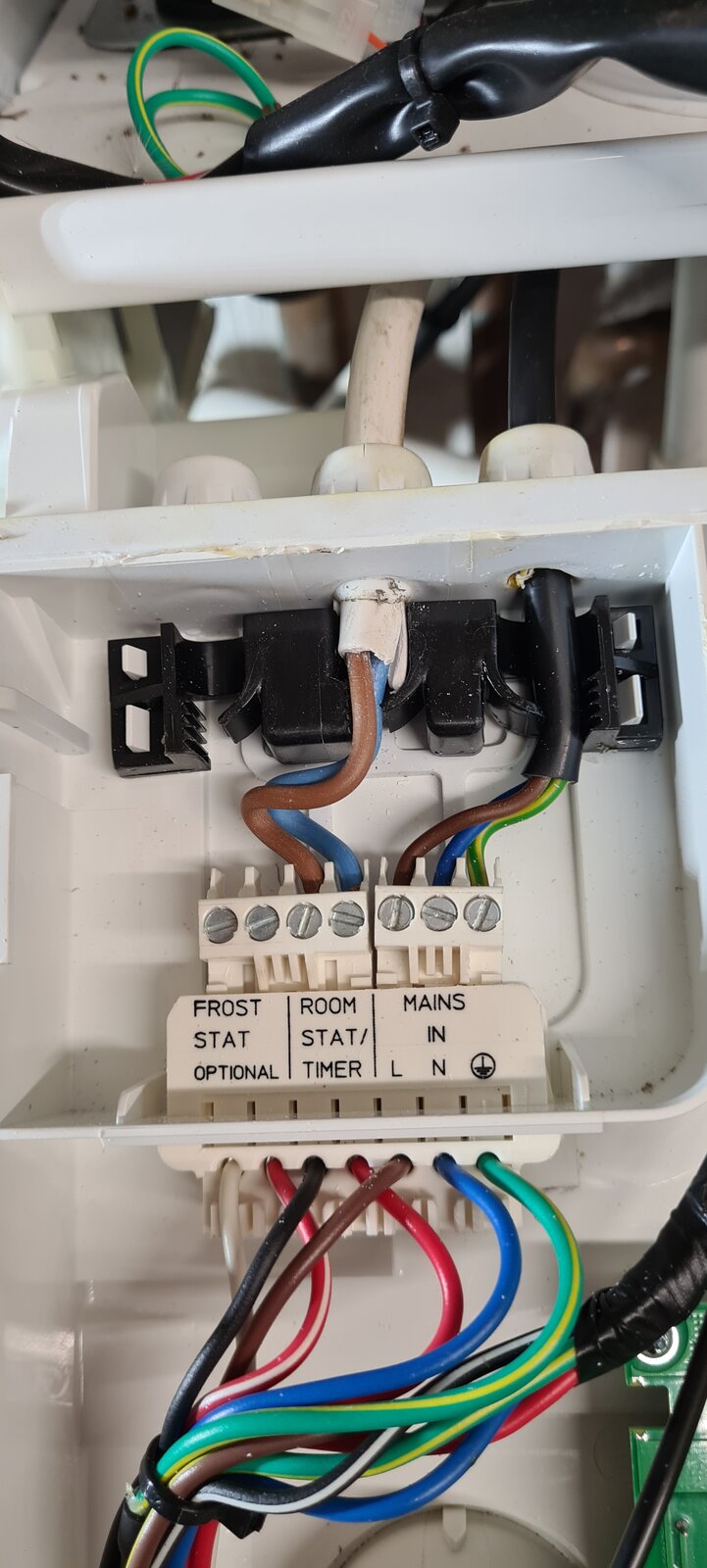

Pic 2 : This is how the boiler was wired

Where the blue wire goes into the Room Stat / Timer block, I have one wire now that goes from there to terminal 4 on the TADO extension box.
Hopefully I have explained that well?
