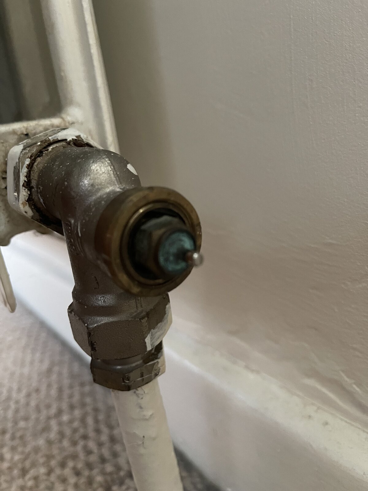

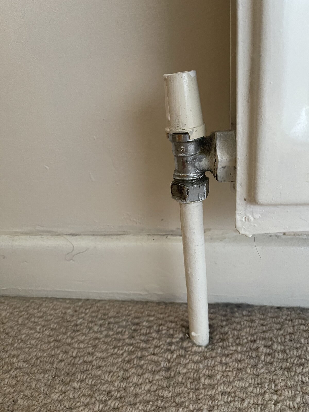

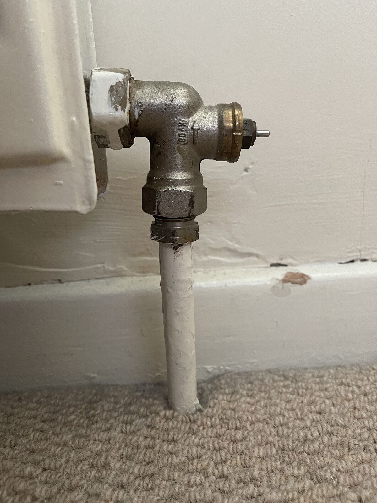

Hi,
Considering buying the Tado Smart Thermostat and valves. However I'm not sure if my upstairs radiators will be compatible with the valves. Has anyone had any experience of installing Tado Smart Valves. Do you know how to determine if they'll fit?

Those aren’t compatible, you’d need to upgrade to normal TRV’s with threads and then the Tado heads.

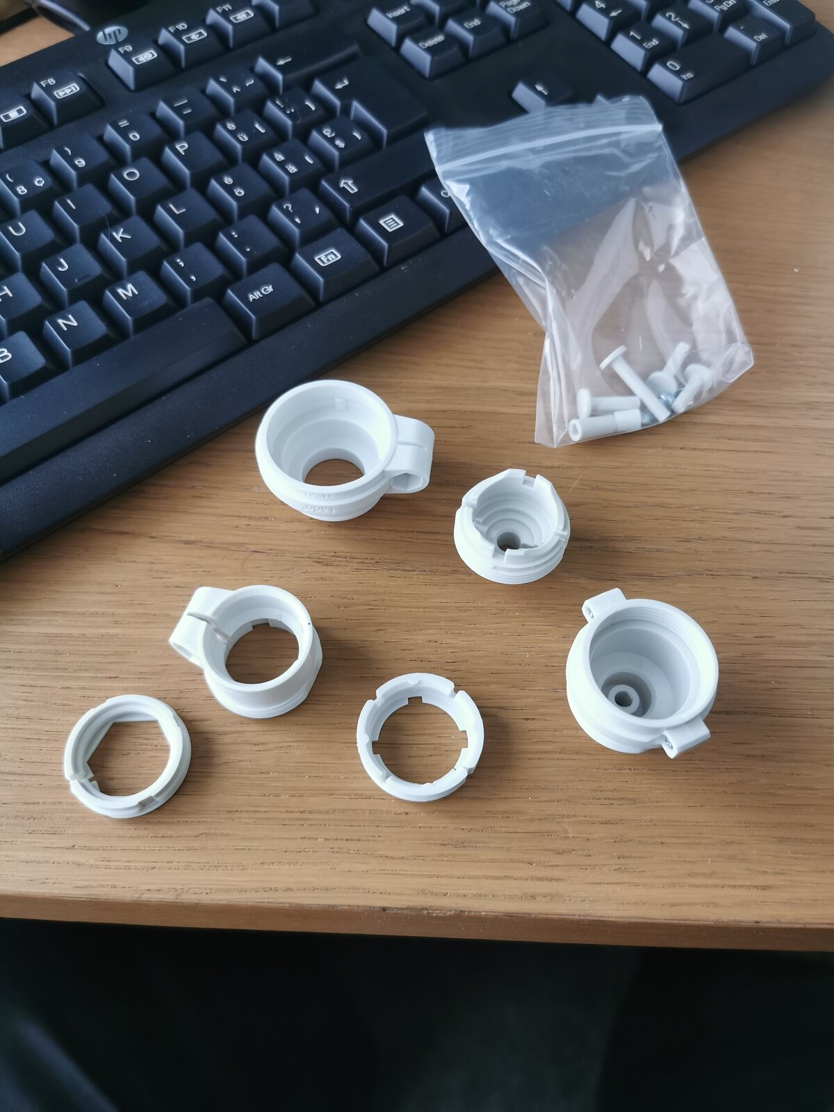

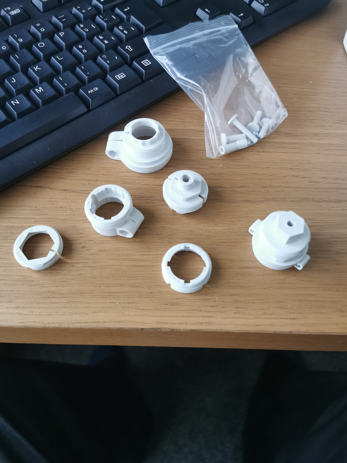

Those are the adapters you get with the tado trv, hopefully someone can advise if there's a suitable one there.

Got DANFOSS RAS-D² ANGLED THERMOSTATIC TRV & LOCKSHIELD 10/15MM X 1/2
