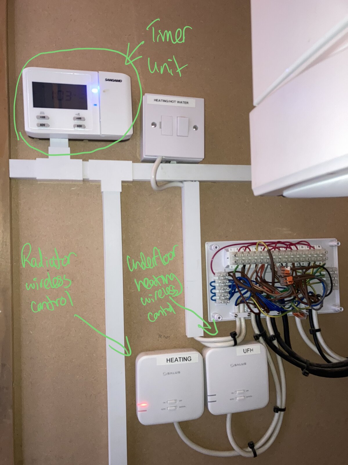

One of my first priorities is to install a smart thermostat system. I currently have a system boiler (Main Eco Elite 24) along with an unvented hot water cylinder. There are two heating loops - one for radiators, and another for underfloor heating in the kitchen / diner. This is the current controller setup:
It appears a conventional timer unit is controlling heating and hot water separately, but downstream of that, the heating is then further gated behind two wireless controlleres - one for the radiators, and one for the underfloor heating.
My first preference is to replace all of this with a Tado based system, however, their support team haven't filled me with confidence that it will be compatible, as they don't seem to understand my setup. As far as I can tell, Tado recommends:

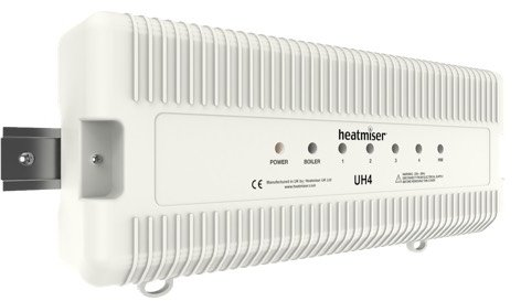

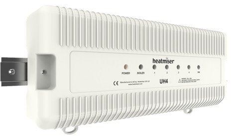

UFH tends to use relay boxes like this 1671340038783.pngto integrate the two systems, the idea is the water in the UFH circulates, and as the water cools it is topped up with new heated water, as aim is to keep the UFH to 27°C but the radiators are at 60 - 70°C depending how set up.

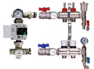

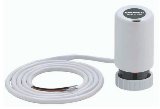

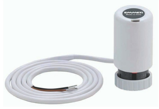

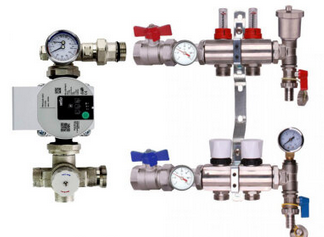

UFH normally has a set up something like this 1671341218151.pngshowing circulation pump and valves, you can replace the heads with some thing like this 1671341399053.pngallowing control of each section, but there are so many small variations on how UFH is set up, it gets hard to follow all the options, I have seen where a standard radiator has a standard TRV head and the return from the radiator goes into the UFH idea is the radiator cools the water enough, but it is rather a Heath Robinson set-up.

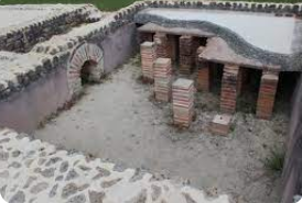

The controls for central heating can cost £1000, but in the main we use near enough engineering and reduce the cost, we have had UFH for a long time, 1671341861261.png but the Hypocaust fell out of favour when the Romans left, but the limitations of the heat pump has caused a return to the system, as the circulating water only needs to be 30°C, but this only really works if whole system runs at 30°C, if you want DHW you need 60°C so the heat pump ends up heating the water up to that anyway.
