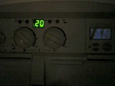

I have recently had a Tado smart thermostat installed and it is working fine with controlling the heating via my phone and smart thermostat with my boiler. One niggle though is in order for Tado to control the heating the boiler must be constantly on. With this boiler if I use the constant on setting it resets at Midnight to Automatic thus disabling the smart control and I need to put it back to constant on in the morning to have Tado the primary controller again.
Any thoughts on how I can disable this feature or override it? Many thanks
Get a pic of the boiler with front panel down. Is it the one with the 4 yellow buttons on the right hand side? If so you can't fit alternate external controls afaik
Hi, I have attached a pick of the Panel. Strange thing though. This morning I tested the heating using the Tado control and it worked perfectly. Even though it has defaulted back from Constant On to Automatic Setting. Perhaps you just need to let the Tado take over the heating control once and then it becomes the primary controller. As I say I set the timer for my heating using my phone this morning and also switched it on and off manually?

Cgas... as for the external control not working with the boiler this is what Worcester Bosch advised but the Tado does control it. I think possibly it is their own controller Wave which is not compatible. As I say Tado is working you just have to make sure it is constant on but my experiment this morning may even have disproved that as it was working from the automatic setting. I'll investigate over the course of the week.

Every one of these boilers that I have encountered where "someone" has tried to fit external controls has had some kind of issue, usually its the pump that runs constantly or the the timings are erratic, WB say no other external controls can be used other than their tr2 (unless you tupperware it) chances are you will have constant problems but if you can live with the heating being erratic go for it.(y)

As per my first comment alternate external controls just causes issues with the smart controller (with the yellow buttons) and that can't be removed
