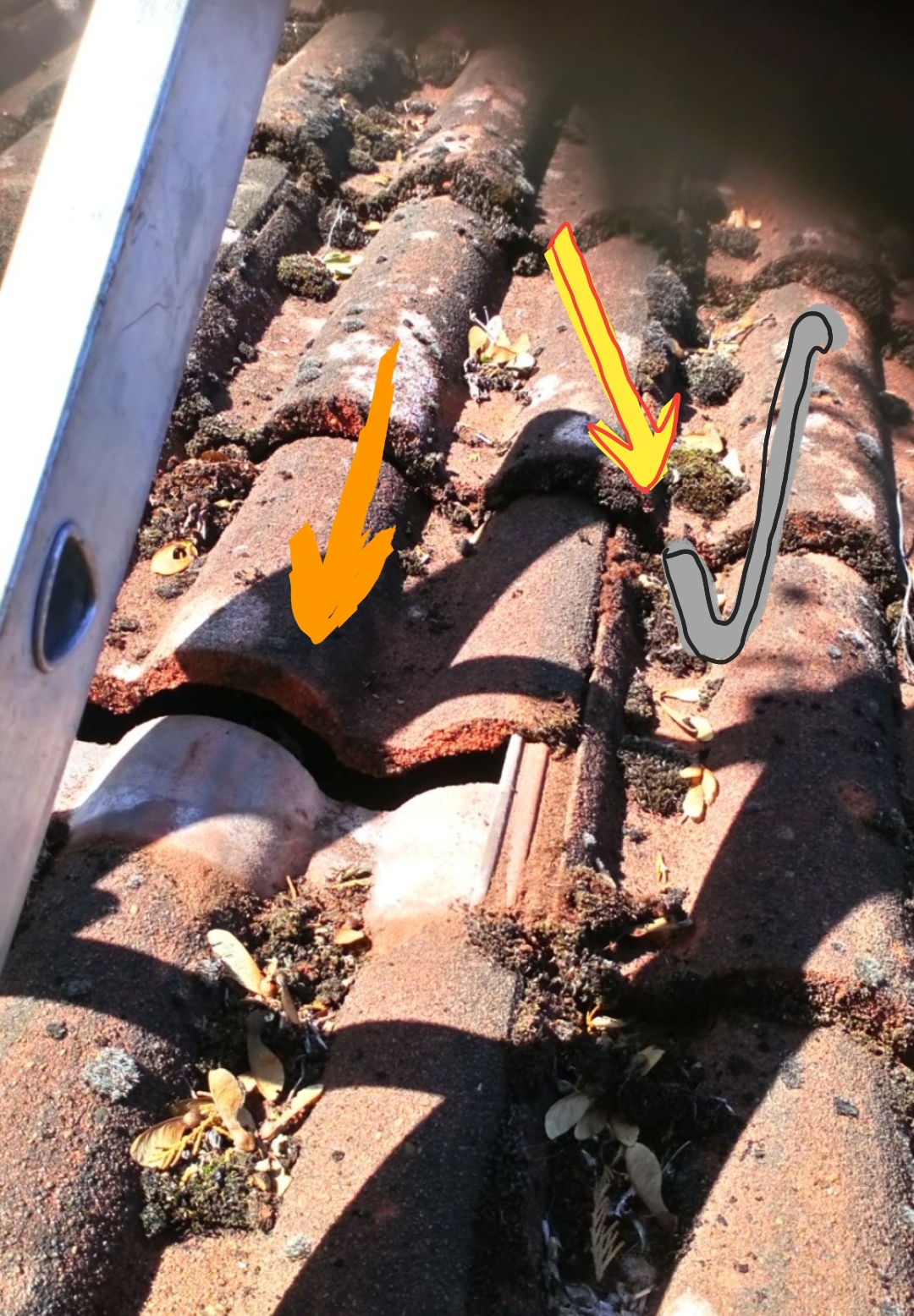

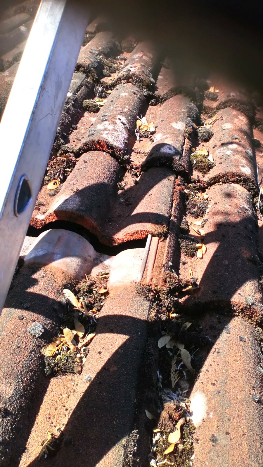

I pushed the second row up (as in pix) but lower one's wouldn't budge. Also when I tried to pull the two from second row back down they didn't come all the way down, overlapped but an inch short of other tiles Is that a problem?

I pushed the second row up (as in pix) but lower one's wouldn't budge. Also when I tried to pull the two from second row back down they didn't come all the way down, overlapped but an inch short of other tiles Is that a problem? View attachment 148860
Put a crowbar or something under the row above and the tile to the side and lever that up, which lifts the tile above up and frees the tile to be slid down.
Thxs. You're referring to getting the tile down, aren't you ? If left in current state it shouldn't cause any serious problems should it, I won't be able to get to those tiles for a few weeks.
As far as getting bottom tile up near gutters, do I just force it up? Pull it hard. Or was your diagram referring to that?
