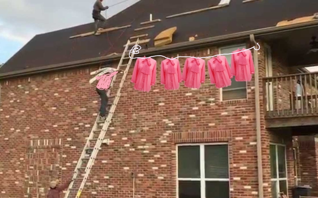

I noticed this chap in Belfast last week. Obviously, the super secure ladder tie will also support his work shirts in the next hurricane that passes by.
But I think it's his very first job. Bless.
looks like thats a bit of 25 x 50 snapped up there......is that ladder on its way down too?

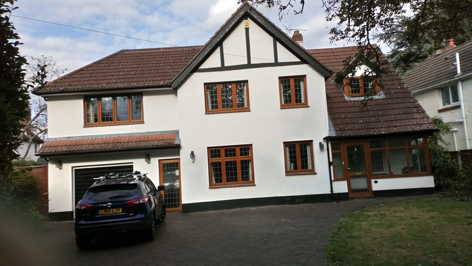

I basically asked this for general access and ladder safety in general but was enthused to ask it from having to paint on this house. A roofer chap said he will help me tie some scaffold planks from a mitower to roof below window on right hand side. Will use mitower for rest of house too
Was sent these. Look a bit diy to me though. I saw a mitower other day and it looks more solid. Any opinions

Yeah I thought those scaffolds look dodgy. I think rent a mitower is the answer. Rope on harness when walking on roof.
